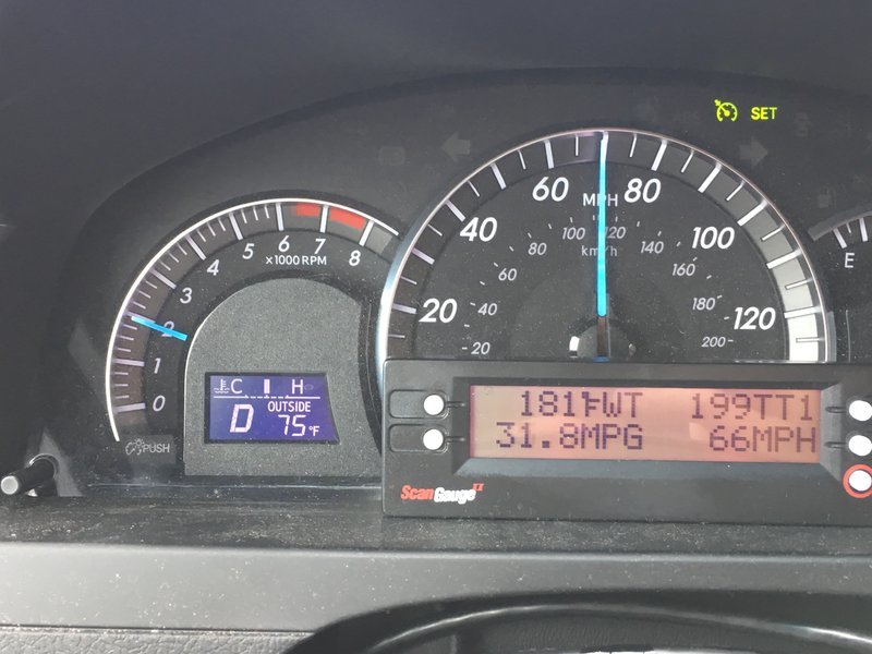

    Yep, scan gauge shows water temps between 175-184 on the freeway. I just drive up to Sante Fe in 75 degree weather, the water temp stayed around 180 and the trans temp was between 200-205. It's a 2014 Camry with 35,000 miles.

  11. Sep 22, 2016 at 12:29 PM
    sjcornett
    sjcornett [OP] Member
    Sep 18, 2016
    #197621
    7
    2010 Tacoma TRD Sport 4X4 w/Tow Package
