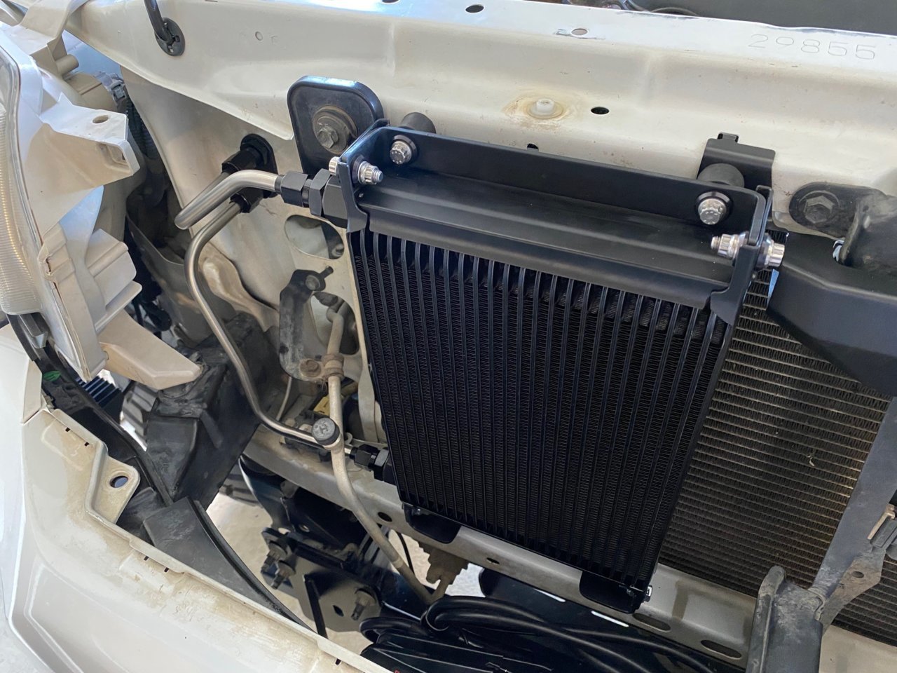

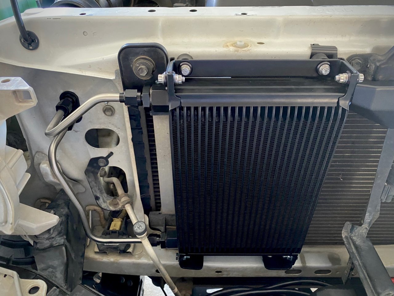

    I've noticed a 20-30 degree drop in temps after the 4454 Tru-Cool install. I just bought the OEM engine oil cooler kit and plan on installing that myself here very soon. Should be relatively easy.
