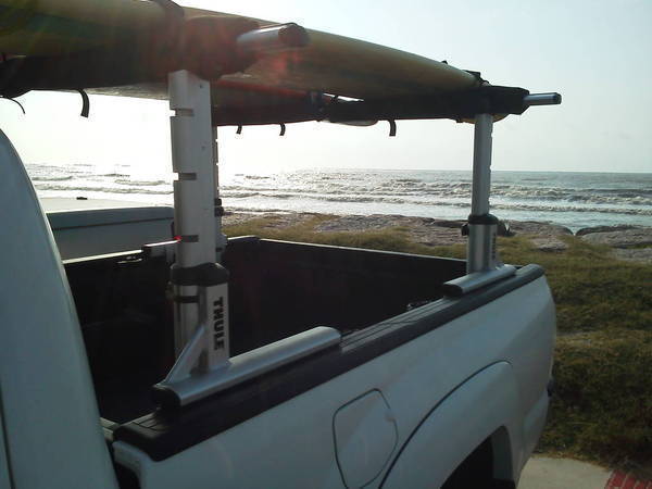

    Double post so double post................
    Sure, here's the expensive option........Thule XT422
    but there are cheaper options like the goal post thing that goes into the receiver hitch. Buncha options in this thread............

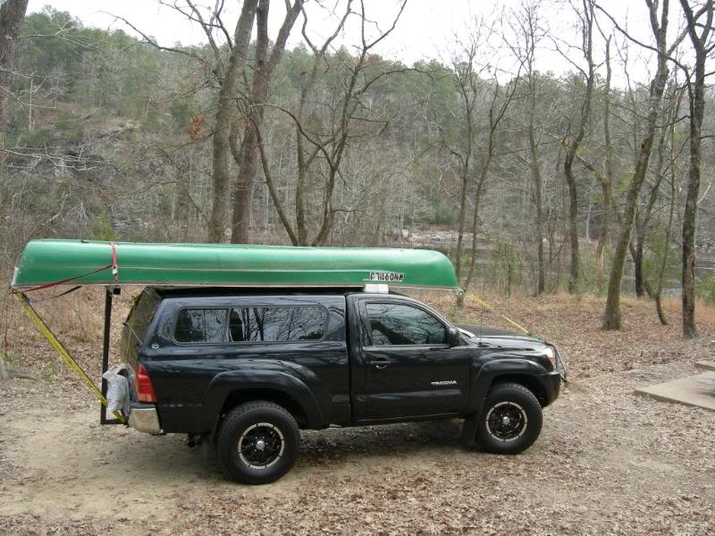

    I had an nfab prerunner light bar that I used as the front tie down point.
    The styrofoam feet were on top of the cab and the hitch extender came from harbor freight.
    This set up worked great with a 20-30mph cross wind.

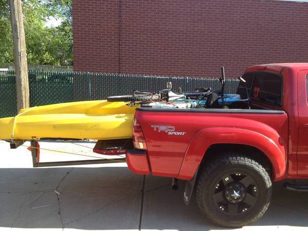

    harbor freight..like 50 bucks.
    my 12 foot yak
    dads 14 foot yak

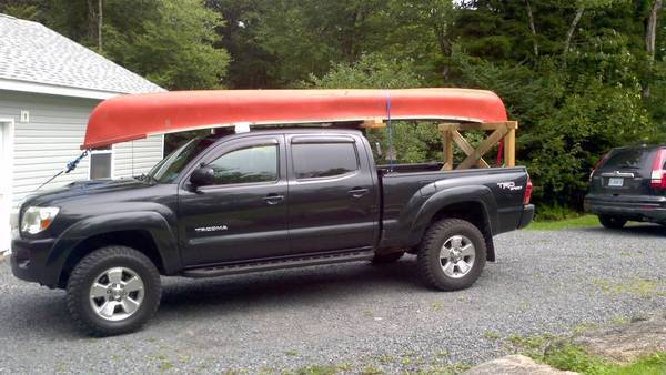

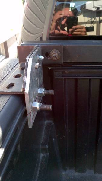

    Here's a couple of pics of my homemade rack. I bought a back rack for $100 on kijiji. It was originally on a dakota and was attached by drilling holes in the bedrails. I called a local distributor to price the proper brackets for the Taco but they wanted another $100. Instead, I welded some threaded rod to a piece of metal I cut large enough to fit in the tiedown channel. Then I fabricated plate to fasten the back rack. The end result is similar to the manufactured bracket, but ALOT cheaper. THen I notched a 2x8 for the top of the back rack to raise the canoe higher than my cab. I then built a rack for the back of the box out of left over fence material (4x4's, 2x4's and fence boards). A couple of foam blocks and some straps and I was all set. Drove 5 + hours on the highway, (110km/h) and it held up great.
