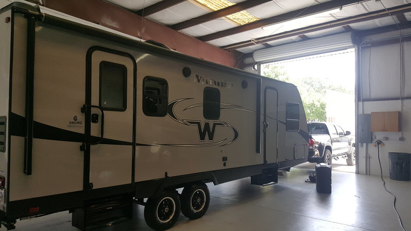

    Mine tows just fine. 2401rg Minnie Winnebago, 5.2k dry. OR 4D DC, Icon 3 inch suspension with reservoirs, no blocks. I tow obviously with an 800lb weight distribution and sway control. Also have P3 brake controller. Truck and trailer combo is awesome.

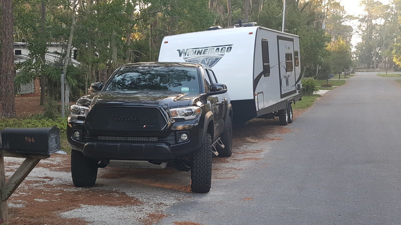

    Better pics, and no new thread started lol.. It's great to share common interests.

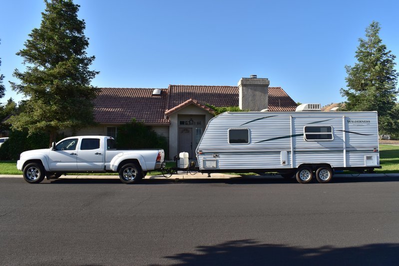

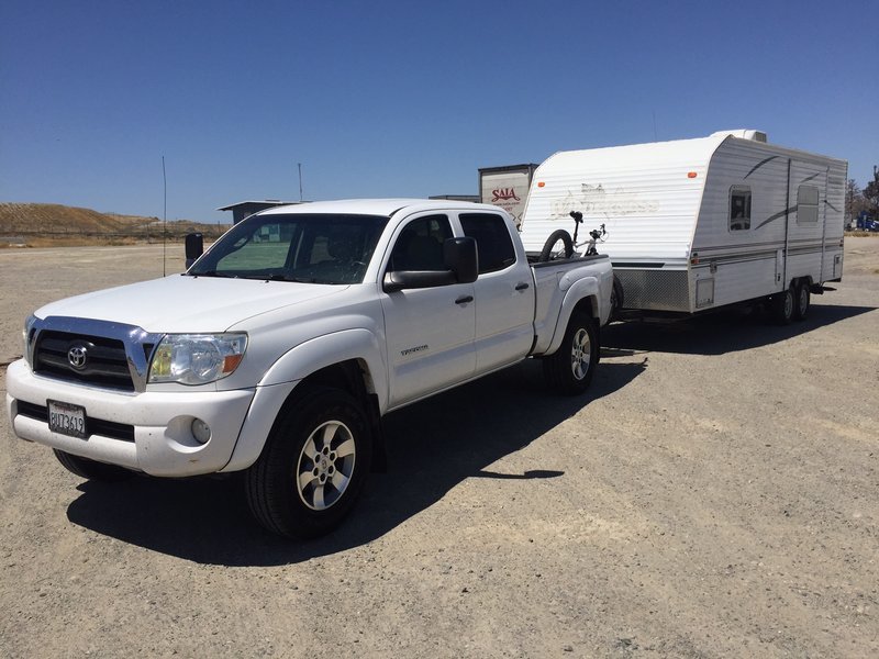

    I tow my dad's 25' Fleetwood, 4,600lb dry. WD hitch, P3 brake controller, Hellwig air bags. I use a Scangauge II to monitor my Trans temp. It pulls well, just gotta take it easy on the hills. I just keep the water tanks empty most of the time to help keep things as light as possible.

    I worked on my WD hitch setup. I didn't have enough lift from the trunnion bars because my hitch head angle wasn't right. Now, I hardly need any air in my air bags and it steers much better.
