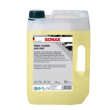

    On another note cleaning, I do have this expensive caustic cleaner designed for BMW painted wheels. its so strong it melts vinyl gloves! Stings and burns the eyes and skin if you aren't extra careful! Have to brush it on, spray bottles disintegrate because of the viscosity and chemical action eating the pump. It claims to be "acid free" but doesn't claim to be "alkaline free" it reacts to the break dust (dust is acidic I believe) and really works! no scrubbing required, just hose it off!
    https://www.walmart.com/ip/SONAX-23...MI4v647pjt3QIVSo1-Ch2LRw7eEAQYBCABEgL-dPD_BwE
