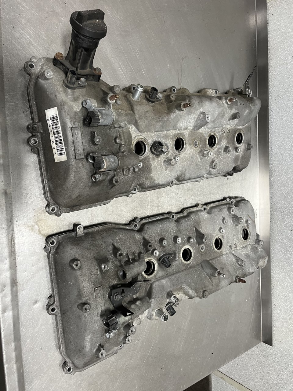

    Anyone know someone with a tundra? I got some valve covers looking to get rid of. Fit the 5.7. Make an offer. C19C70B9-1ED3-43B7-8A78-313A2CFC1F31.jpg

    That's very tempting...I have two more items to piece together for my fit kit. I may hit you up for them at a later date if you still have them

    Sounds good!

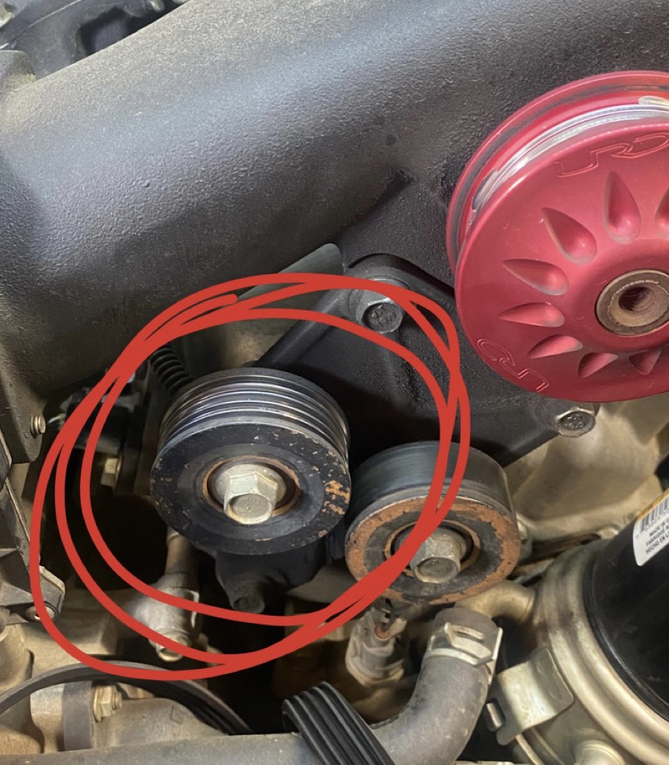

    Where can I buy this pulley? Anyone have a link?3F75B4FE-DFAA-47E3-8572-6D2CDA333C00.jpg

    Do you need a pulley or just a bearing?
    the bearing is a couple of bucks, the pulley is a couple hundo

    Just the bearing but I would like to replace the whole thing because it’s ugly lol. Any idea where I can buy just the bearing?

    I think the 1 page may have that information. Give it a check.

    Shoot me an offer an a pm.

    Personally, if there is nothing wrong with it, I would replace the bearing, mask the face of it which is exposed with some tape and then give it a nice sand down then a re- blast with a few layers of satin black spray paint and call it a day.
    Page 1 has the info you need but superchargersonline is your source of you insist on buying new, however.

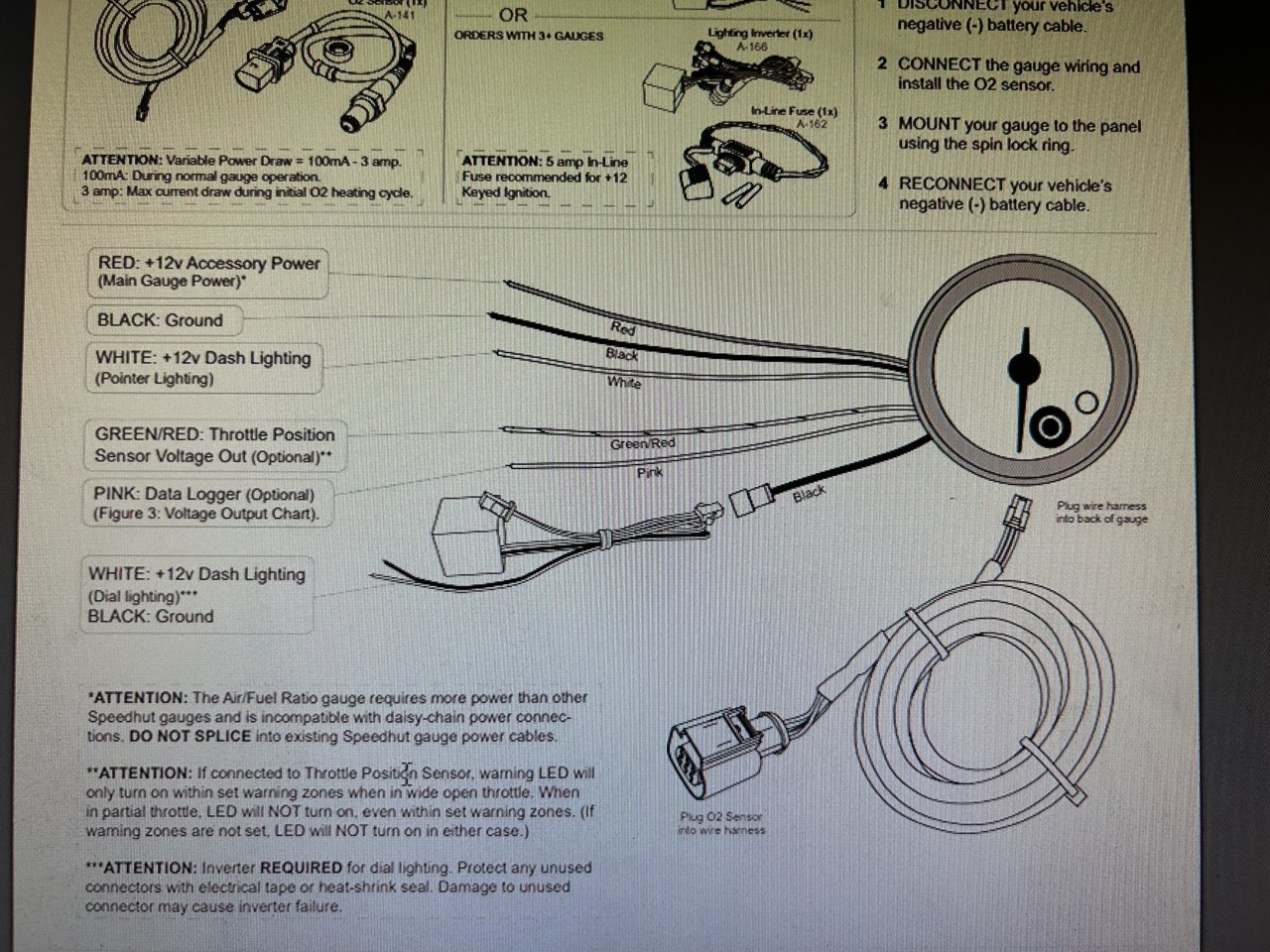

    Going to be wiring up my SpeedHut gauges soon - boost and afr
    According to install diagrams:
    52C2AE79-D20C-4162-B3E6-A0559BC04FCE.jpg200CCE19-3FD3-4EC7-B11E-B2EE6F92828B.jpg *my AFR also has a blue ground wire that says specifically to chassis ground and not T into the other black ground*
    • White goes to dash ignition lighting
    • Black goes to ground
    • Red goes to ignition
    • Blue ground to chassis specifically
    - I plan to use a single add a fuse with 5amp fuse for two red ignition wires for both gauges.
    - Ground for all four wires on both gauges will be put to a ring terminal that ground right by the kick panel ground bolt marked E.
    - I don’t plan on using the green TPS or pink output wires (yet…)
    My two questions are:
    1. Where do I tap into the dash lighting on the truck for the white wires?
    2) The blue ground on the AFR gauge says specifically to not T into the other ground wires, and go direct to chassis. I do not understand why - isn’t ground just ground?
    Can I just place it on its own ring terminal and ground it to the same both as the others?
    I will shoot Speedhut a message as well about the blue ground wire.

    Tap into the dash lighting by removing the steering column cover. The plug on the left side. I just can't recall what color the wire is.

    Could just run an add a fuse

    Might help

    I don’t think any interior fuses that receive voltage when headlights are on.. maybe the “tail” fuse, but I thought that one also had the EFI on it, so it’d be hot regardless of headlights on/off. I’ll double check.
    I’ll look into this if I can’t use another add a fuse !
    EDIT: just re-read your link @Lucario Runner and I’ll try the tail fuse inside the cab…
    sent an email to SpeedHut about the blue ground :/

    i used an add a fuse for mine. my gauges are always illuminated. i didnt tap into the dimmer switch tho and they dont dim. think i tapped into the gauge cluster for thte add a fuse
