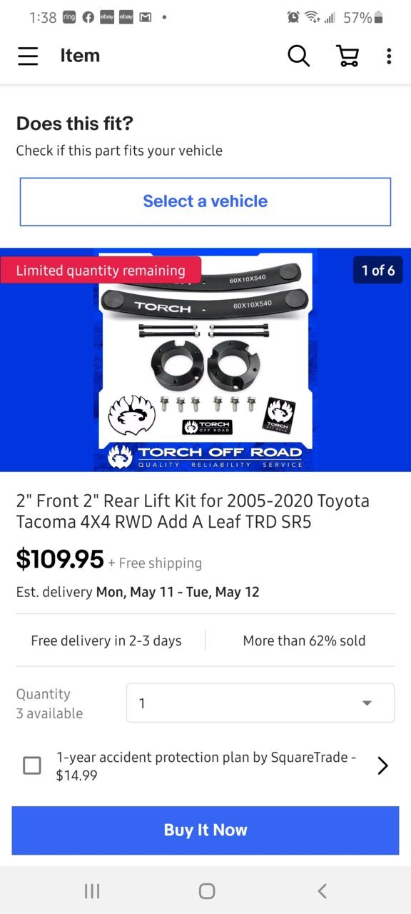

    Hello. I'm looking to give my truck a bit of a lift. I'm looking at this 2in lift from ebay. I don't do any crazy off roading. Only the occasional trails which are fairly easy. I want to know if anyone has gone with this type of lift and if they have had any issues. Also what's the biggest tire size you can put on with this lift. Tia!

    Welcome Carlos how can you spend over $30,000.00 on a nice truck and want to put $100.00 hockey pucks on it????? At least research other options like Bilstein 5100's all around using your existing front coils, and the AAL in the back.

    $1000 for a single leaf and spacers wtf, get something else like eibach shocks and springs preassembled with new components and a 3leaf AAL for the same price
    Read post wrong, my bad

    It's a $109.95

    I think you read OPs post wrong. It's $100... lol

    Lol, $100 lift? On a 35K-40K truck? Better off not lifting at all....

    Oh jeez my bad. Lol I was about to say wtf

    5100’s all around set at your desired height. AAL OR progressive aal in rear. Great budget lift. Stiffer ride but for the better. Eibach has a great kit as well.
