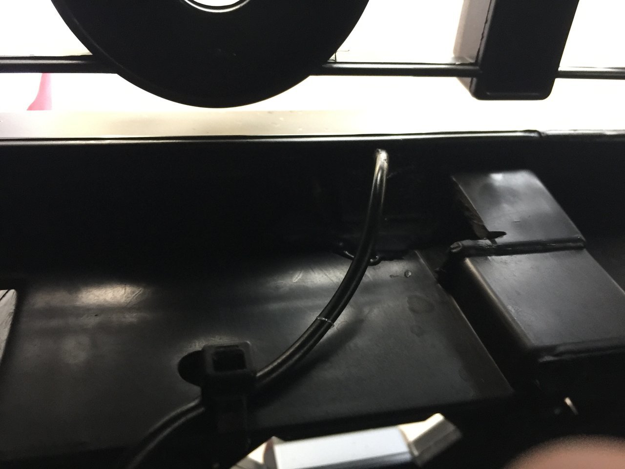

    curious how you installed it to the grille?
    pics?

    I used hot glue to mount the camera to the grill. Here is a picture from the back. It’s a little dark so hopefully you can see it. It just started raining so I had to do it quick.
    D7A0450F-9FD2-4678-8FA2-4C4A76F69322.jpg 34B2652D-1F0C-40F7-B496-9AC60AE37DD2.jpg
