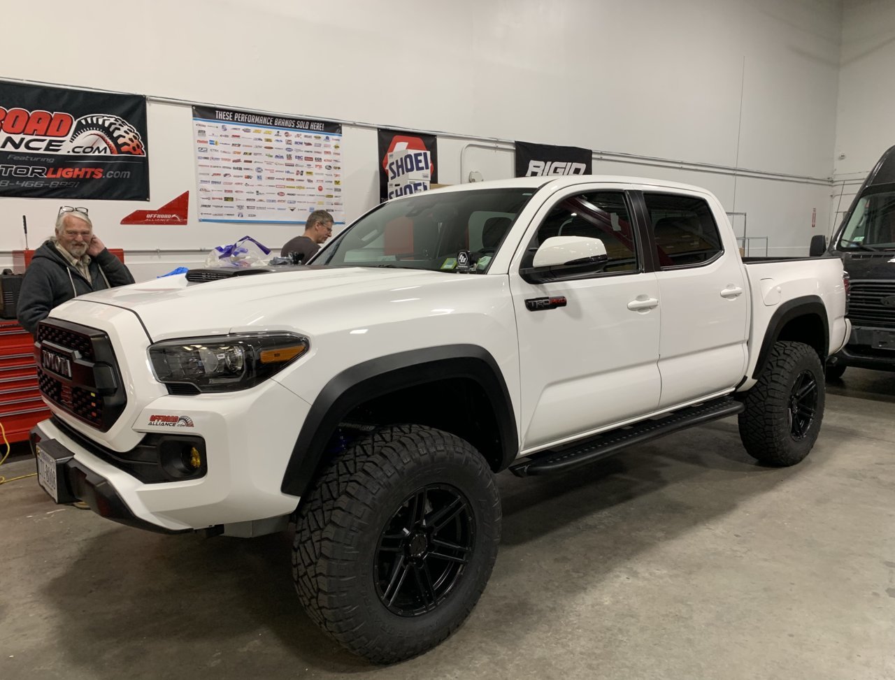

    2018 Pro. Installed King 2.5 front and rear, Camburg UCA, and a set of springs out back. Was able to run 285-70-17, but did have to do the cab mount chop to fit them.
