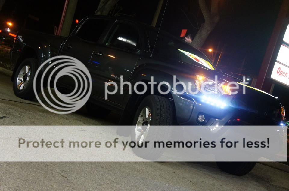

    -HID Headlights 10k H4 High & Low Flex Bi Xenon Digital Conversion Kit Headlight brand: Sportiva Mortors
    -HIDs 10k BUMPER FOG LIGHTs Xenon Kit Bumper Headlight Brand Motor Energy Auto Parts Modded to run anytime

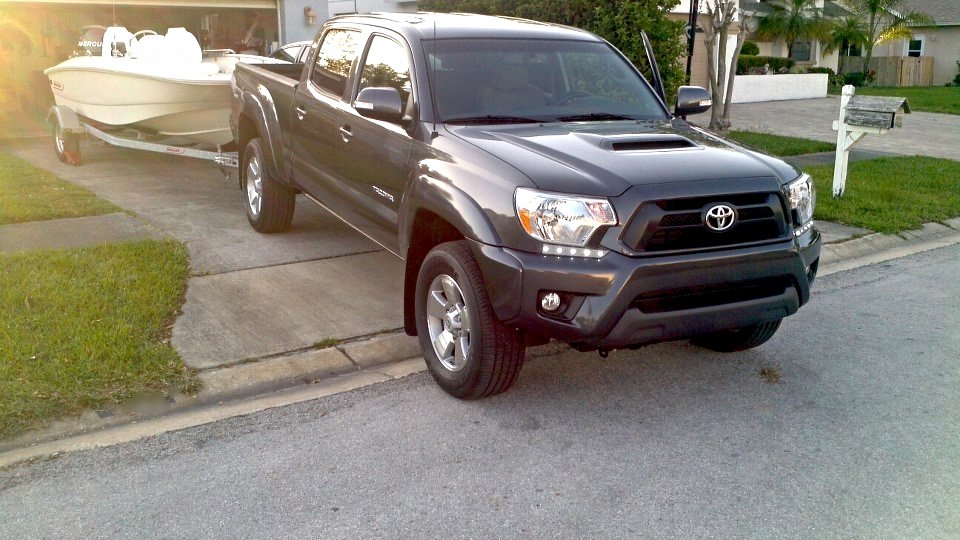

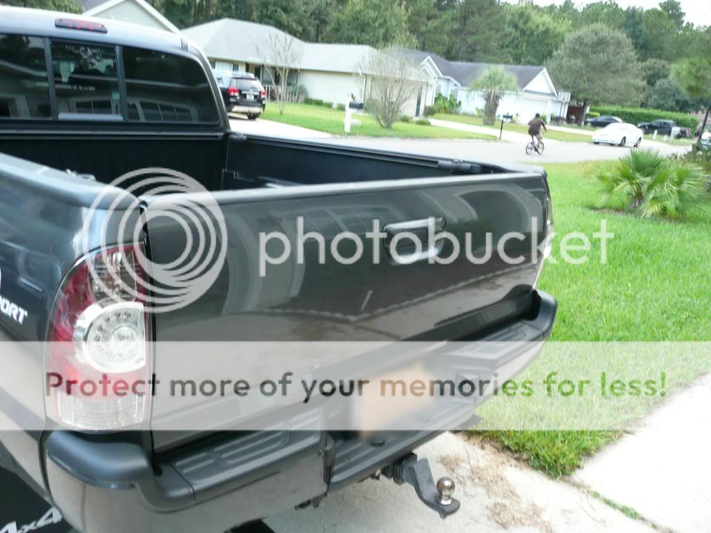

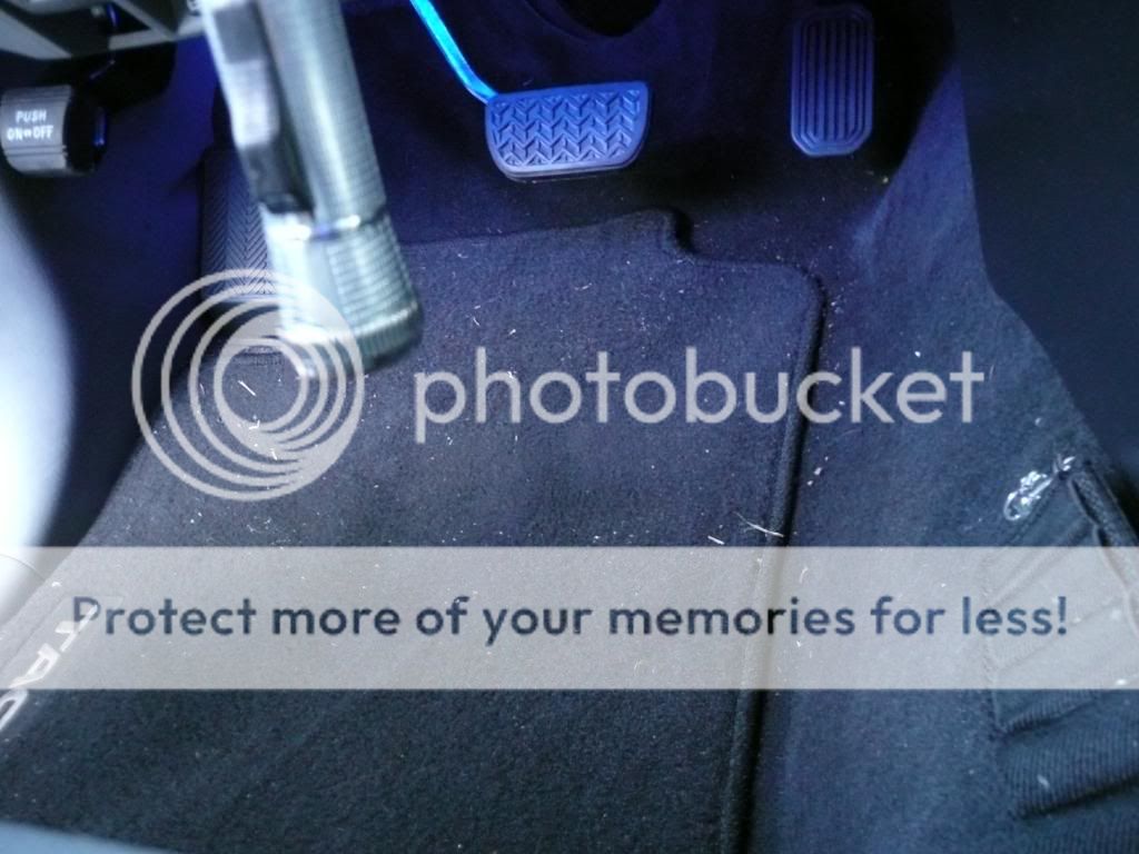

    Interior/Exterior completed:
    Near Stock 2013 Toyota Tacoma

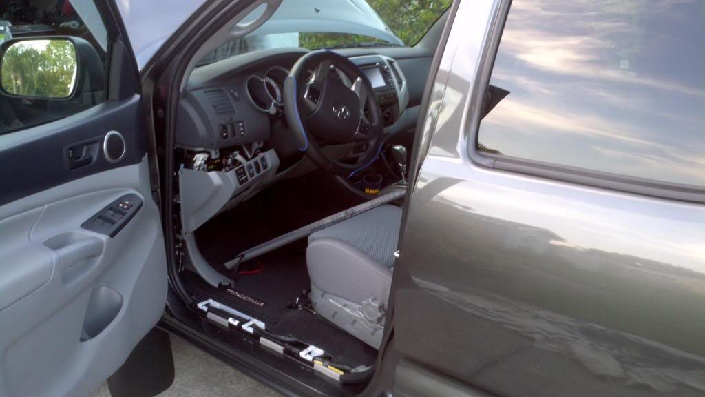

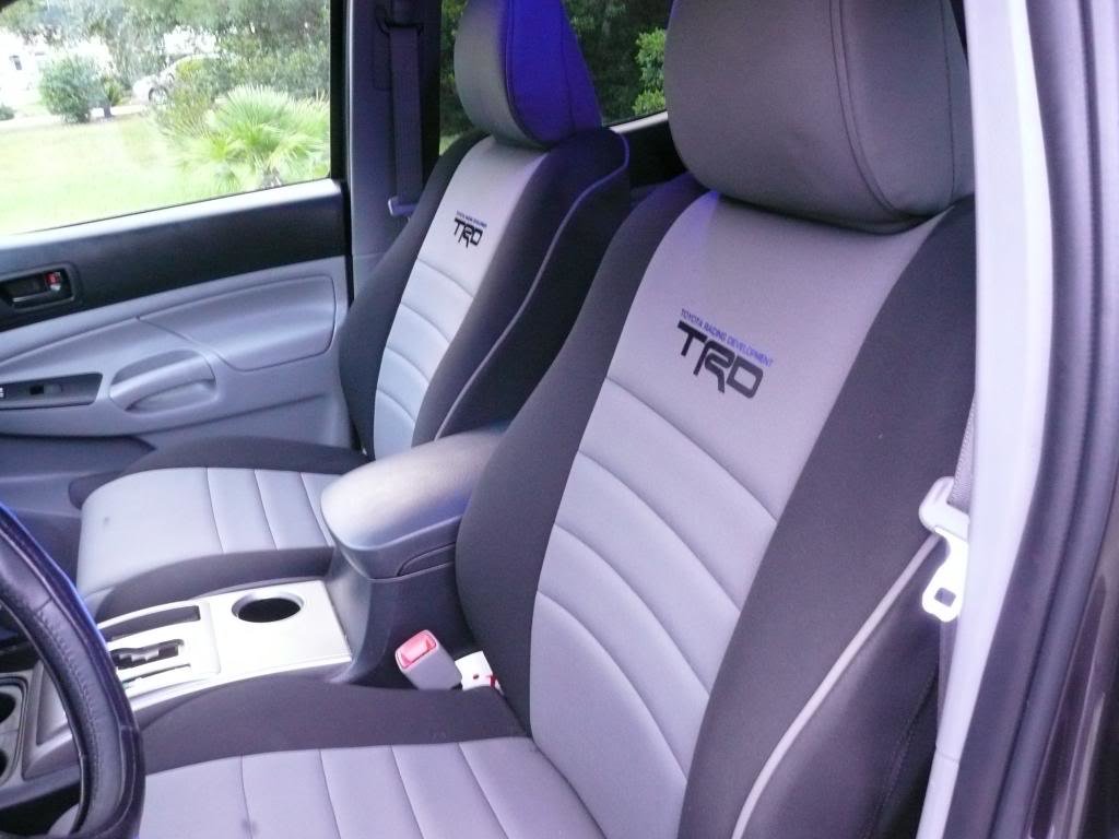

    Heres the Interior and Exterior now

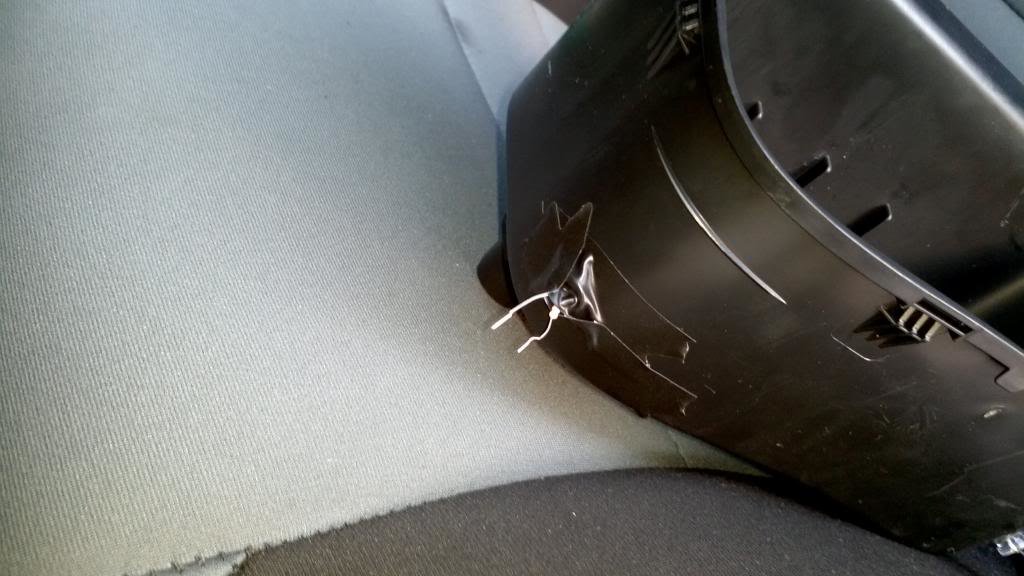

    Interior
    Back Seat:

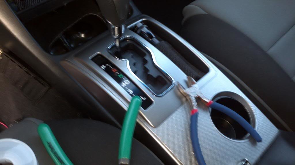

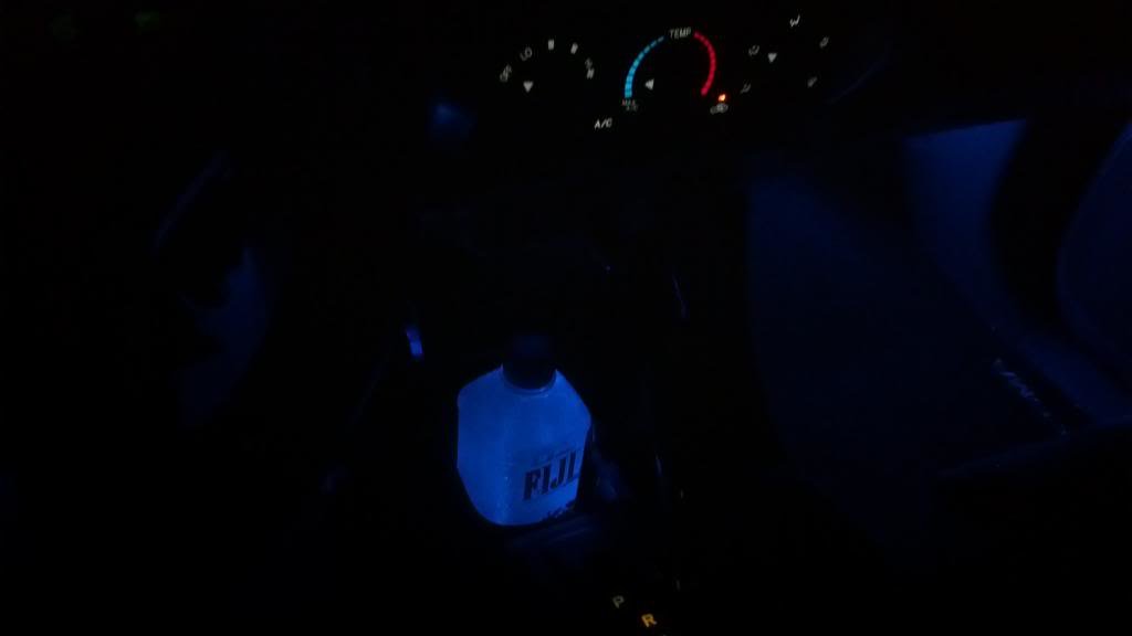

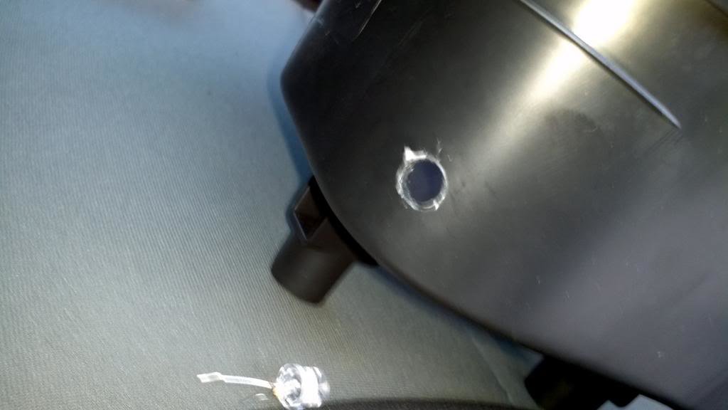

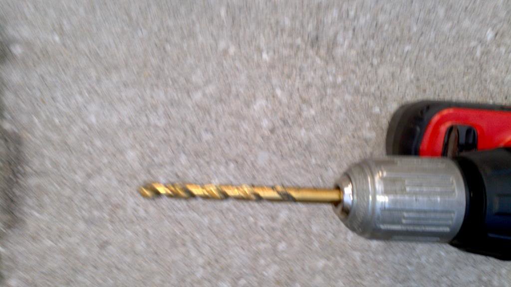

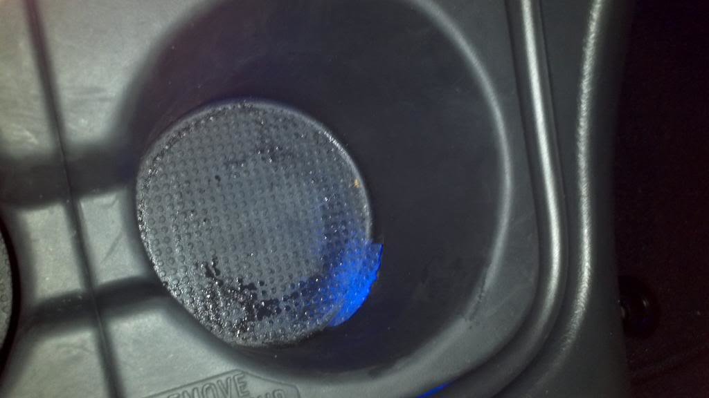

    Cup Light Mod 2013 Toyota Tacoma
    Tools:
    -Solder tool
    -red and black wiring
    -a switch to turn them on and off
    -Drill and drill bit matching the size of the LEDs
    -Guts to do this to your cup holders
    Used this to melt holes in the rubber cup holders
    Drill and Drill bit
    Drilled out and ready to go
    Now to wire them up

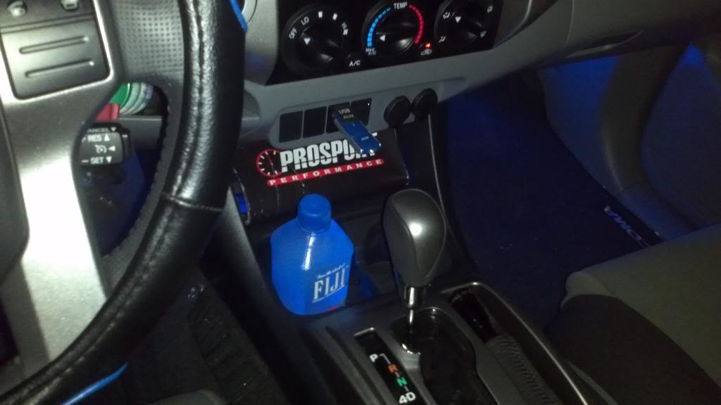

    One of my favorite mods which makes any clear cup from a restaurant into Gatorade!

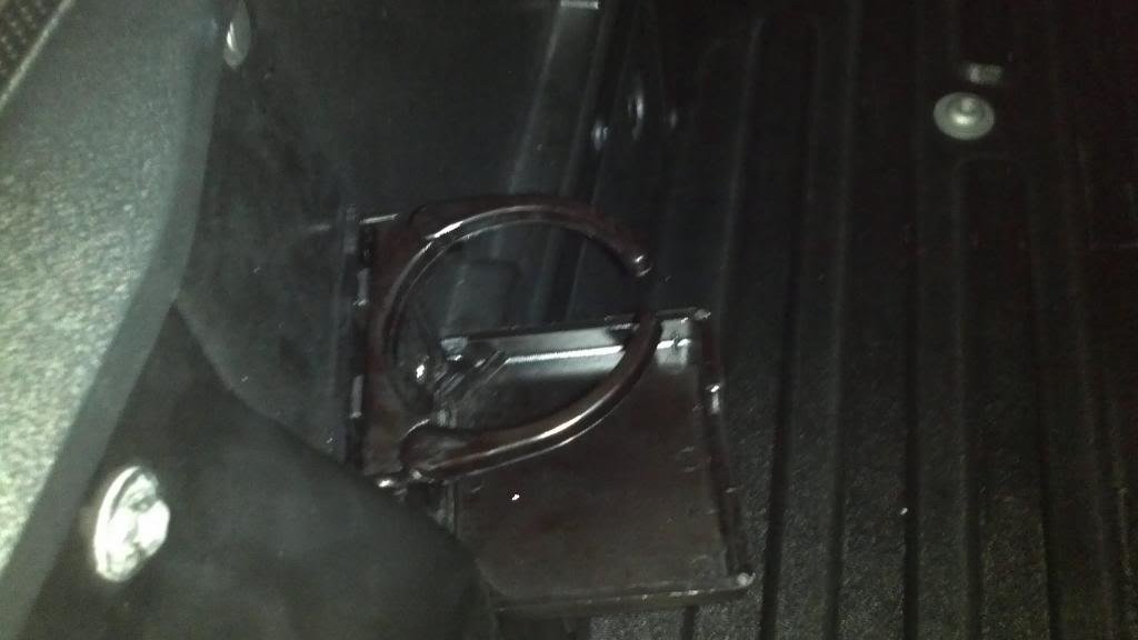

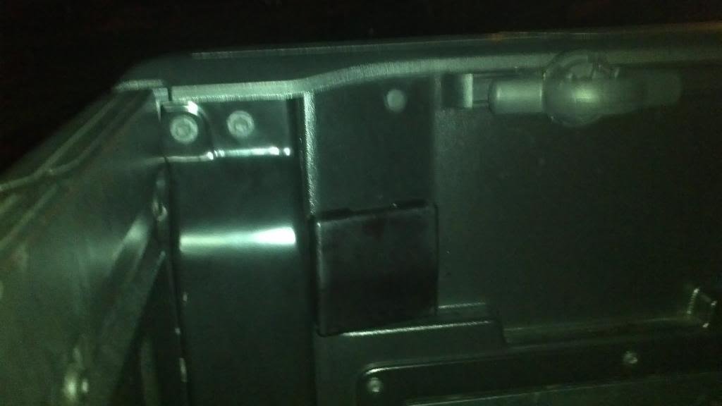

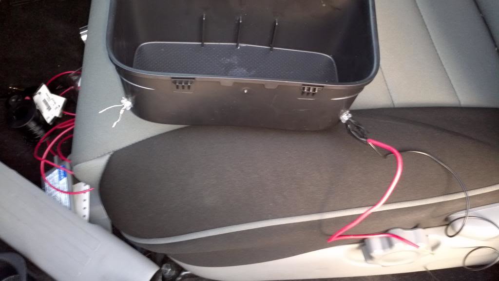

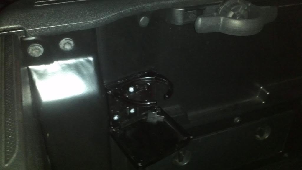

    TRD BED cup holder
    You get one from a marine store or ebay and then you find a place you like and drill some holes for the screws and your done. It took me 5 minutes.

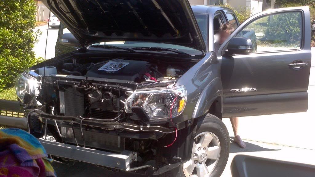

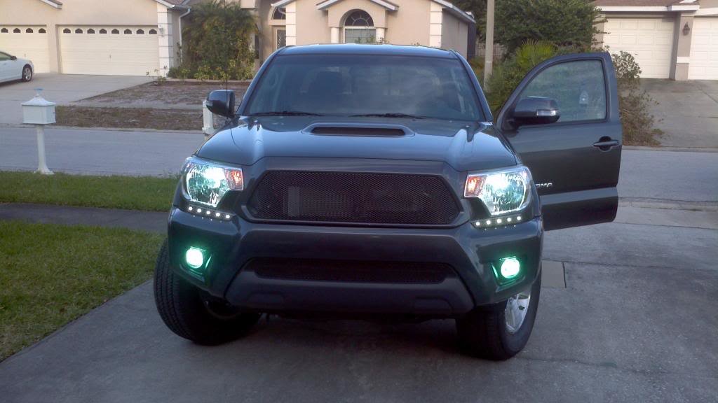

    Alright I went and ordered the kits for HIDs and it came with a cover above the headlight bulbs so they stay level with the bumper of the guy infront of me. It included wiring harness and when you take out the stock halogen bulbs you just install the HIDs and hook up the connectors to the stock connectors and it uses the stock halogen connectors as a signal wire to run on the lights. I modded the Fog lights to run anytime and installed them straight to my secondary fuse box for accessories. The hardest part was getting the new switch through the fire wall and and resealing it so I could drive though the water again :D and taking my dash apart to wire it up.
    The Finished Project

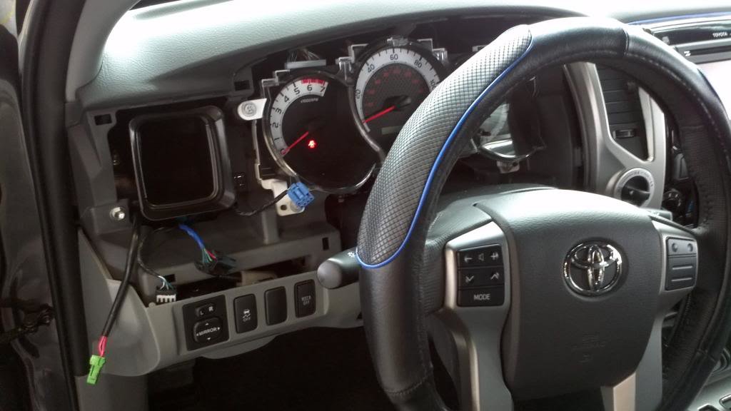

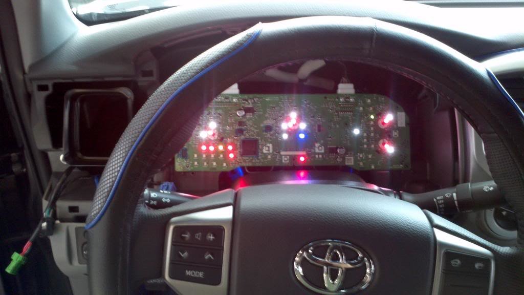

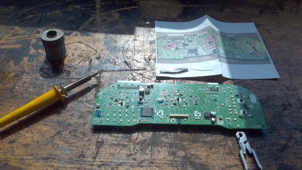

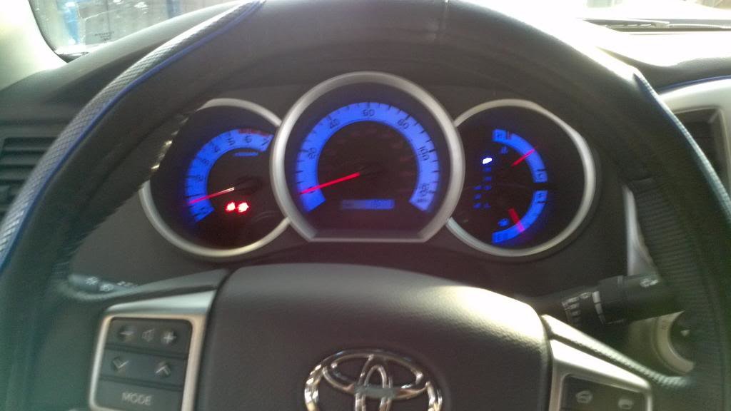

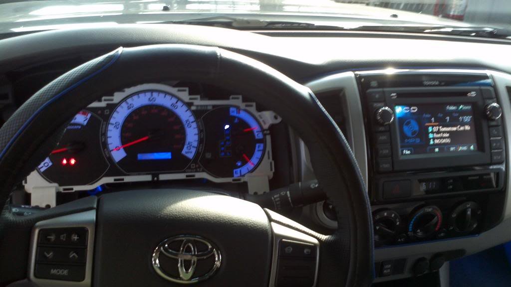

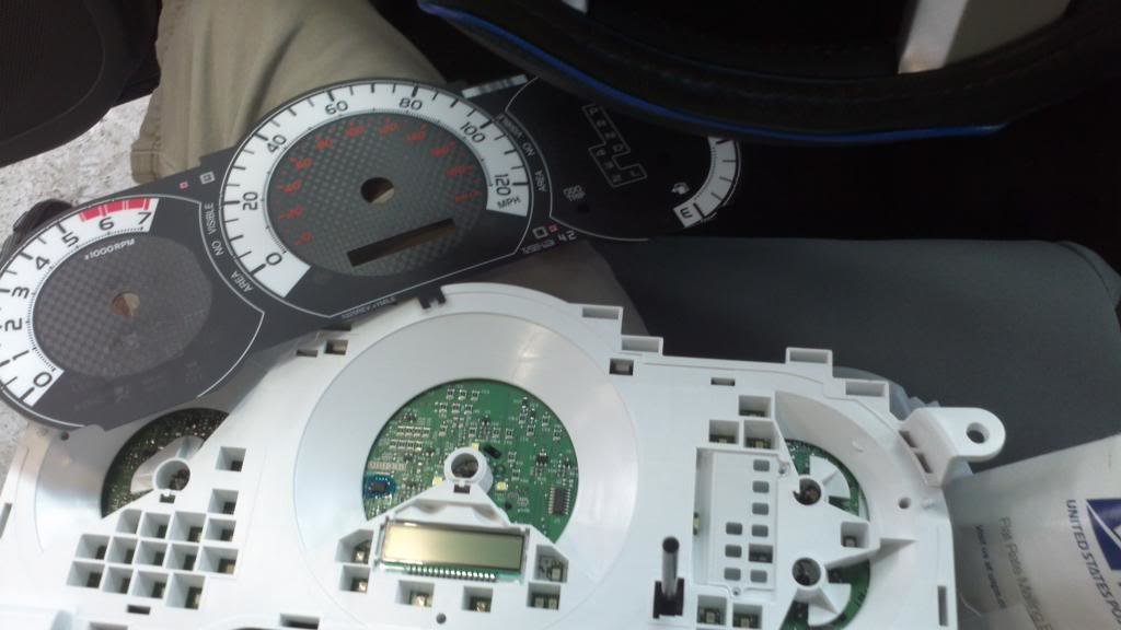

    Ok so this mod took some time and you have to be careful not to destroy your micro board but it looks amazing.
    Tools:
    -Solder Tool
    -Solder
    -Micro LEDs for your micro board
    -some skills to pay the bills... and not mess up your gauges :rolleyes:

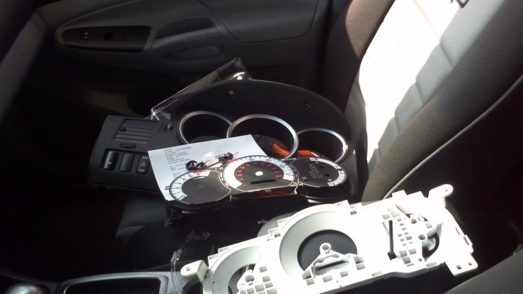

    First you need to remove the face plate to the speedometer/dash
    Now remove the screws and take out the speedometer/dash itself and remove the skin
    Now use your layout and plan which LEDs your going to switch out
    Heres what it looks like without a speedometer/dash
    Heres all the different pieces

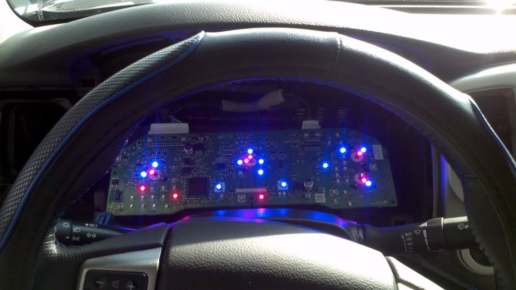

    First Blue LED installed (Any color you want)
    Heres my layout so I know which LED has been switched out and soldered
    My side by side
    Only took me 1 hour :cool:
    The Finished Product

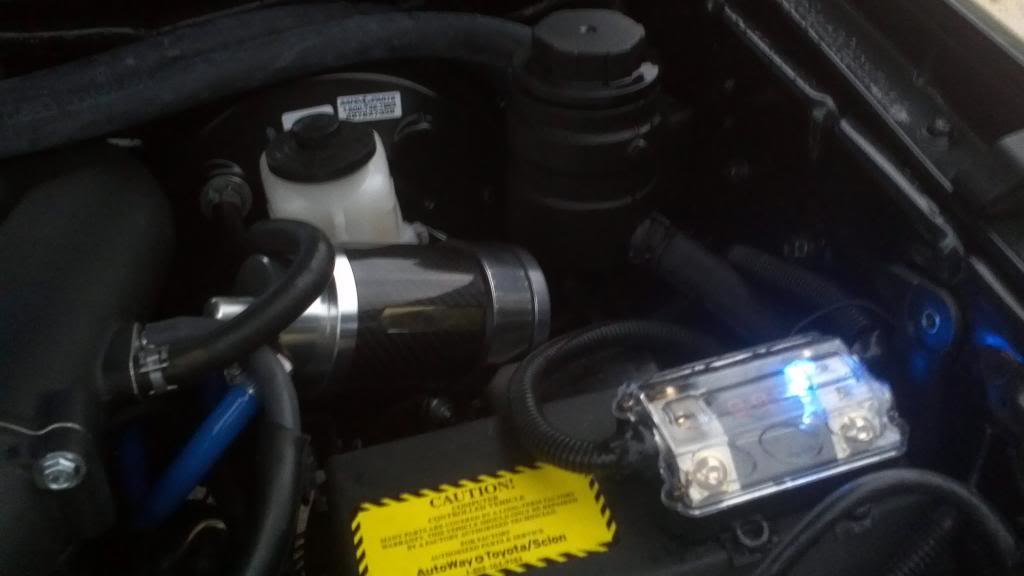

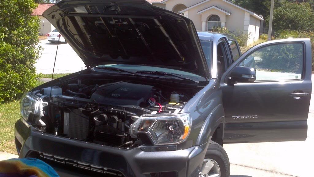

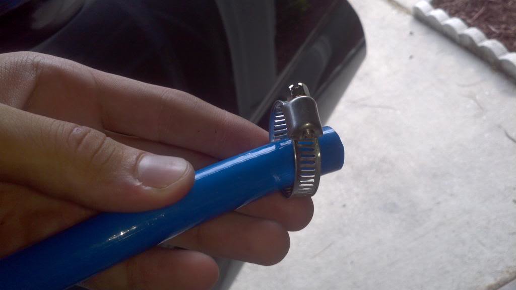

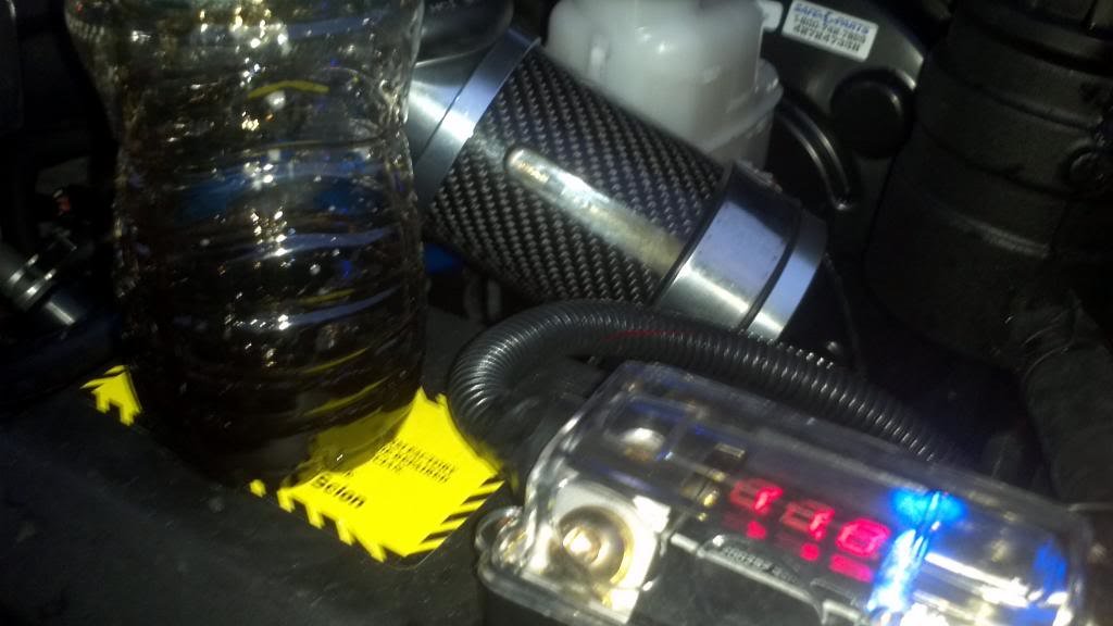

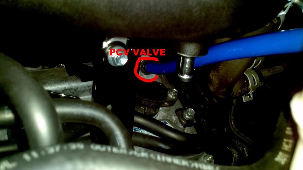

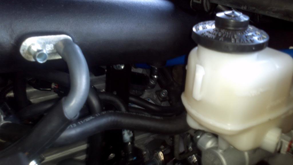

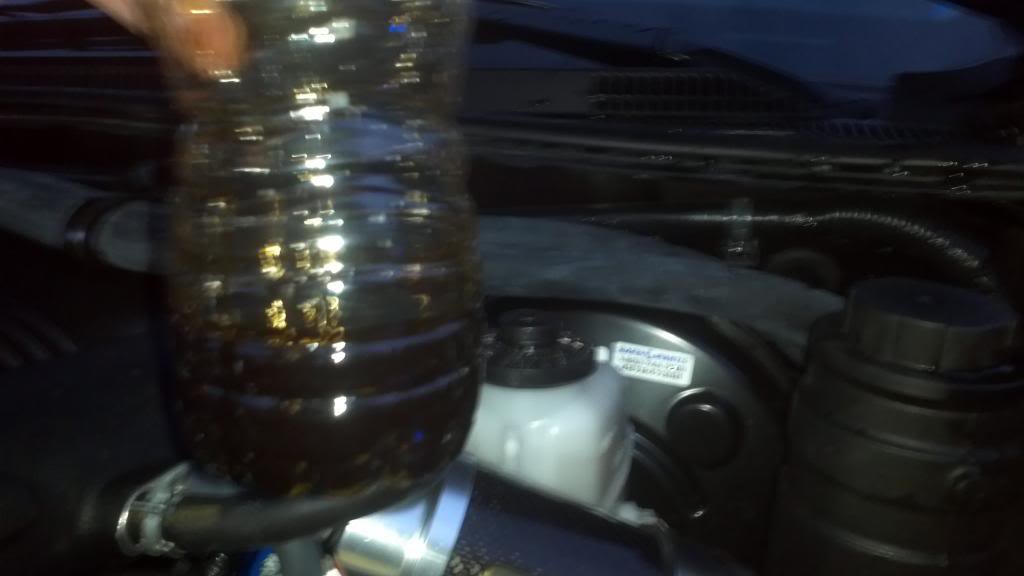

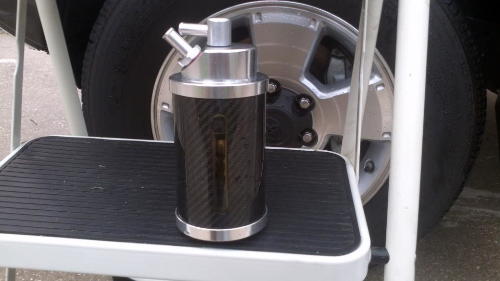

    Heres my Oil Catch Can install
    I used 3/8 Fuel Line and a Carbon Fiber Oil Catch can
    Check out my install and maintence Set up I can look on my laptop for step by step instructions and play some tunes!
    That is the PCV valve
    Heres the hose clamps for the tube I like blue so I got blue 3/8 fuel line
    Installing this baby in the truck
    Installed on and has been keeping my engine clean for 6 months now
    This is what it has collected at 2000 miles

    Dude your cup holder mod hahaha that is freaking awesome man. Haven't seen anyone do that. I'm gonna have to give that a try one day when I get the balls to.
  10. Nov 5, 2013 at 7:41 AM
    TripleThreat
    TripleThreat [OP] Vance@freevancewriting.com
    Sep 18, 2013
    #112768
    1,518
    They keep callin me cowboy but its not my name...
    Socal but I am still a southern Florida guy
    Toyota Tacoma 4x4 slightly modified
    nothing special.... wanna race?
    Yes it was actually pretty easy all my drinks turn blue haha and I have a "red" switch to make it hilarious whenever someones in the truck thier like whats the red switch do and im like don't touch it!

    your truck is pretty sweet. if you dont mind me asking what is the purpose of a oil catch can?
  12. Nov 5, 2013 at 7:45 PM
    TripleThreat
    Sep 18, 2013
    #112768
    1,518
    Thanks and the general use is in turbo or supercharger applications, or high-performance race applications where excessive blow-by (leakage past the piston rings) of air and fuel vapor occurs. This creates a positive pressure in the crankcase. Engine manufactures have placed a valve on the engine block which releases this pressure. This valve is known as a PCV (Positive Crankcase Ventilation) valve. During engine operation, blow-by gases, as well as oil mist from the rotating components of the engine, pass through the PCV valve and are routed back into the intake for the engine to burn off. However, some of the oil mist and other products settle along the engine intake and over time form a "gunk." The oil catch can collects the oil mist and condenses the fuel vapors while allowing "cleaner" gases to be passed back into the intake. Typically the blow-by gasses are passed through a wire mesh, which give the vapor droplets something to adhere to. Since the oil catch cans condense the vapor portion of the gasses, they will need to be drained periodically of all the oil, fuel and other things. I can't say I wasn't surprised by all the oil and unburnt fuel it collects I can say its makes bonfires a hell of a lot easier to start :headbang:

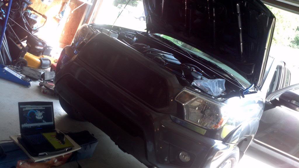

    Just an update and more modifications to the truck.

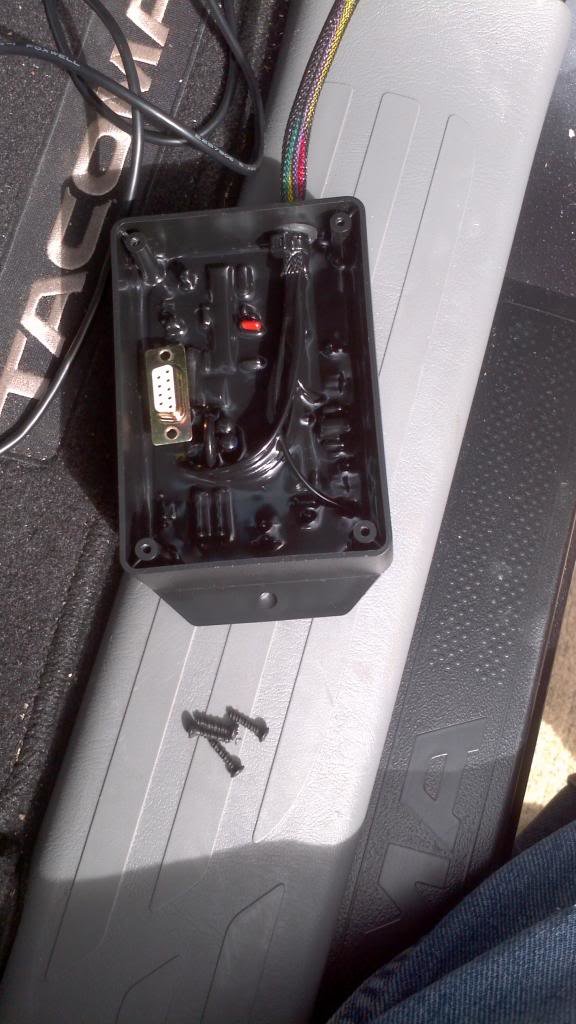

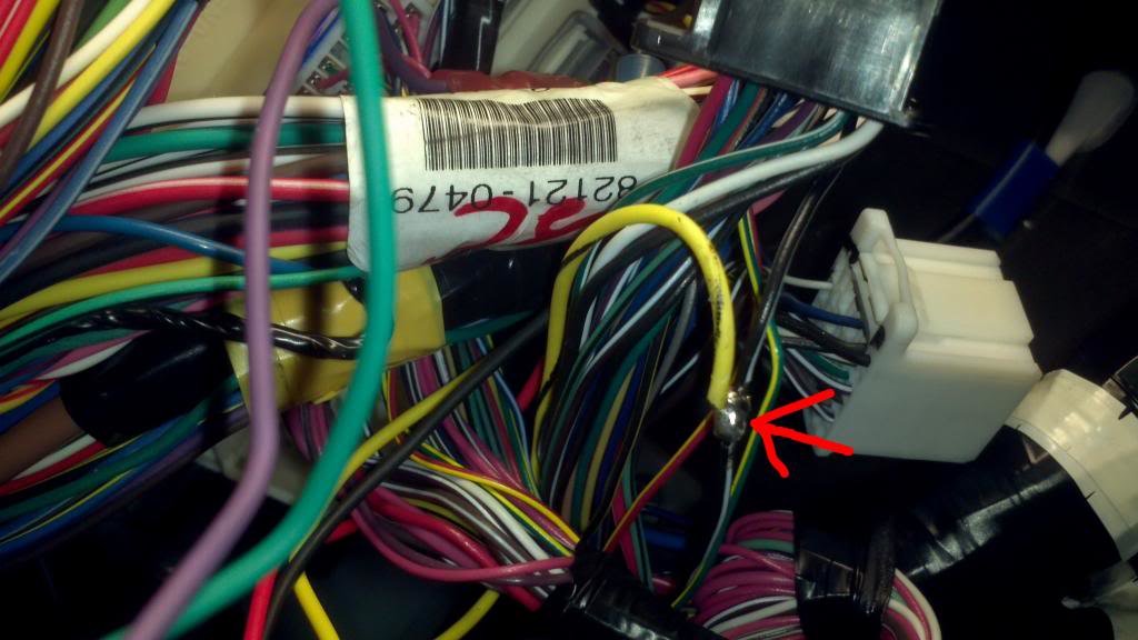

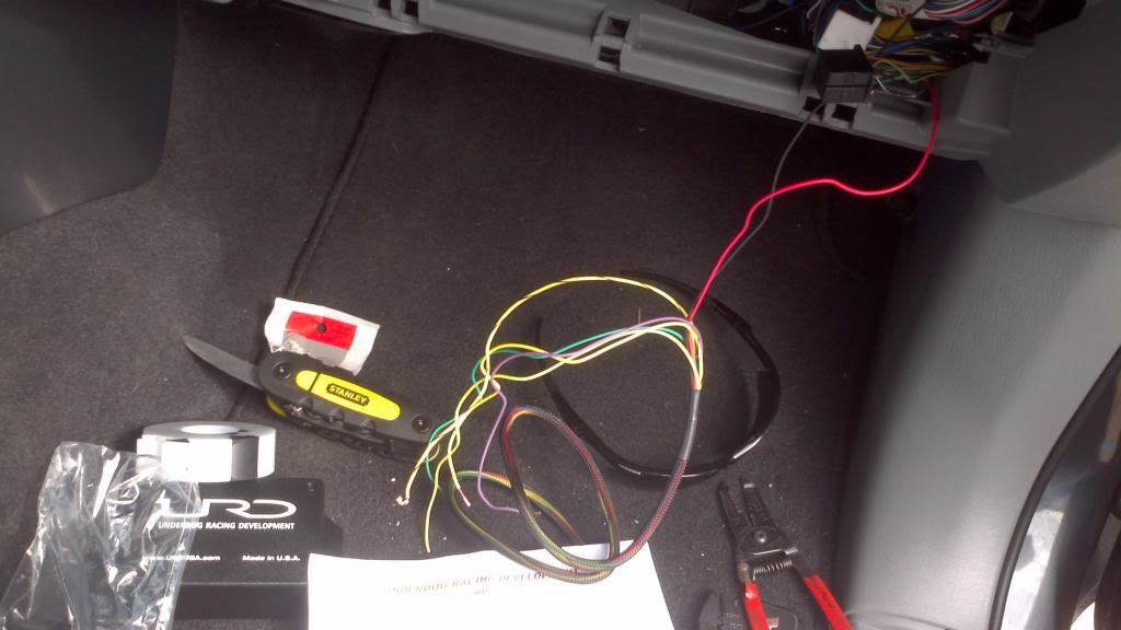

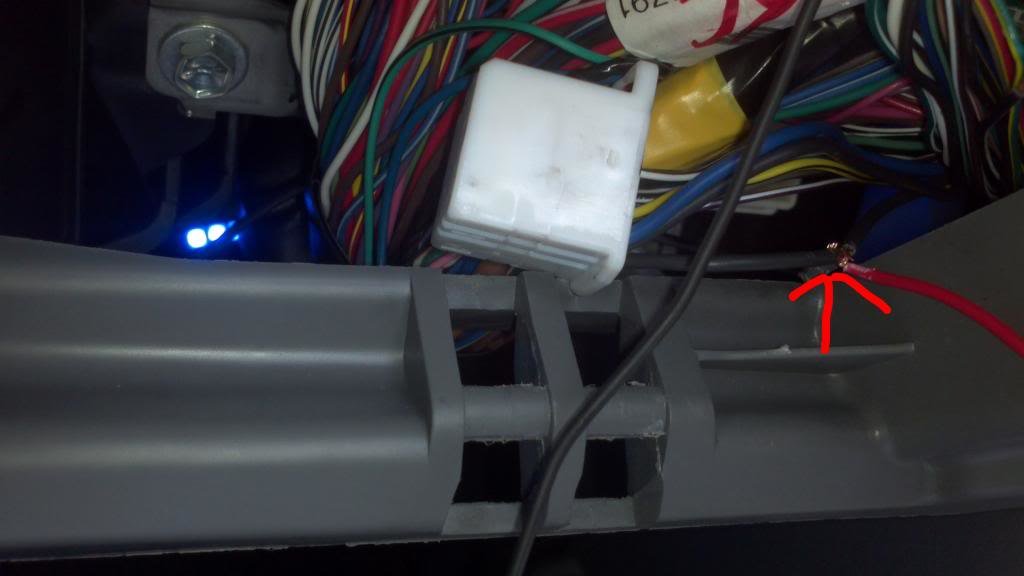

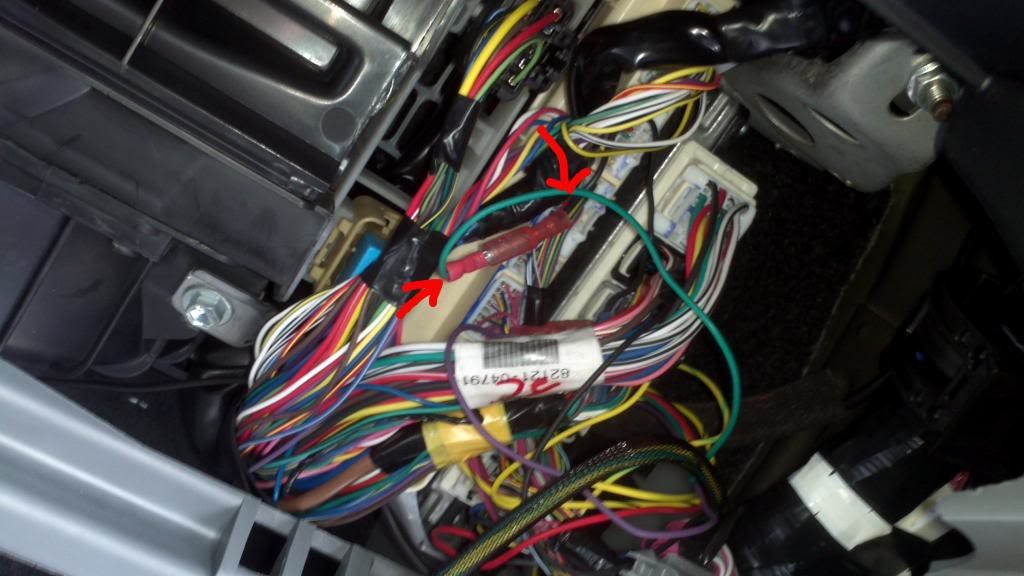

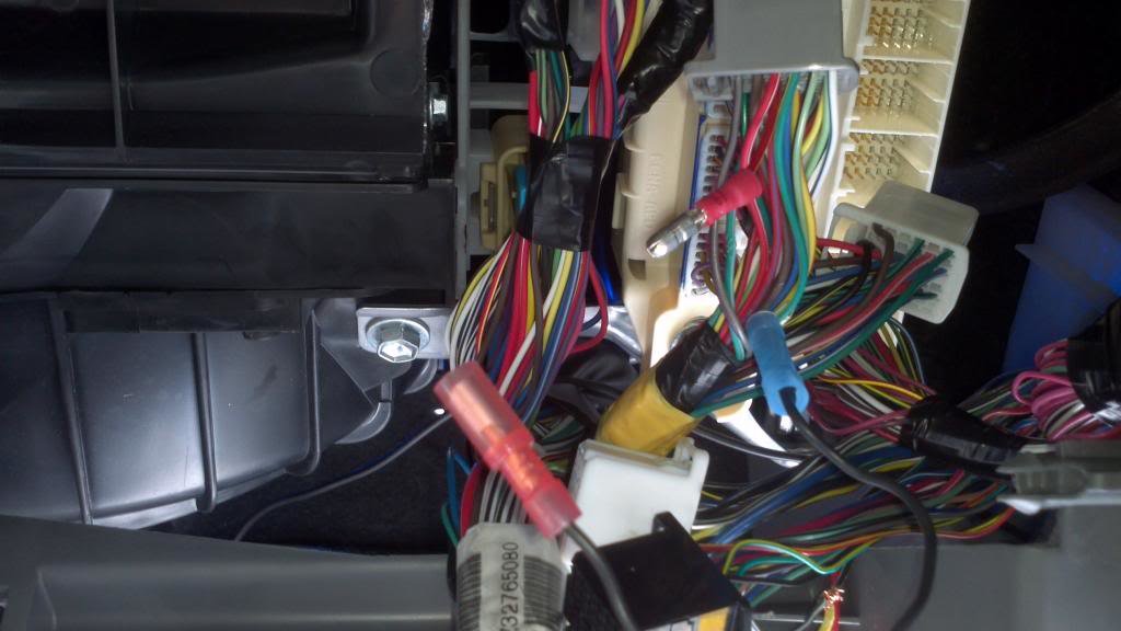

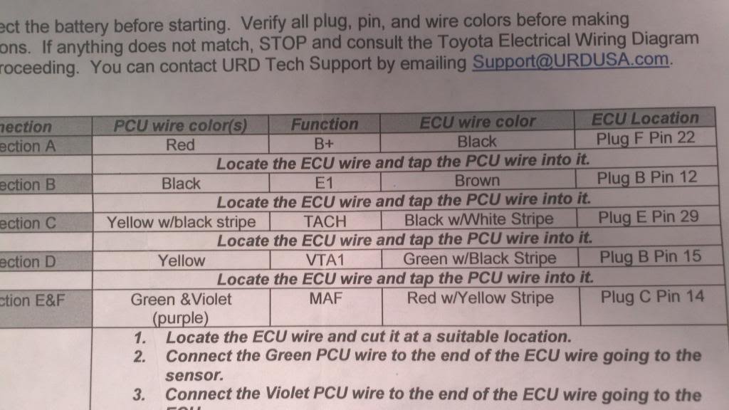

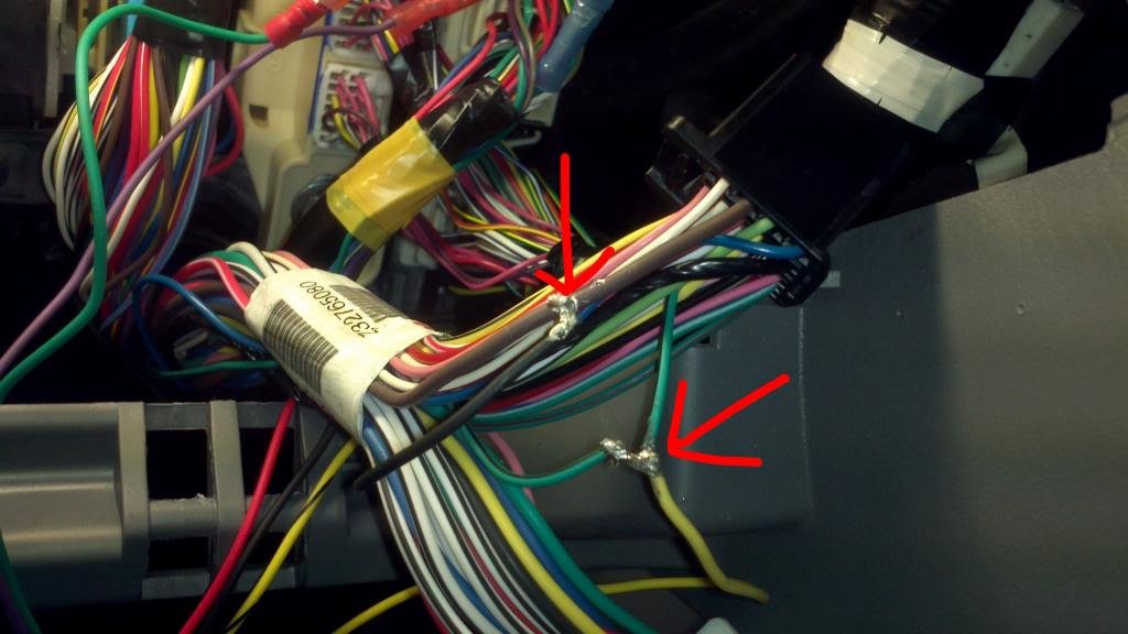

    Ok I talked to Gadget and bought a URD Maf Calibrator then got it tuned and I actually don't use this anymore I went to a full new ECU upgrade for alot more but I got 35 RWHP from the MAF calibrator being the first tuning to the truck with all the performance upgrades.
    The tools are laid out and let the wire tapping begin!
    First Set of wire taps
    Second Tap
    Third Wire Tap
    I used crimp connectors for the interception of the maf wire
    Heres the wire diagram for each of the taps and intercept of the wires.
    One thing I was not aware of when I had the MAF calibrator is I needed a "serial port" computer to tune it

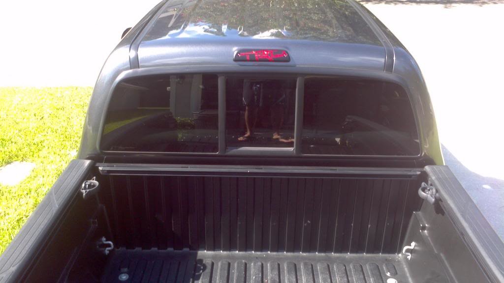

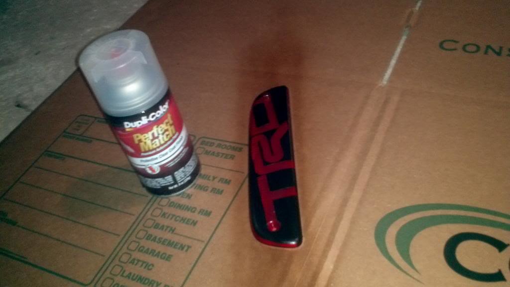

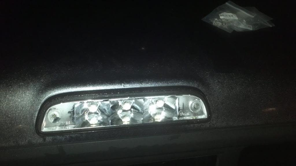

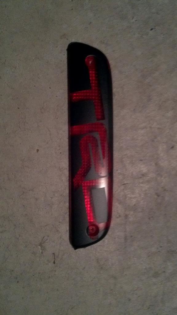

    You can go get a decal from toyoda or anywhere else and install it but I took it two steps further to make the mod worth it.
    -Switched out bulbs for low light LEDs which are still brighter then the bulbs but not to bright.
    -Clearcoat so the decal withstands mother nature
    Warning: It is actually illegal to put anything on your brake lights I looked it up but im a home loving american that does'nt give a...:oldglory:
    First you remove the Brake Light Cover (yes my LEDs are already installed I took them off to give this step by step)
    Now take out the crappy bulbs and install low lighting LEDs becuase bright ones will light up the car drivers face behind you :D
    Put the Decal you selected on the 3rd brake light
    Take it one step further with Clearcoat I sprayed it with 3 layers and didnt sand it down because its not needed it looks great and its protected from the environment!
    Finished Product

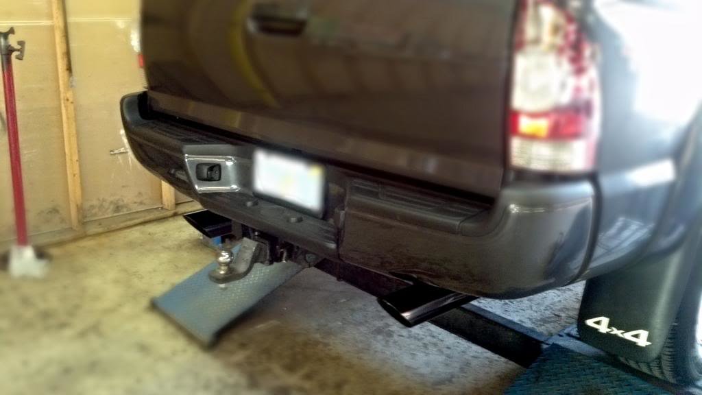

    On the truck I have 4 inch color matched true dual exhaust with a X pipe.
