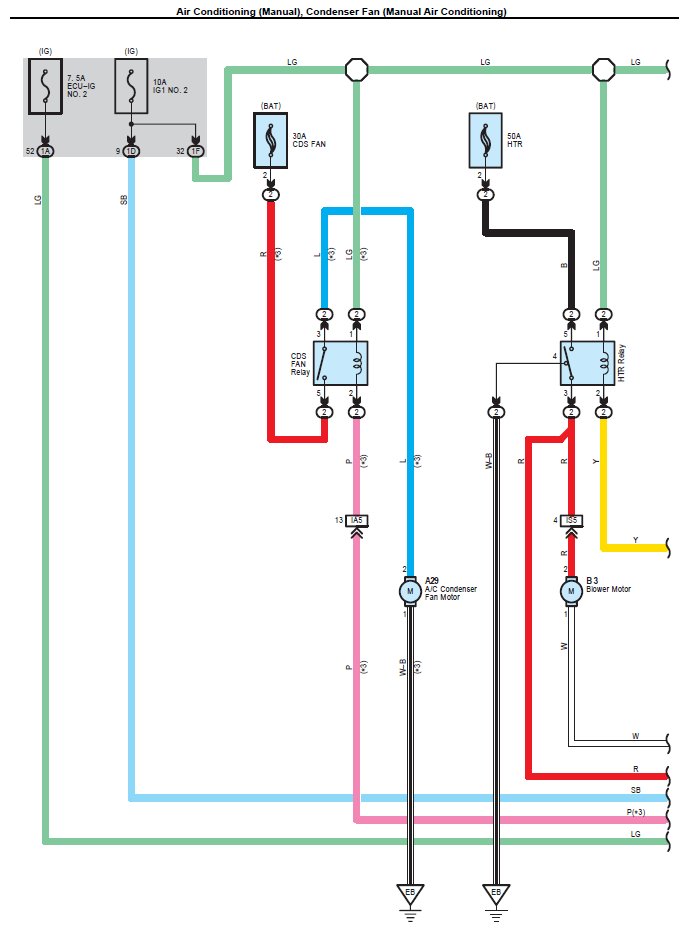

    I almost want to do it myself the way they do it IF tapping into the ecu turns it off at speed . it looks like it should be $50 or so .... $25 for a fan and the rest for a relay and wire... what am i missing ?

    The ECUs primary input for the A/C fan(s) is likely the AC high-side pressure sensor. Most cars use that input. In this way the fans do not run when the car is moving and there is enough air flow over the condenser to lower the pressure. You can use the existing fan relay output (ECU controlled) to cascade to your new fans relay input.

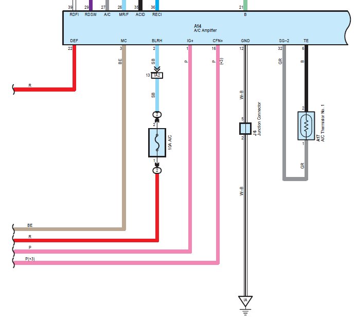

    Don't think you are missing anything. Keep in mind we don't know when the ECU decides condenser fan on and off yet..
    Factory schematics shown. ECU factory grounds Connector A14 Pin 16 to turn the fan on.
