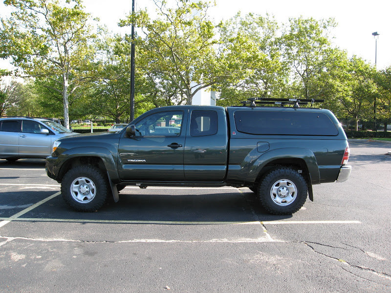

    I just tried this and was told that the dealer couldn't align it to anything other then the manufacturers specs. I said BS, but they wouldn't get it to the specs that I wanted, so I have to go and get it done again elsewhere. I guess it depends on the dealer, but just watch out.
    As far as what to set them at, I set the front at 1.75 with the TSB leaf pack in the rear to make it level. I forgot to take into consideration that I have a cap on the truck that adds a few hundred pounds and now with the bed empty I still slightly nose high. If you want some rake left in the stance, go for the .85. If you want it level, be aware that 1.75 is about level with no weight in the back and it will look to sag slightly when you add some weight.
    Here is how she looks with just the cap and the bed empty:
