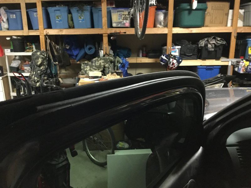

    Anyone have issues with whistling noise through door seals while driving?

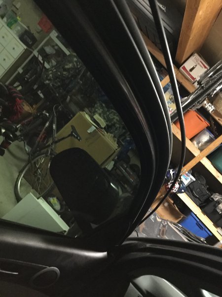

    Yes and it's atrocious, dealer has replicated and no fix yet... I have dripline (irrigation) in the door seal and that does "fix" it.

    I snapped a couple, hose just sits in the channel I haven't glued it in since I want to easily take it out if a tsb occurs.

    Interesting, never considered overpressure... it only happens at 50+ mph and only with a 20+mph sidewind... hell of a challenge to get the dealer to duplicate. you can feel the door pulling away from the truck... happened since brand new on both sides.
    Is this vent behind the rear seat? What would I be looking for?

    It varies on trucks/Models. Check the rear of the cab center area. You may be able to see a "grill" covering the opening... Do you have a sliding rear window - id so try just cracking it open a little and re test
