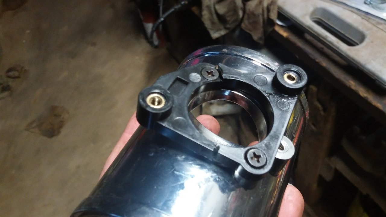

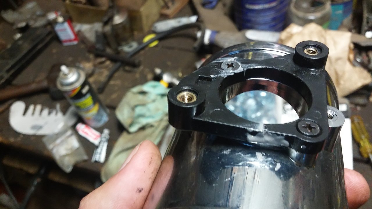

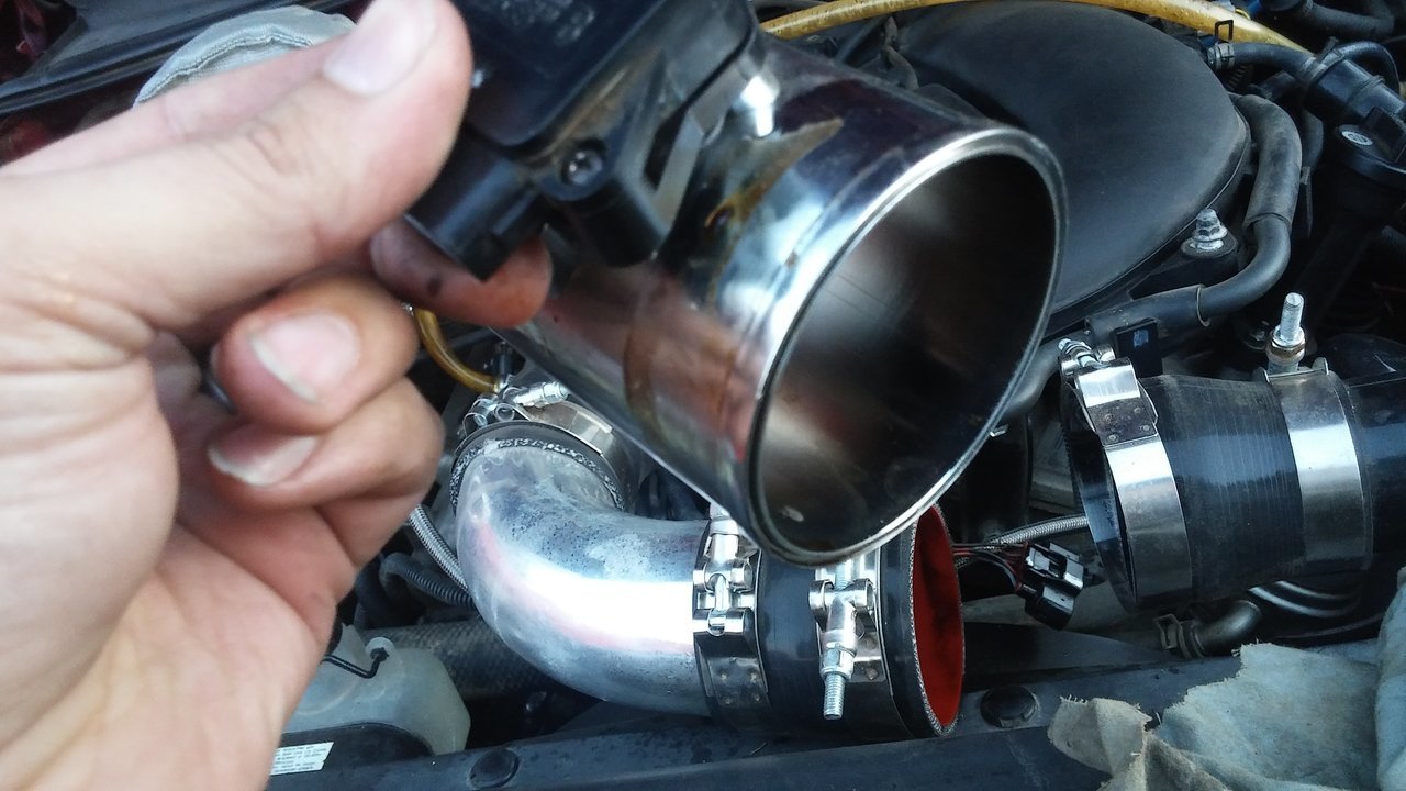

    Well couple of issues. Oil in the intake (kinda hoping that was from when i had oil running out my tail pipe because my return line was too small) so dirty maf didnt help anything, wiped the oil off but found my maf adater was busted so jb weld to the rescue... Hopefully. That does explain the crazy afrs since i had a leak i guess.

    That will mess with afrs. Good find. I had to machine my maf

    Im sure i just over snugged the screws, i let the gaskets do their job this time haha

    Hmm crazy AFR’s from maf sensor and a leak hmm

    If you cannot get it to seal properly, even after this repair, www.treadstoneperformance.com has aluminum maf flanges welded onto the tube. About as long as your segment.
    Those fixes should greatly improve your trims.
