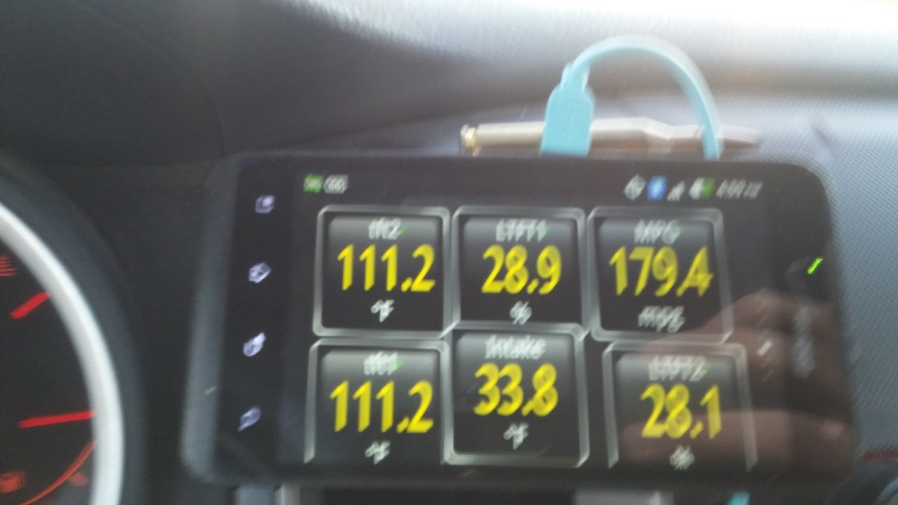

    In case u didnt know, if u mess with ur fuel tables, ur mpg output is affected... (this is coasting so fuel cut, but thats still 100mpg more than it used to be, even broke 200 a time or two)

    Those trims are out of hand lol

    I know they are terrible but it wont start if i dont have that much fuel pulled at max vac and low rpm. As soon as vacuum gets less than ~20inhg they go to ~10% (i know that still isnt great but im chalkin it up to a vacuum leak i havent found yet and the ecu is still able to keep my afrs in check so i dont wanna tune around a problem just to have to retune once it's fixed)
