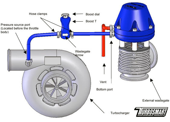

    I'd just skip right to an ebcs since the haltech can run it.

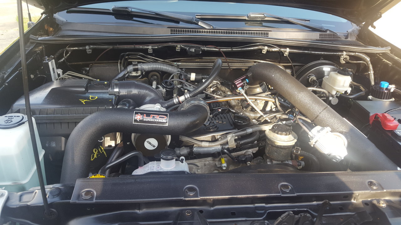

    really....this is interesting. Didn't see a ton of other threads of people having issues with URDs kits. Is it really the kits? Not to be blaming you but I don't see how I wouldn't be fighting these same issues with a custom setup if a tested/finished kit from URD can't hold up.
    I'm open to removing the air injection. I think I saw a thread on it somewhere essentially plugging lines and swapping the valve cover or something if I don't wanna weld/plug it.
    @OVTune could you confirm ideas on a turbo kit for 2nd gen? In the making or way out on the timeline?
    I mean if I go turbo there's lots of good tuners I feel around Houston. Wonder if just going full piggyback or standalone and budgeting 1000-1500 for a pro-tune would be simplest.
    hehe got a little over the top with the parts huh? You mean in terms of turbo/wastegate size and setup?
    That's what I was thinking...some sorta small turbo. I want it to come on quick and I imagine our 4.0 breathes well enough to spin something decent size up by 2500 or so. 3" piping, internal gate in theory would be easiest but they can also be a pain. Probably no room for an external gate. What are your thoughts on stuff like that for size/spacing in the bay

    Goes to the bottom port of the ewg. Just leave the top port open to the air. Run whatever spring you want as a baseline. For example you run a 7psi spring you will boost a minimum of 7 psi and build up from there. More aggressive spring, earlier you can spool. Boost controller just bleeds off air until you hit your desired psi.
    Ebcs is a dynamic controller by commanding a duty cycle.
