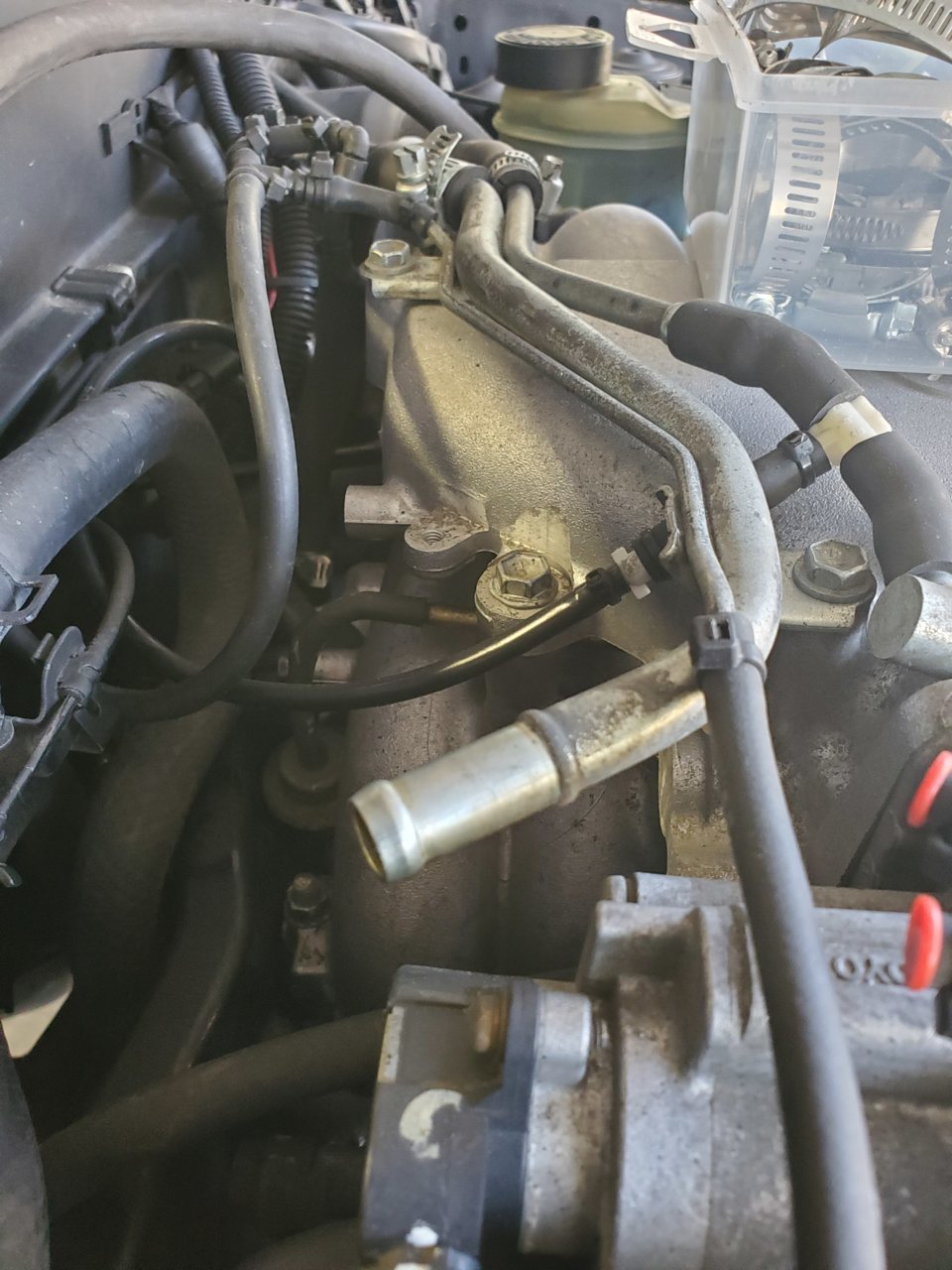

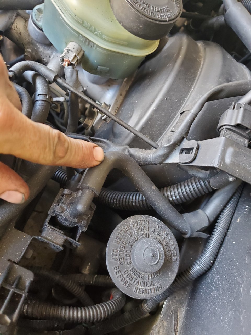

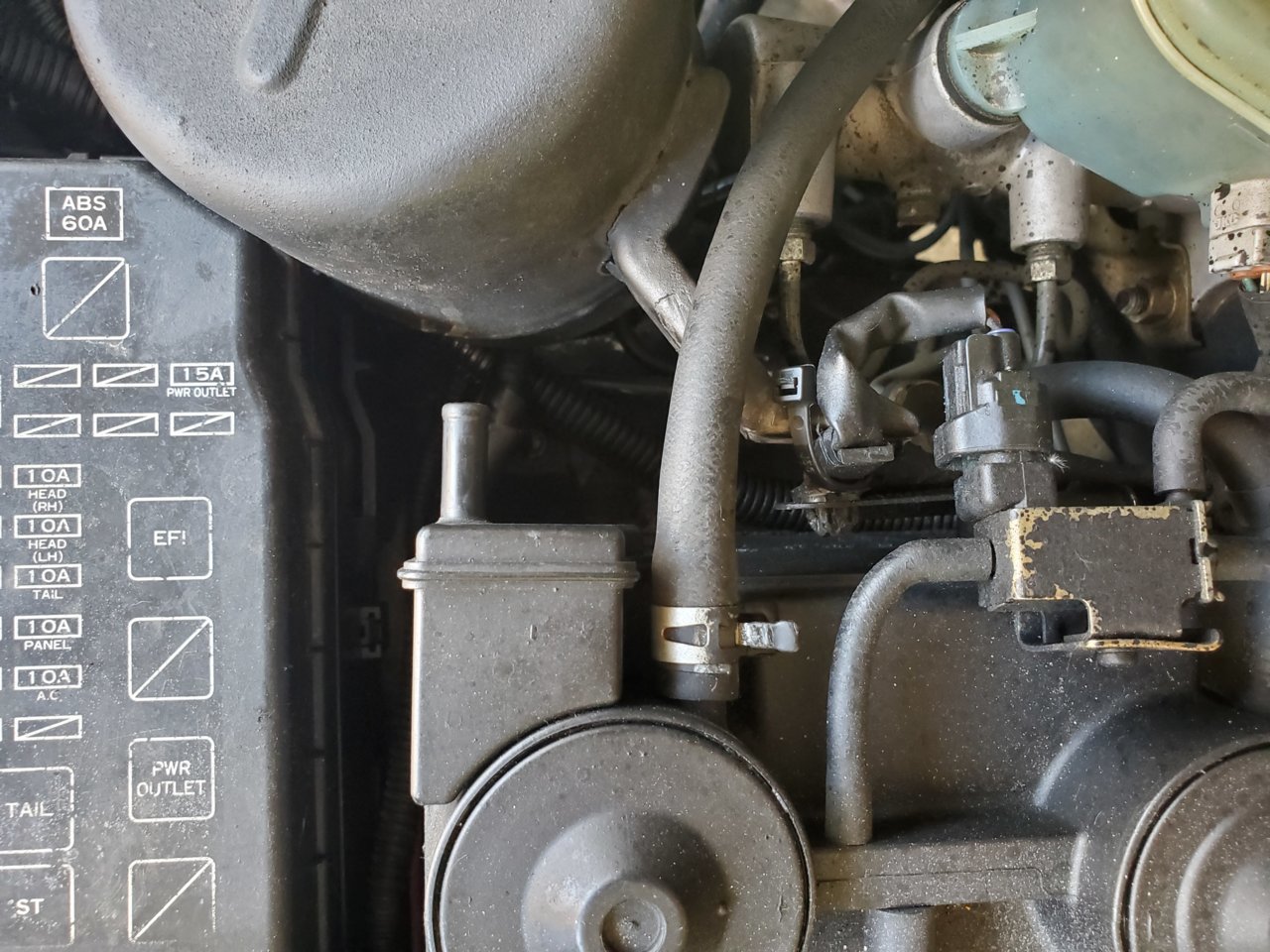

    Can someone tell me or send a good pic of their vaccum lines on 3.4 turbo. I'm getting oil blow by and want to re-route. What's best for these? Mainly the 4 bigger in the combined pics20190703_124646.jpg 20190703_124608.jpg 20190703_124559.jpg

    Intake, exhaust, lift. Typical stuff.
    Brake booster has a check valve; I left it stock.
    Fuel pressure regulator vacuum should be kept stock.
    There is a breather on block by the firewall that is connected to the resonator box on your stock intake. I put a breather filter and a one way check valve on it to only allow air to enter the block.
    I routed the fuel Evap line and PCV to a Y connector into my catch can which can be vented (it will stink; no more fresh cabin air for you) or can be connected to your intake.
    -If you connect your catch can post turbo, when the intake has positive pressure, that will block back to your block and evap. The PCV is a one-way valve but the evap isn't. Putting a check valve on the line will protect the evap but the big issue here is positive pressure built in your block is much higher during high loads, especially when you are under boost and that pressure needs to be able to escape or you may blow engine seals.
    -If you connect your catch can pre turbo you need to make sure the catch can is extremely effective in cleaning the air so it doesn't gunk up your turbo and MAF.
    **Best way to mount your catch can is run it to a vacuum fitting on your exhaust as was discussed a few pages back. I haven't done this yet**

    Still confused. You got a pic of your engine bay? There's a bunch. And Gio is running his way different now. We had originally tied in two lines to a filter. It's been spitting mad oil out of it. Put in catch can now and I put a T fitting tied in to the oil fill cap so any extra oil goes back to fill. Kinda ugly but I need to find the best method for these hoses and valves. I'm afraid something on mine is way wrong.

    I'll see want I can do. I'd be careful about draining the catch can too the oil pan. Positive crank pressure is in the oil pan and this will break your PCV system.
