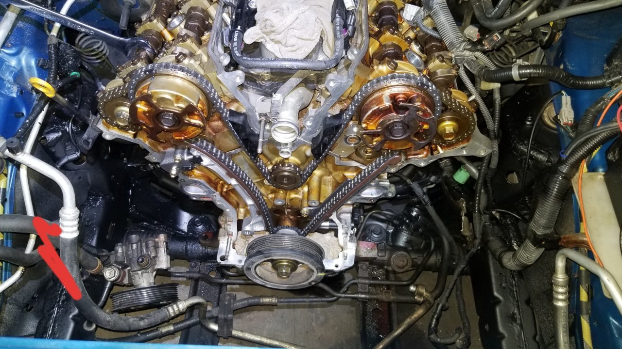

    Pulled aem ecu this morning back to stock ECU and stock injectors. Still same problem at idle bank 1 isnt firing at all. The coils are firing. Multiple misfire codes. Tried swapping cam sensor. Crank sensor is new its reading rpms. Kinda getting stumped where to check next why lost bank 1. Does cam crank sync have to be done on the stock ecu?

    The crank sensor wire down towards connector got smashed dropping other engine in and rewired it with crimp and solder connectors. Then wrapped up nice though theres an extension to it now that doesn't have the jacketing for a few inches. Rpms still seem to read right and no crank sensor codes

    Can run it at 3k rpm and start pulling coils off bank one and makes no difference. Referring to passenger side as bank one. Basically think its not firing the injectors or at the right time and only seems to be running off bank 2

    Replaced main timing chain and tensioners and pretty sure got all that back on right too.

    You may have to double check your timing.
    Do you have any tool to be able to listen and see if the passenger bank injectors are firing?
    Even a spare injector that you could plug into the harness and see if it activates, as the engine runs?
    Can you do a compression test on bank one, and report back?
