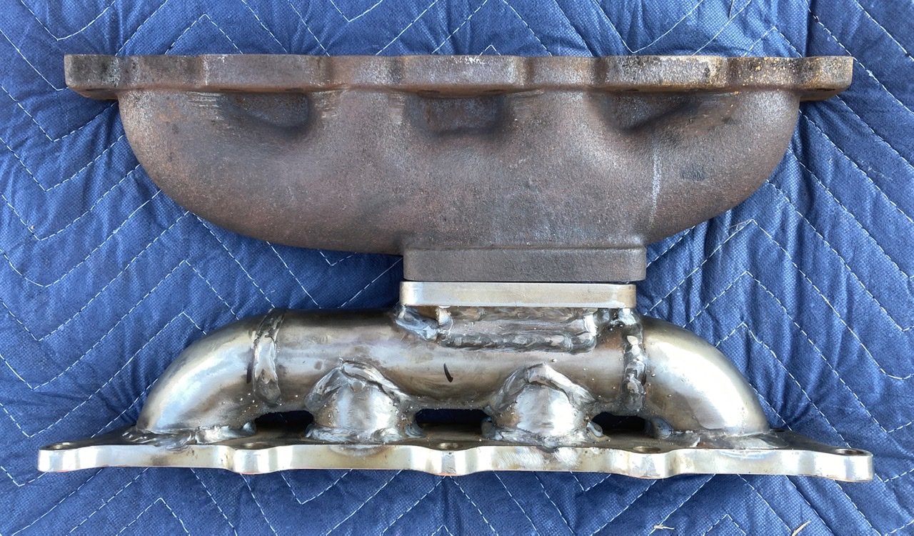

    It went from a pile of bits to a...finished product. Compared to the cast mani I previously had that was a PITA. It still spools the same and is a little cooler under the hood, too. I was able to shorten it 9/16” as well giving me some much needed clearance next to the firewall.
    Side note that could be relatable to the Toyota head. My VW had the normal exhaust double studs and I ended up helicoiling two of the holes. Upon further inspection I found that there was another 8mm of threaded bolt hole depth not even used. So I ordered some longer bolts with an internal allen head. Thought this may save someone in the future if it’s the same scenario. I went ahead and replaced everyone of them.
    This is the amount of extra thread screwed into the head. I trimmed them down with a cut off wheel so that they’d stick out the same as OEM.
    Found this website after buying some nuts off of Amazon. I go straight to the source now and they still have crazy fast shipping as well as a plethora of metric hardware. Definitely worth a look if your putting in work.
    https://www.belmetric.com/
