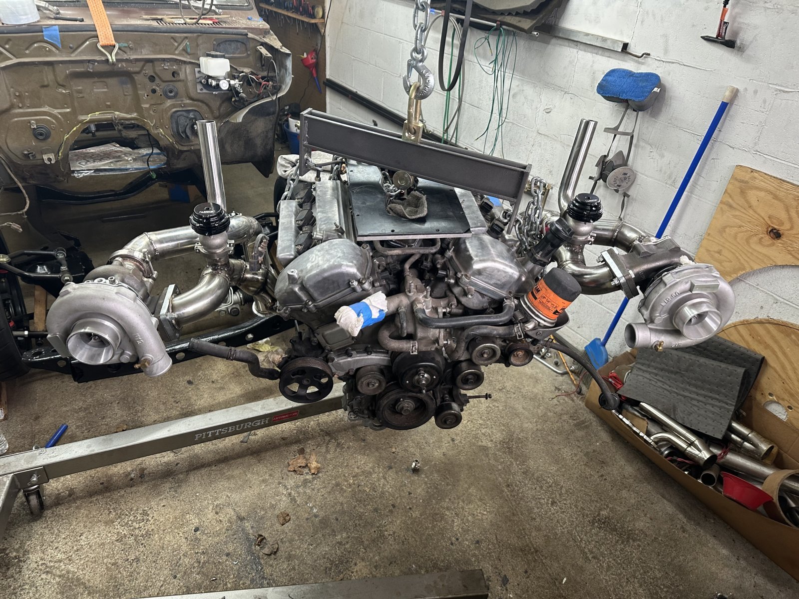

    1976 hilux 1gr engine
    Twin turbo

    That is a lot to stuff in a Hilux engine bay.
    But NICE!

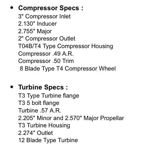

    Lol no oil supply lines yet, is wide so it can fit in the truck and not be over the hood.here are the specs for the turbos. They are really some dummy turbos for now. No internals yet all stock. Planing on getting it running first then build the engine. Shooting for 900-1000 hp when is re-done.IMG_1625.jpg
