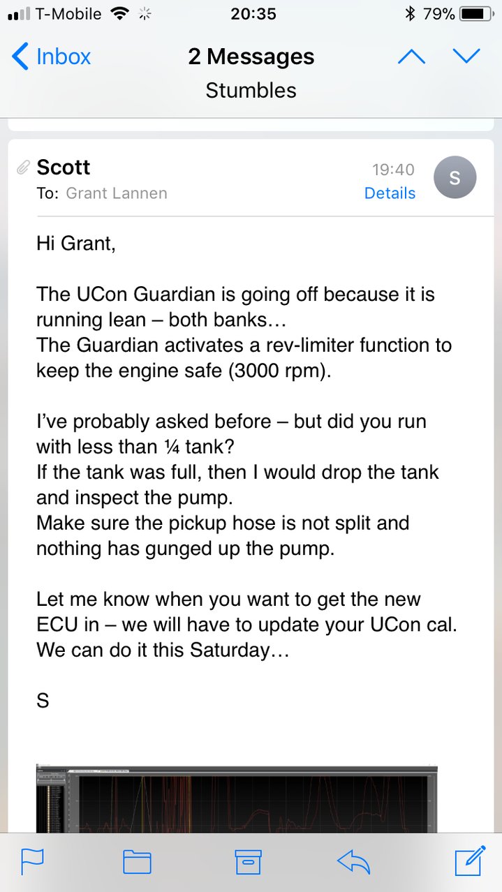

    Today I removed the brass jet from the bypass valve
    I did the fpr mod as well.
    Before these mods I had sporadic engine stumbles.
    I have not had a engine stumble since but only time will tell.

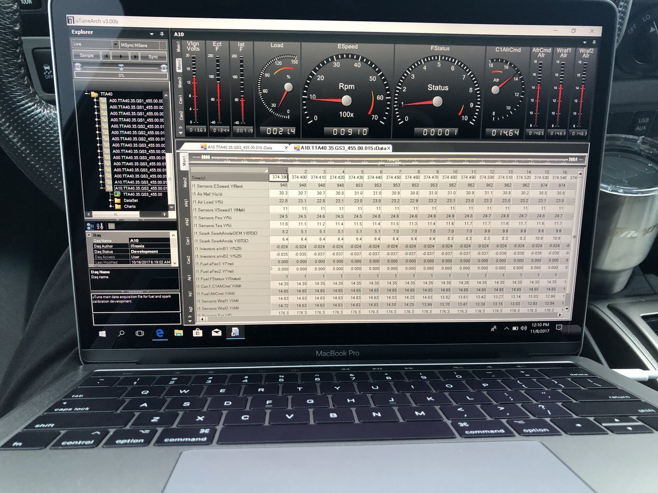

    I haven’t pulled the restrictor out yet. About to do that this afternoon.
    So circling back around to something that was breifly discussed earlier in the thread....Those of you running a Mac notebook vs. a PC.

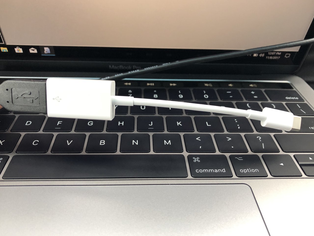

    My 17” Dell was having problems with the battery not charging and I decided to jump back to the dark side. I picked up a 2017 MacBook Pro 13”. The one with no USB 2.0 ports. This one only has 4 USB-C ports.
    So I picked up the Apple USB-C male to USB-A female adapter. Wasn’t sure if this would work with the UCON or not.
    I loaded up Apple Bootcamp assistant and installed Windows 10 Pro on the Bootcamp partition. Long story short, it works!
