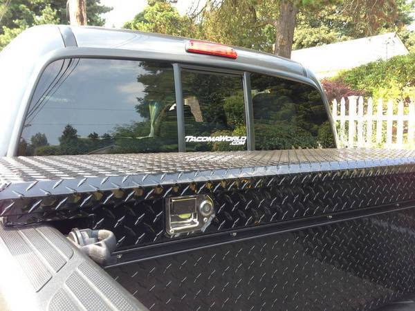

    I installed this sticker today. Thanks tcBob! :D

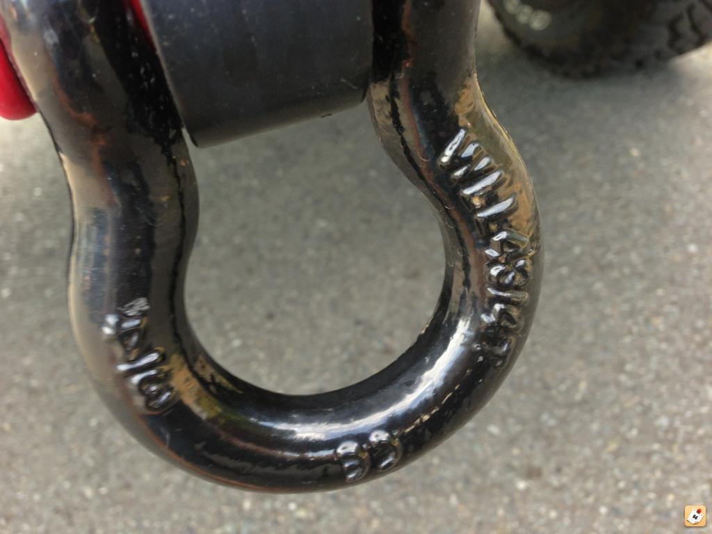

    I was looking at the BOLT lock you have and the receiver with D shackle. You said that its a CBI receiver and shackle.
    I am unable to find that brand/set up. What is the rating on it and where did you get it from..I was able to find a company CSI. I like the clean smooth look that your has.
    I would be interested to know here you got or a part number for the set up thanks. I already have the bolt lock, just interested in the receiver and shackle.

    Thanks man. I got it from a local 4x supplier. I don't have a part number. I think I paid like $40. The shackle is a 4-3/4 Ton (9500 lb.) wll rated. There is also a Smitty Built and some others that are similar.
