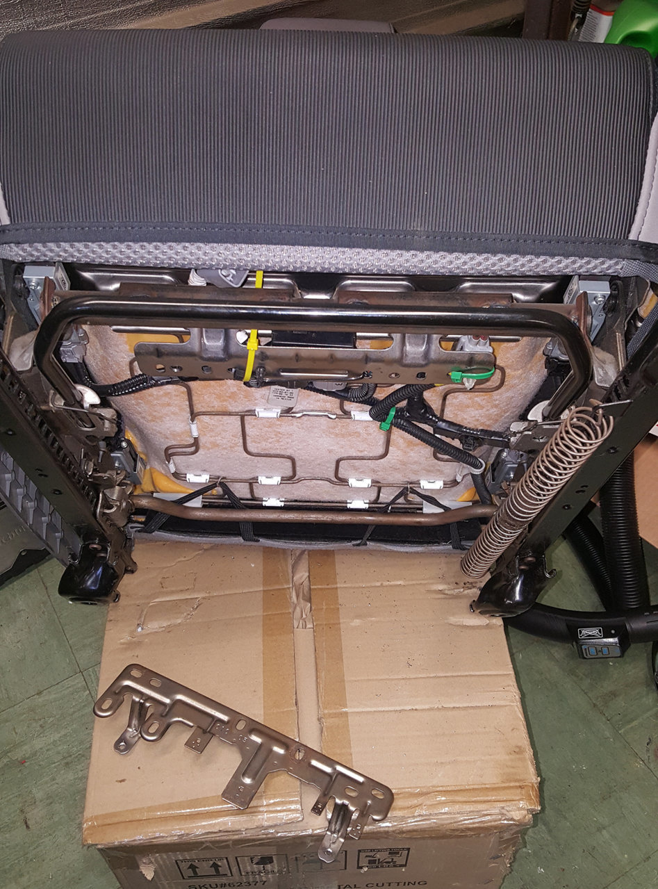

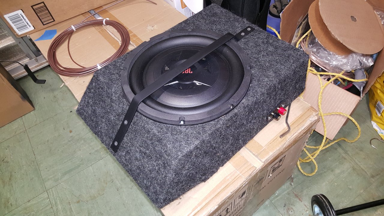

    I made my own enclosure for a 10" sub to go under the passenger seat. It is a JBL WS1000. Powered by a 500W amp under the other seat.
    Was not easy to fit it there. I had to raise the seat by about 1.5", rotate the cross-brace bar, relocate the SRS sensors and wiring, and bend the seat adjustment lever. Even then, the seat lost an inch or two of travel at either end of the track.
    Even with this hard-fought space, the enclosure was still way to small for the driver; the numbers came out to F0~60 Hz and Q~1.5. So I also made an active crossover for it to push it to F0 = 30 Hz and Q = 1, which is where all that amplifier power is going.
    To quote what I wrote in the build log: It is not particularly loud, does not rattle windows, and definitely won't win any idiot deafness contests. But it makes disturbingly low sounds at reasonable listening levels, which is exactly what I had hoped for.

    You might be a professional installer so I might be wasting my time with this: you can make the box act like a bigger box by putting pillow stuffing in it. Break apart small palm sized tufts of pillow stuffing and drop them into the box with the subwoofer uninstalled. You can play with the quantity of loose tufts and it will alter the sound. The stuffing slows the sound waves down inside the box and makes it act like a box with more internal volume.
    You can also port that sealed box and gain an additional 3 db.

    Definitely not a professional, just a hobbyist killing time and money. I added poly fill and foam lining where I could, but it was pretty funny how little material would fit. The numbers didn't work out for porting at all, not only in terms of frequency response, but also physically, there simply wasn't enough space in the enclosure to add a correctly sized port.
