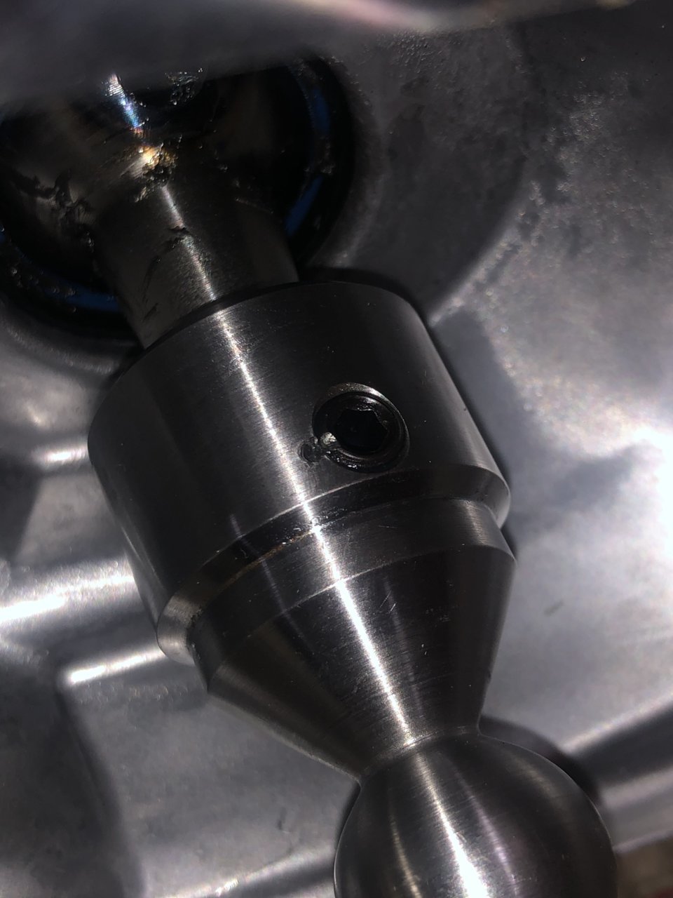

    Hey fellas did I set the screw enough ?!?!38BF56C4-EAC7-49FA-89F6-69834CE1ACD0.jpg

    Hard to tell from the picture. You don't need to dimple the set screw at all. The idea is to deform the steel into the hole to jam the top thread of the screw and prevent it from backing out.
    Edit* It might be easier to do 90 degrees from where you did where there is more material to move around. I did mine in a couple spots just for good measure.

    gotcha thanks,,,install was a breeze with my kit,,,seems theyve figured the issues,,downsized there kit as well,,two bolts and two studs,,i did use tin snips to make my life a little less stresful lol ,,,the new ball slid right onto clam shells,,tapped a couple times with rubber mallet for good measure,,there was no exposed shells at all,,shifting is very solid and direct,,reverse is no issue whatsoever,,, so far lovin it,,this along with ovtune and accumulator delete and im thinkin shes gonna drive great!!!
