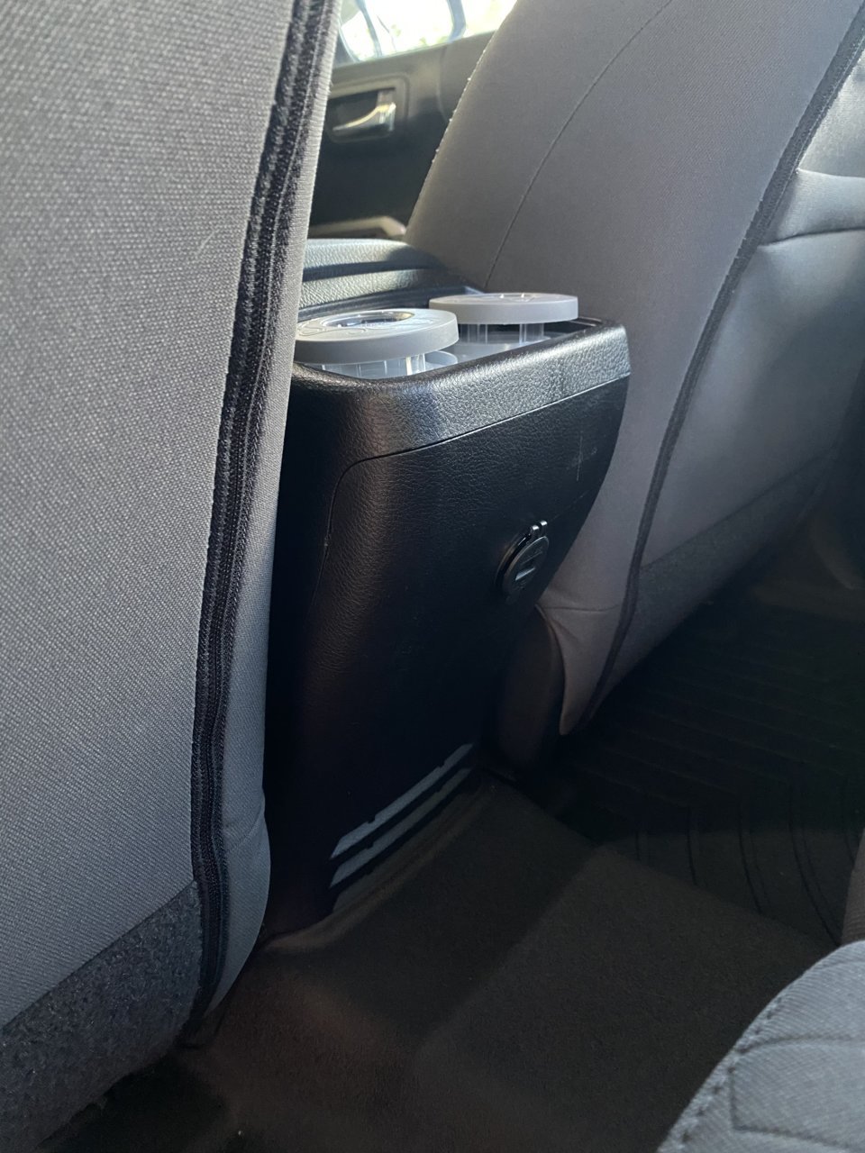

    Installed dual USB charging port for the rear passengers in my 2016. Simple install but routing the wire to the center console port was slightly challenging. It’s the little things!

    Pretty dark pic, looks like one port.
    Is it just charging or can you access music?
    How’d you splice it in to the front port?

    Sorry for the pic quality. Centered the assembly 3” inches below top of panel. It’s 1 assembly with 2 USB charging only ports. Connected the ground wire to a 10mm bolt securing a metal bracket located beneath the cup holders and spliced the USB power wire to the yellow wire on the cigarette lighter socket inside the console.
