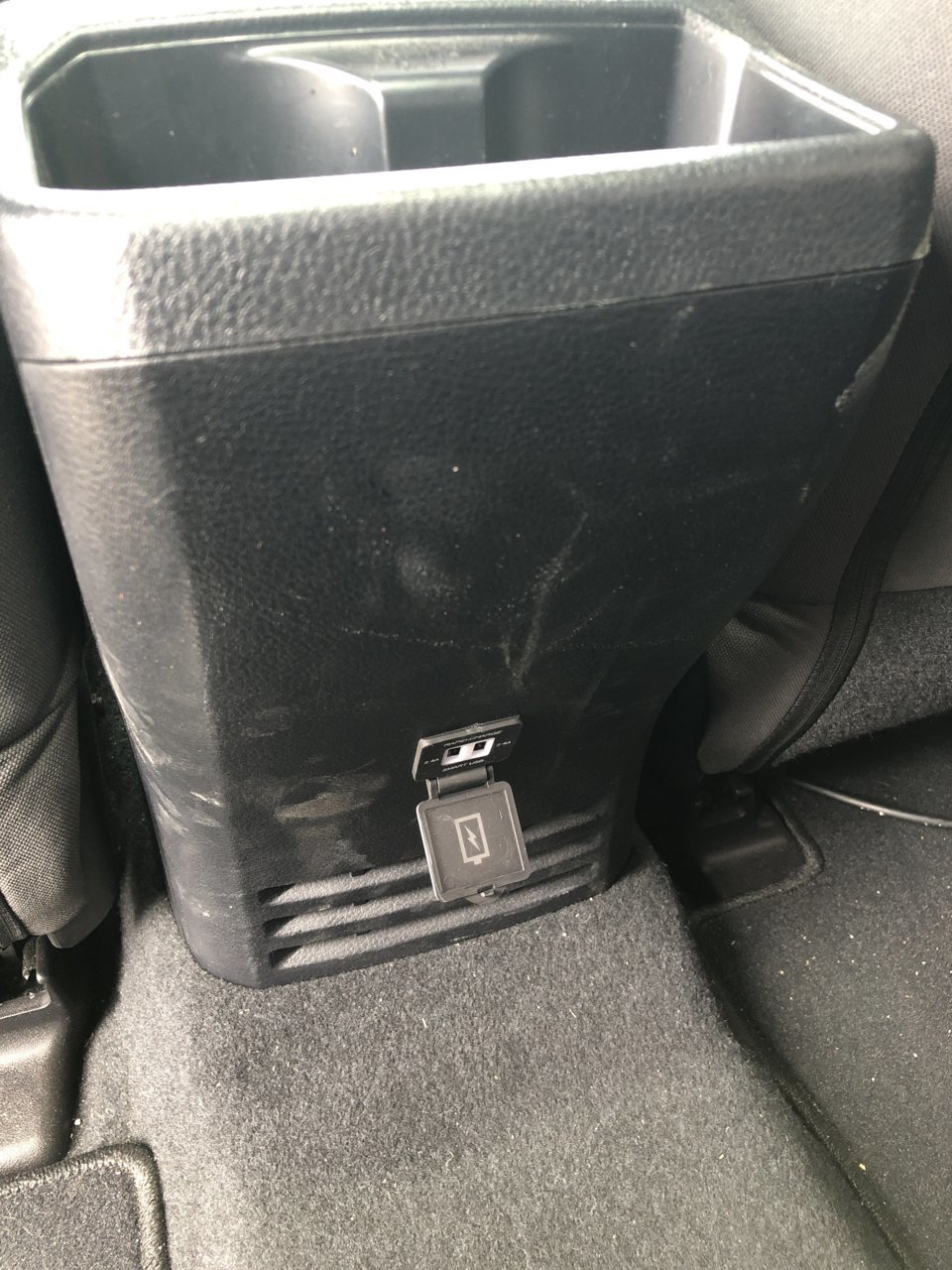

    My truck came with a dual usb on the back of the console.

    Your 19 should have 2 ports under armrest rated at 2.1A each

    That's a dealer add-on if it came with your truck. It doesn't come from the factory with those, just the ones inside the console.

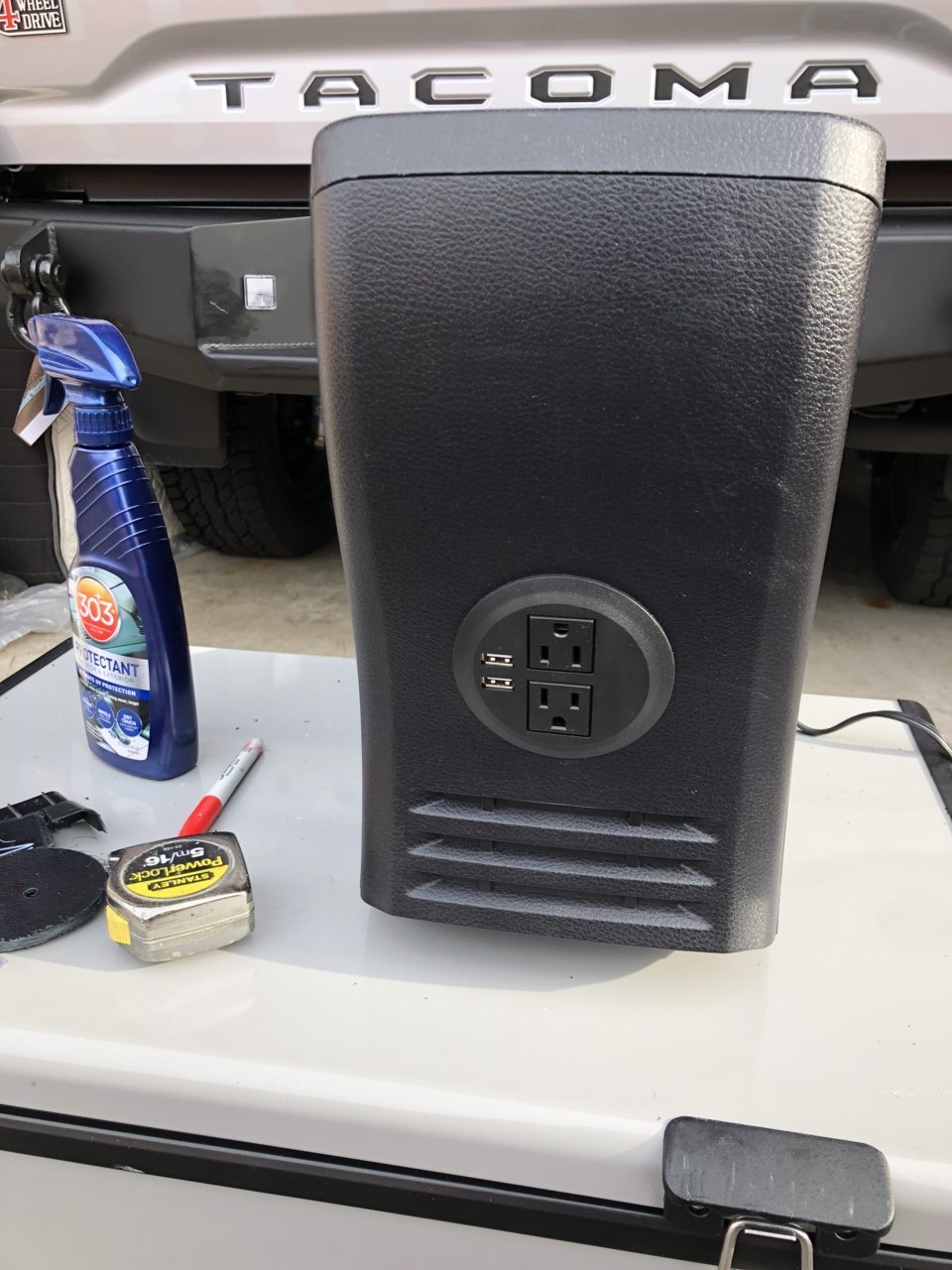

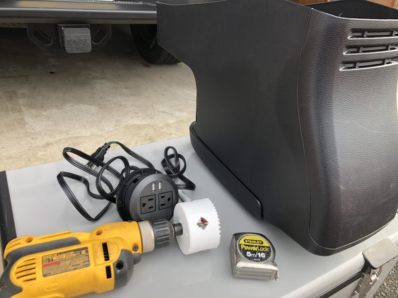

    Here's the original thread.
    https://www.tacomaworld.com/threads/3rd-gen-ac-outlet-in-cab-and-400w-anytime.505598/page-5
    I did the 400W mod and bought this below, spliced the AC grommet into wires after the converter, cut hole in back of center console, put everything back together. There's a ton of these grommets with different USB ratings, you don't have to buy this exact one.
    https://www.ebay.com/itm/Hidden-Pow...esktop-Socket-Ps-open-hole-3-1-8/223896938260
