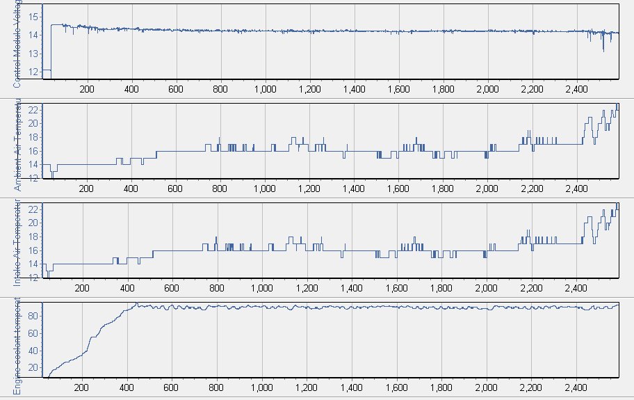

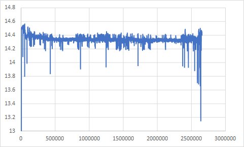

    It moves by the same amount (18mv) as the odyssey battery. I feel like we are overcharging these although I don't have a good sense of how the ECT compares to the battery temperature.
    Here's my voltage log over a 40 mile trip using these numbers only:
    I think I'm going to back off on them a bit and see if I can get it to taper to around 14-14.1
    FYI it was 60 degrees air temp when I started it up this morning.

    To be clear though, we are setting it off of engine coolant temp, not the temperature of the engine compartment. I'm going to borrow a thermocouple from work and see if I can get some temp measurements near the battery on my drive home.

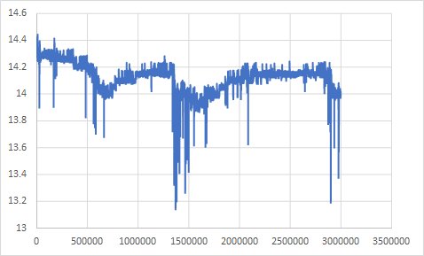

    I didn't have time to find our thermocouples with long leads so I can't answer that question yet. Hopefully I can find one tomorrow though and I'll tape it to the side of the battery for some pseudo science!
    Here's my settings from my 40 mile drive home (starting temp at 54 *F).
    Here's the log
    I like that it's hovering in that 14.1-14.2 range (I think), but I think the big jump between 30 and 60 may be too drastic and causing it to fluctuate more than before. But those dips also roughly correspond with where I hit some traffic so that could be where my coolant temps were highest..

    Your jump from 30 to 60 is a bigger jump than stock..
    What I’d personally do is take the stock ECT values and +4 to each one.. then you have the same taper as stock, just higher output. Thats similar to what i did for the duty cycles

    Ambient air seems to be outside temp. I also measured intake air just to see if it changed but it stays pretty constant. ECT's were steady at 90 *C. I did a gut check after my drive to work, 40 miles at freeway speed, battery was cool to the touch, warmer than the outside air but not much.
    Here's the log
    So in my book the most important values to set based on the ECT are 0 to 90. I would base the values you use there more off of what your typical weather is and not what the ECT is, targeting a voltage of 14.3 or 14.4 if you live in a hot area, and 14.5-14.7 if you live in a cooler/cold area. That would be for optimal charging. I think if you generally target 14.3-14.7 you will be safe and get good life out of your battery.* A modest taper at higher temps is probably a good idea but I don't think it's all that likely unless you're prone to overheating. At lower temps, you can probably increase it but it probably doesn't matter because your engine will still warm up relatively quickly. But again, I'm not a battery engineer.
    *ETA: This depends on the optimal charging voltage for your particular battery.
