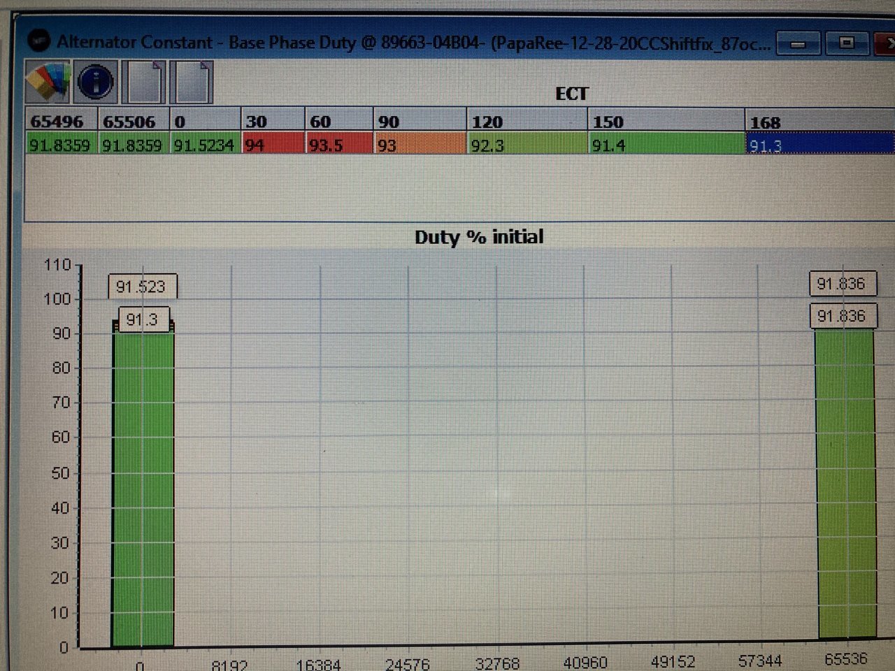

    Are these still the numbers you are running? I assume they would translate to 04B04?

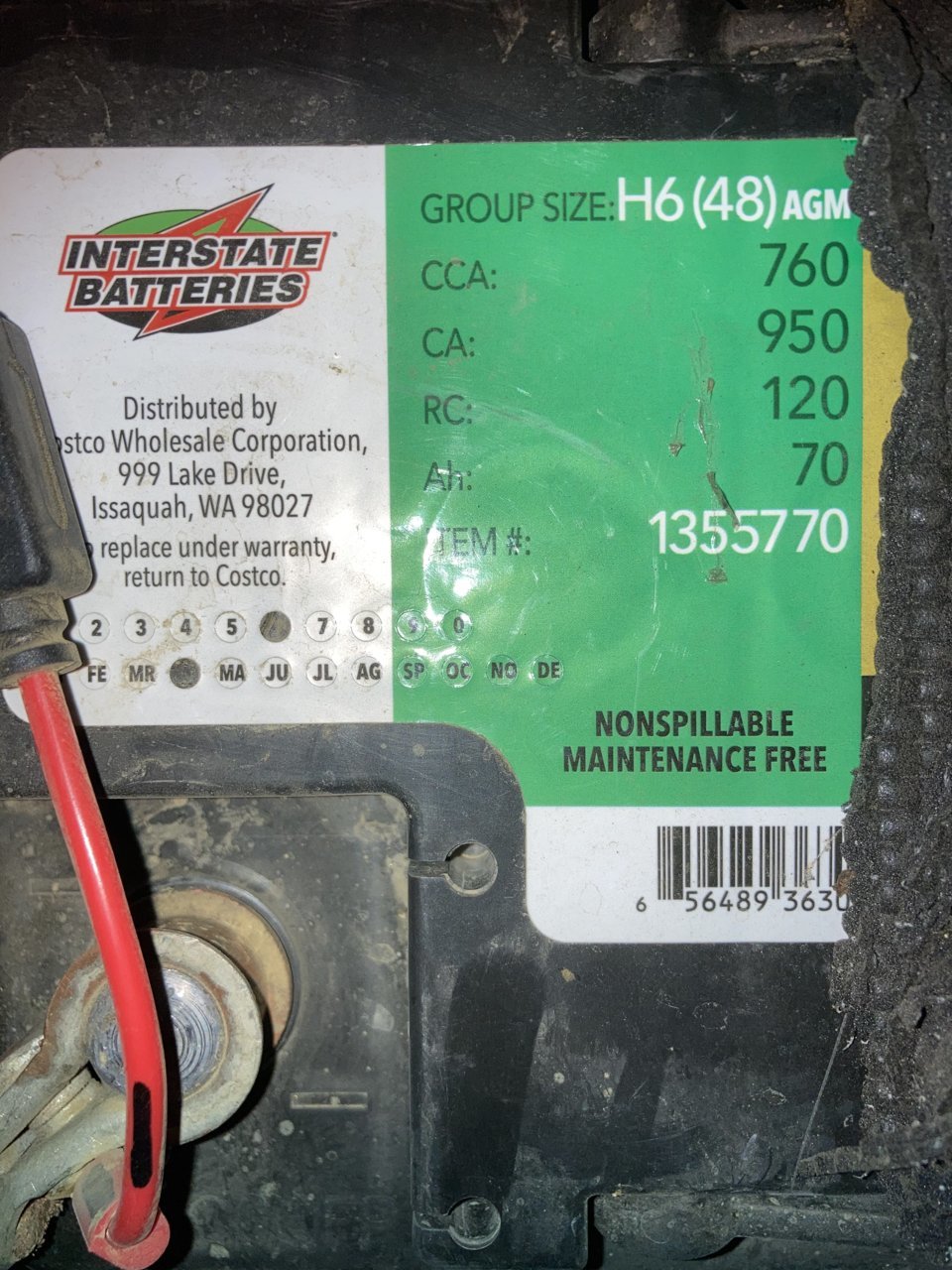

    ive looked everywhere and have had no luck regarding this battery
    I even called interstate and they didn't know...wtf? :annoyed:

    Did you do this without changing any of the Phase Duty cycles from stock?

    yep. Just that table you see was adjusted

    I am using @PapaRee new M+W 04B04 he adjusted and that thing rocks so far

    Thats the one that I was tweaking just now. I am going to try it with just the table you showed adjusted and see what it does.

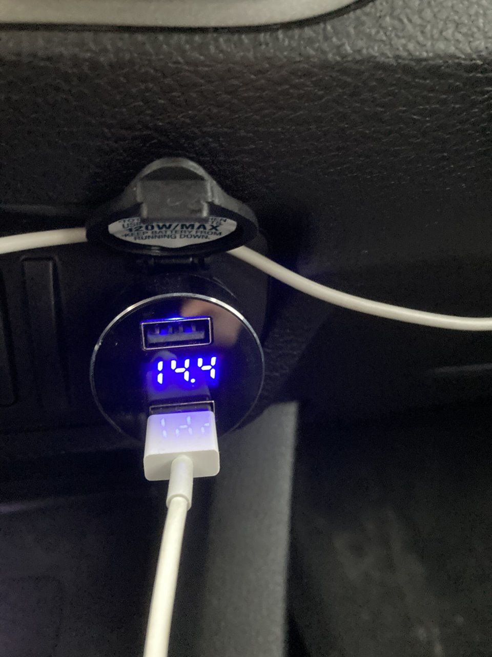

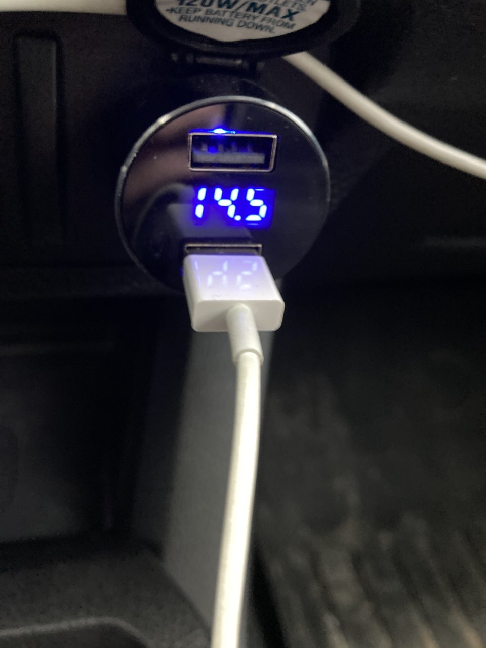

    running these values I am getting 14.3-14.5 consistently.
    this gauge is pretty accurate and reads .120V lower than what the flash tool does (as I’m flashing a tune it’s in the 12v range of course)
    this is while driving with engine warmed up:
