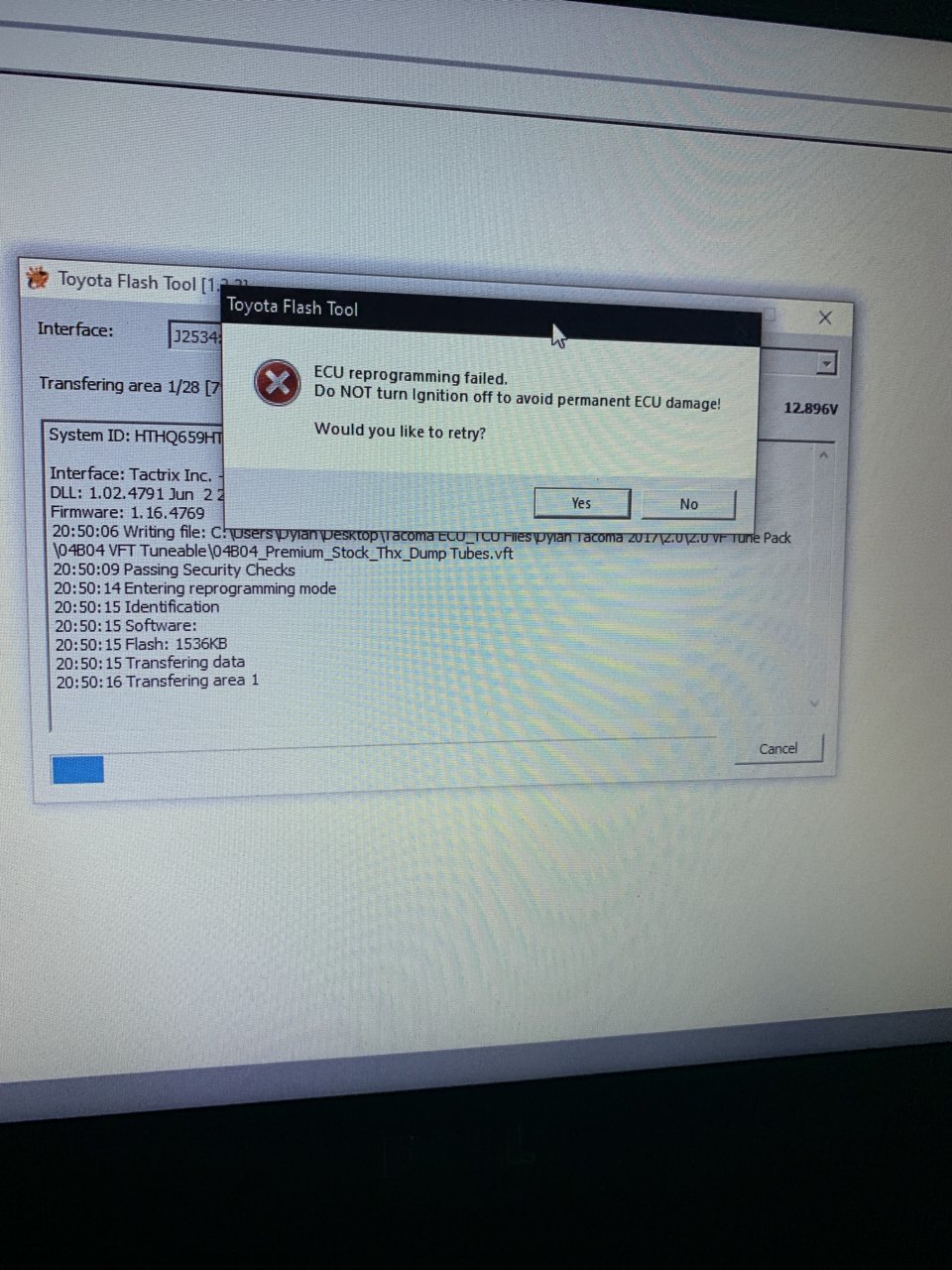

    Finally got through making a new tune for my dump tubes... failed. Truck won’t start. About to jump it off and hope it’s a damn voltage issue....

    OVTune
    OVTune Well-Known Member
    Mar 27, 2017
    #214557
    8,112
    OVTune
    What Ecu version?
    Failed flash, or flash success?
  8. Sep 19, 2020 at 6:51 PM
    #4848
    Tac0Tic0
    Tac0Tic0 новий член
    Sep 26, 2018
    #267519
    1,098
    SLC, Utah
    17 TRDOR QS
    OVTune Volk TE37XT 17x8.5 295/70r17 G003 Yukon 5.29 differential gears Cab Mount Relocate Icon Coilovers Icon AAL Uptop Overland Bed Rack Maxtrax Baja Designs Squadron Pro Ditch Lamps Rough Country Speedometer Calibrator
    04B04
    tried several times. Went back to a stock 2.0 file.. same thing
    Tried it in both VF and the flash manager.

    I don’t want to have to open a ticket, but all I did was create a file with the values for dumps set to zero and now I’m stuck.. can’t even go back stock
  10. Sep 19, 2020 at 7:03 PM
    #4850
    OVTune
    Mar 27, 2017
    #214557
    8,112
    OVTune
    try this >
    shut truck off. unplug battery, wait 5 - 10 mins.
    then try to flash, click "flash it" and select the file
    do NOT press identify.

    no luck. Tried it, made it to 3%, 26%, 5%

    OHHH SHIT!!
    Hopefully you get it. Help this man Mat!

    I have my wife’s 4 runner I can take to work tomorrow but yeah..
    appreciate it

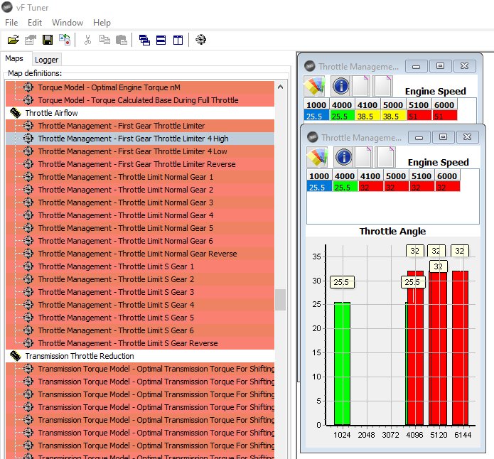

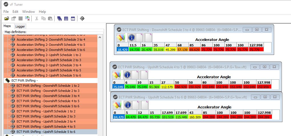

    Is there any benefit to making these linear? starting at the lowest value staying the same and making the highest value 100 and Ctrl I the whole field? Or is changing them all to 100 really the least limiting and overall best case scenario?

    So this does not act like the throttle limit 1 through 6 tables correct? It just gives the throttle the ability to open all the way... It's not like a pedal commander turned to 50 out of 10 right? You found setting all the values to 100 successful? Do you see any benefit to setting the final value to 100 and Control I the whole field? Will I reap the same benefits being a slush box?
