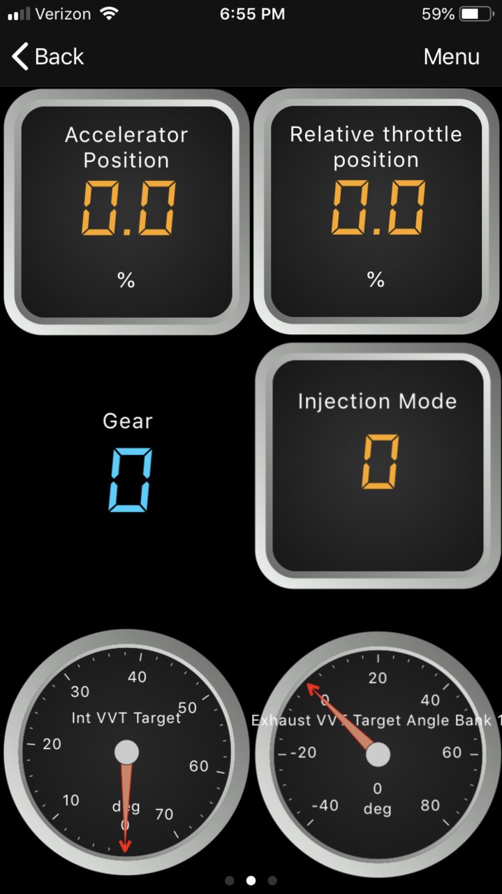

    Yes.
    Monitor PID status of the shift status for current gear. PID accelerator position for accelerator position.
    Lots of good stuff you can monitor in real time.
    My dashboard looks like this:

    Any chance you could share a link to a reliable bluetooth adapter?

    Yessir. You're mainly looking for an ELM327 clone.
    Mooseditty17[QUOTED] likes this.

    It's pretty cool, but like vlady said earlier, there is a delay so you aren't getting instant information. For that you would need techstream.

    I have the carista bluetooth with obd fusion. You will also want to buy the Toyota PID pack.

    Maybe mine is just slow. With techstream hooked up, it is way faster.
