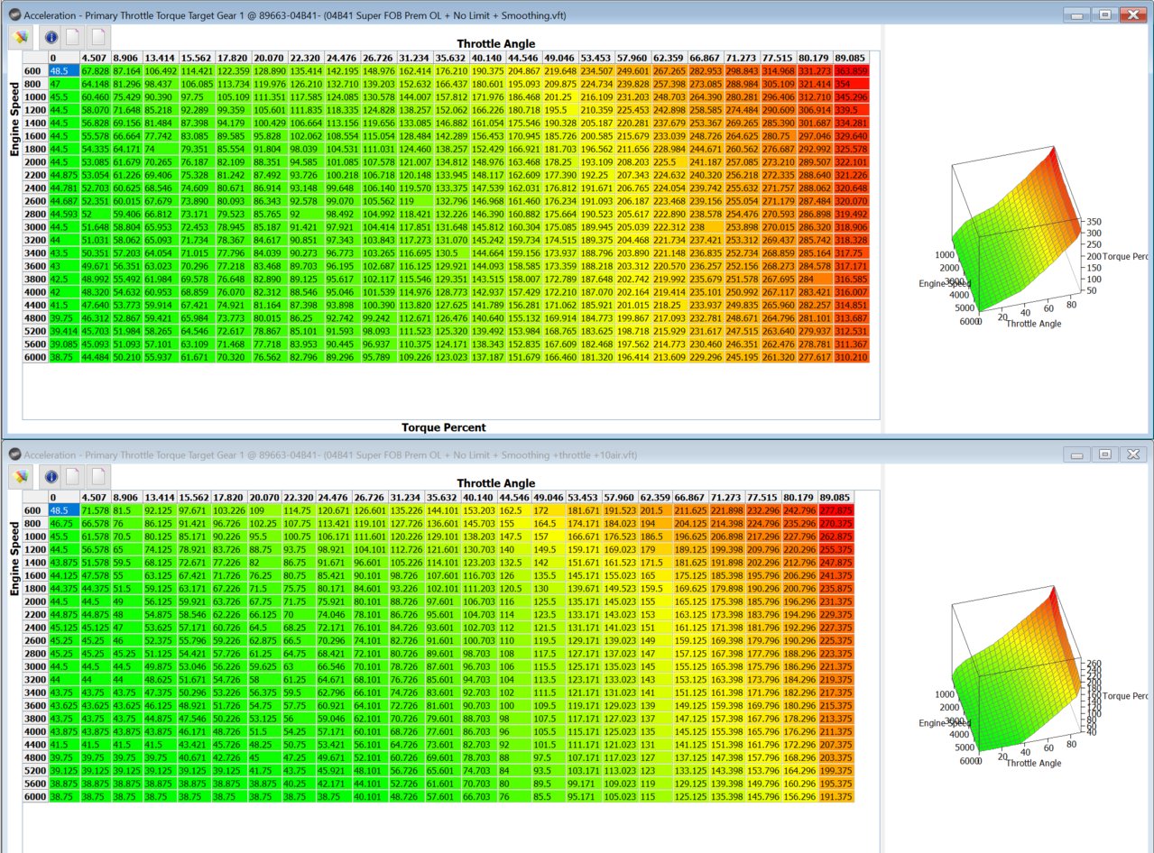

    92ehatch
    92ehatch Well-Known Member
    Jun 9, 2019
    #295818
    841
    Kinley
    Hendersonville NC
    2019 Cavalry Blue DC TRD OR 6MT
    @tonered Here is the comparison between Matts first gear and toyotas first gear. You can see that at light throttle, the torque percent is higher in Matts, its pretty linear.
    The difference between my ride into work and back home were night and day. So subtle changes here seem to affect everything quite a bit.
    I like Matts acceleration when im trying to get going, it just doesnt hit home for me in the light throttle areas.
    Factory though, just like before being tuned, has a very sluggish and spongy feel to it, especially once you cross into 2k+ rpms. Im going to focus on trying to balance that.
    I plan to start with the primary, making it linear, then adjusting the 1st gear table to dial it into what I would like
    Ignore the file names, they are modified files but with the correct maps from what i referenced
    Top picture is Matts file, bottom is toyotas
    tonered likes this.

    That is a pretty subtle difference with most changes up top. It sure looks like OVT's map max values are just an interesting coincidence on the engine torque rating.
    It sounds like you are close to solving the problem though. Good work!
    You are right. Just a small amount of tweaking here makes a larger difference than expected.

    well....i managed to get it to open the throttle all the way........in first gear....its aggressive for sure.
    I also got it to open all the way in second gear at around 3k rpm (throttle to airload map increased twice by 10%, without letting any numbers go above 89.)
    I managed to get the smooth acceleration with low throttle pressure, but brought back the jerky problem when under very very light throttle (relative reading between .5 and 1.5)
    I noticed in my other logs that the throttle does not close beyond 13.7. This time at 2300 rpm with 0 throttle, the plate was sitting at 18, so quite a bit higher than previously.
    tonered[QUOTED] likes this.

    Yes. The throttle will report higher numbers with high revs. Higher full flows also, even though Fuel Status will say DFCO.
