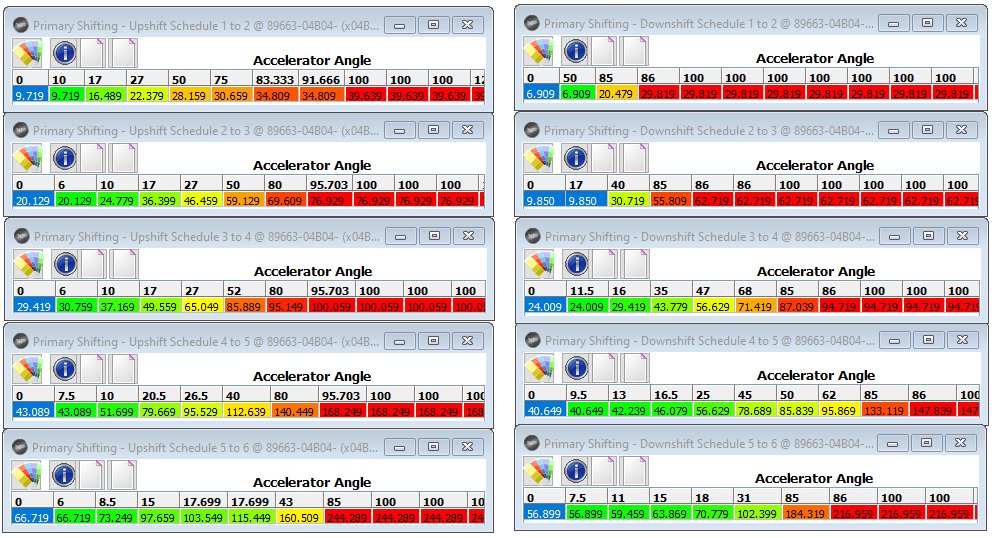

    Ovtuned
    I just copied these shift points in my 04A61 2018 and man the truck feels great. So nice cruising around at 30-35mph in the city at 1500rpm instead of 1000rpm like it used to and lug. I changed everything to the same values you stated except the throttle points %. I upped my only 15% since I’m still on stock tires and not much added weight. Feels about right for my liking, but after it settles I may go 20% to see if it’s a big difference.
    When upping the throttle points percentage the higher values go above 100. Is that fine to leave them at that or should I just adjust those down to 100 for all the ones that exceed 100? This is my first attempt to adjust a map on VF Tuner so I’m still trying to figure everything out.

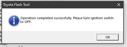

    I just had a flash fail with an error about data corruption... weird.
    I closed everything, I'm going to launch p5 from vf instead of standalone which is the only difference i can think of. :goingcrazy:
    Now to wait 10 minutes until VF opens :D
    Note: I tried 2 different files, both failed. One had previously flashed successfully a week or so back

    You cannot flash VFT files from the FM Flash Tool. VFT files can only be flashed with the vF Flash Tool.
    I believe that @Shellshock said that the vF Flash Tool executable can be found in the installation folder ( \Program Files (x86) \ vF, or something like that?), so that you don't have to launch vF just to use that Flash Tool.

    All good homies - lesson here is to open the flash utility from inside of VF.

    Makes sense - i noticed it was looking for encrypted files when it was flashing from the standalone launch.
    i searched in windows for flash manager and it was the first one that came up :)
    I'll create a shortcut on my end.

    Yeah. If you want to flash vft files YOU MUST use the vF flash tool (c:\program files (x86)\vf tuner\)
