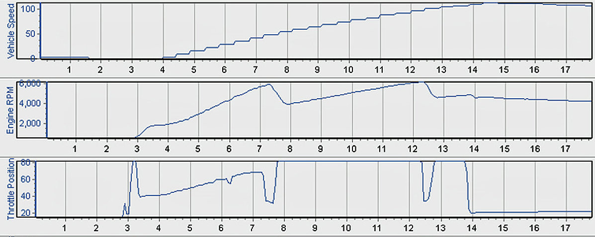

    I get about 85% second gear and up, which is great. First gear starts at about 40% and ramps up to about 70% at 6,000 rpm with the pedal floored the whole time. I might be wrong, I thought these numbers were throttle degrees, not percentages. Not that it matters, either way I know what you are referring to. :)

    This it what it is doing.

    oh. Then yeah check out @tonered thread. He’s been our guinea pig
    I removed the limits on mine and noticed a change for sure. I haven’t logged though
