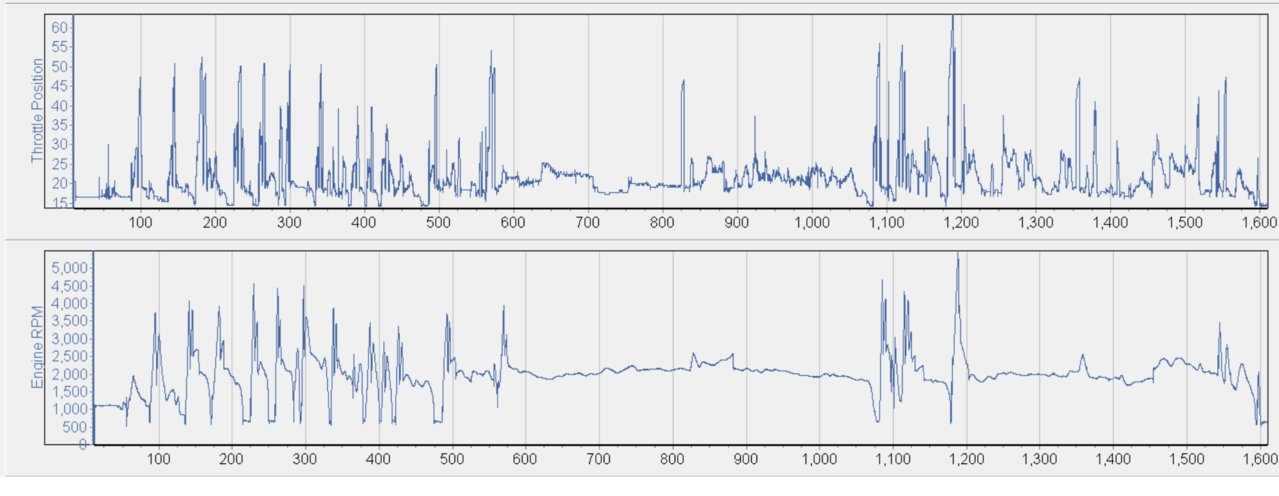

    @tonered
    My throttle seems to be limited by rpm.
    You can see that i have plenty of attempts to get full throttle , looking at the 800 to 900 range, this was 4th gear full throttle, only reached about 45
    At 1200 i had a full throttle run in first and it reached 60 something but its the highest RPM i got to on this drive.
    @OVTune are there any specific things you want in a log to see what is going on? ill be happy to log tomorrow on my 4am drive to work.
    su.b.rat and tonered like this.

    Thanks! So, we would expect to see 87.5% on the throttle plate as evidence of full torque?
    There is a Data List in my TS V14 download link which includes the PIDs that OVT wanted in the old days. Of course, it logs in TS. Credit @mZiggy !
    The new version of FM has all those PIDs ready to go and spits them out in the CSV file. I only tried it once (it might be what your are using?) just to verify that it worked. It was much easier.
    su.b.rat likes this.

    92ehatch
    92ehatch Well-Known Member
    Jun 9, 2019
    #295818
    841
    Kinley
    Hendersonville NC
    2019 Cavalry Blue DC TRD OR 6MT
    It is what im using. It spits out a CSV that you can then open back up in VF and you can cut out unnecessary sections to kind of "blow up" areas if you wish too.
    I cant find the PID that shows the actual throttle pedal vs throttle angle.
    I found one called relative, that i thought was it, but it was the one showing input even though i wasnt touching the trottle. I tested this by taking off from my house without touching the gas pedal.
    I never touched the pedal, but the truck gave a trottle increase command (im assuming as RPM dipped and raised)
    tonered[QUOTED] likes this.

    email me the file that created those throttle limits
