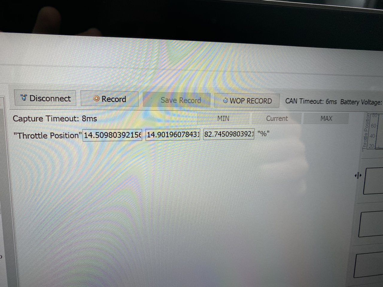

    Kings 2.5 with adjusters, icon rxt stage 2. SCS stealth blue on 35s
    So just raising to 5k this is what I got 82.7 at full throttle. I believe mat said 85 was max correct? I will post my next finding with the air load and expected air load adjusted
    This is on moosditty17 latest premium oct tune
    Mooseditty17 and PapaRee like this.
    Tried my air load changes. Just changed tip in still got the 82.7 throttle! I will post changes if you want the feel of 1.5 performance tip in
