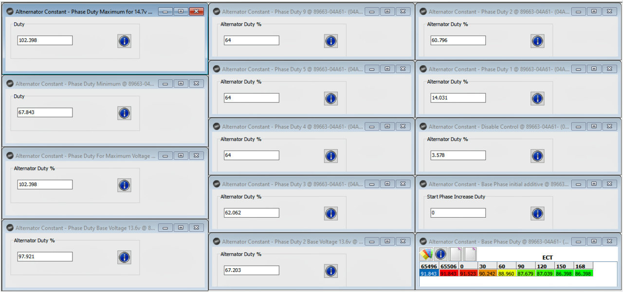

    Bit of feedback, doing values that matched what @banjoist13 mentioned for 2016-17's on my friend's 2018 brought him up only to 14.1-14.2, and then floated down to 12.8 once warmed up, when it needs to be in the 13.5-13.8 range. So I reverted back to what @Shellshock does for AGM and just raised everything by flat percentages and got 14.4, waiting to see what it'll float at.

    I’m getting 14.5 at idle with these values. My battery is an interstate AGM H6 48

    When starting and driving for a bit. I have a voltage reader in the cab and it matches my multimeter at the battery.
    Running any new 2.0 or variation when I edit the values to what I posted

    Raise everything by 20 (except phase 1) and set the values to 94 from 30 and up

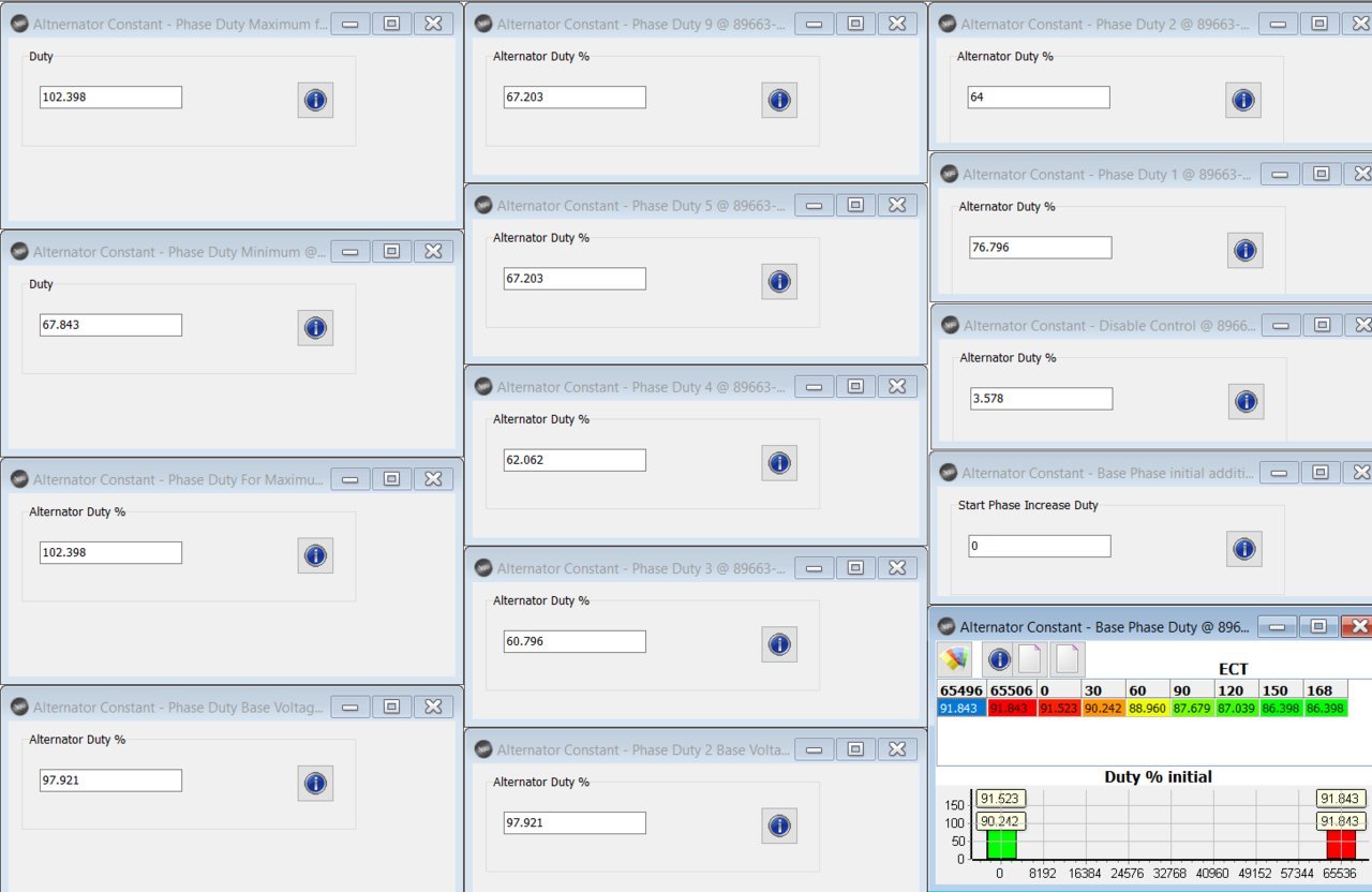

    Do those settings allow the ECU voltage to drop as the engine heats up? It should drop to around 14.2 v at the highest engine temp.

    Try bringing up the first three values in the base phase duties .25-.5 and bringing down the rest by .25-.5. This will take a few iterations to fine-tune.
    I have been working in changes between 1-.25 to adjust how the output max changes based on engine temp

    Mine sits consistently at 14.4-5v. If you want 14.2, use 93 instead of 94.

    For my truck it sits at 14.56-14.26 depending on engine temp with my numbers. I am ultimately trying to optimize so I don't stress any electronics, batteries or otherwise. I wish we had a bit more info on what exactly the other numbers actually do so we could be more accurate in following the optimal voltages.
