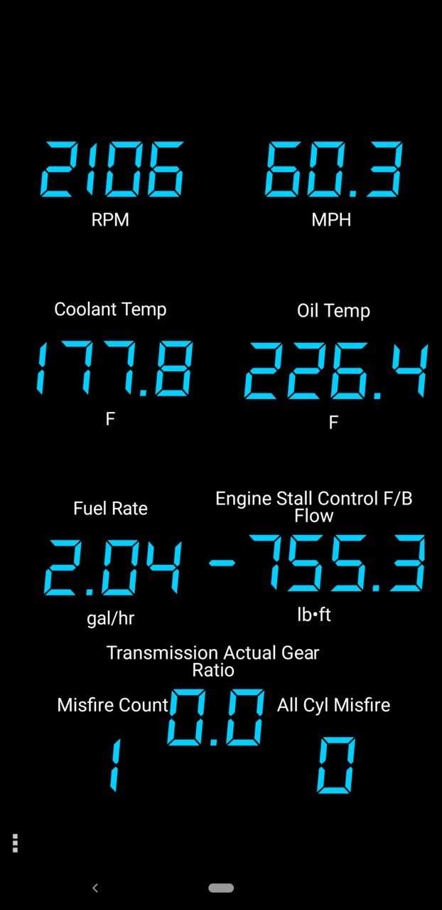

    Hey, @OVTune .
    I confirmed this!
    Check out the Revs and the Engine Stall PIDs. Every time the revs dip below idle-ish, that Stall gauge heads toward positive.
    Do you this can help kill the AntiStall function and fix DFCO in 1st gear? If found this in OBD Fusion under the Toyota specific PIDs for the engine.
