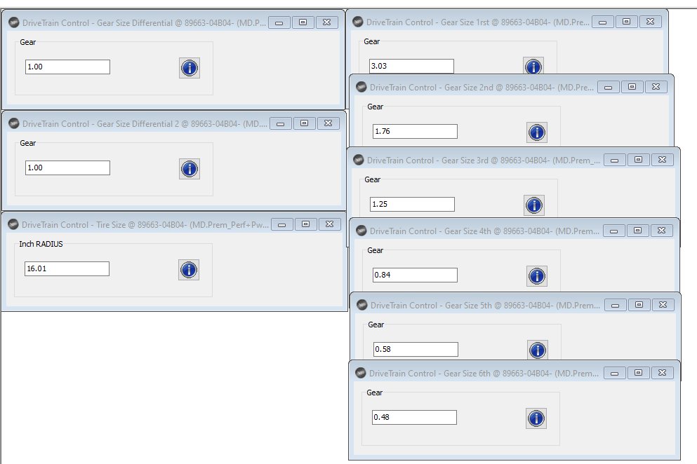

    is this the spot you change the gears and tires? Reason I ask is because I open this and gear 1 is 1.00, Gear 2 1.00, and tires 16.01....
    I assume I am looking in the wrong spot, but wanted to confirm the file was for 4.88's and 32's. Thank you sir

    Tires sizes are in radius, not diameter. The "gear size differential" and "gear size differential 2" are the ones where you can change the R&P. Dont mess with "gear size differential reverse".

    gear 1 and 2 say 1.0 for the value

    You need to look in "Gear Size Differential" and "Gear Size Differential 2"
    Don't mess with "Gear Size 1rst" or "Gear Size 2nd"

    Those are not the ring and pinion maps. Check "gear size differential" and "gear size differential 2"

    hmmm, well @PapaRee 's last file I used was the same except for 33's according to him. It ran pretty good, but held gears a bit longer than it should on the highway. What would be the correct setup for the 4.88 gears and 32" skinnies?

    Gear Size Differential - 4.88
    Gear Size Differential 2 - 4.88
    Tires Size - 16.00

    what about the individual gear sizes for gear 1-6? Are those correct?

    I have never messed with those so I cant say for sure. Let me grab my other computer and see what it shows on the tune I am running.

    FYI, I am 5.29 on 35s so make those two the 4.88 and 16.00 like I mentioned before.
