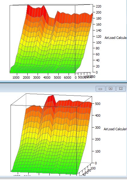

    The maps are airload control - control airflow and airload control - expected airflow. Here is what the stock maps look like:
    Those dips / humps cause a drop in airflow around 1200-1600 rpm. Making the maps look smoother by using the ctrl+I interpolate function helps with this. Supposedly. Because I just opened up my file and apparently I did not save my work, which means it did not flash to my truck. So I guess I got placebo'd :anonymous::annoyed:. Anyways the rest of my tune is running nice, lol.

    It occurred to me the these maps look sort of like the inverse of one another.
    i.e. where one has a peak, the other has a trough.
    Maybe they are used together and means the output is 'smooth'.
    I didn't notice any difference after changing them. It certainly didn't give 100% throttle; which, I'm still not convinced would make a difference... I compared a few 1st and 2nd gear full pedal logs where the throttle was and wasn't 100% at various rpm... the airflow was nearly identical. The throttle appears to give the engine as much air as it can take, except...
    Where the throttle is apparently limiting airflow (briefly) is just after the initial stab of the pedal... it opens, closes some, then opens again... it only appears to limit the airflow for ~150 milliseconds; so, it's not like removing that is going to significantly improve everyday performance.

    Yes as inksin posted, OVTune has said they are the inverse of each other. But, we are still in the dark as to exactly how the ECU uses them to calculate throttle.
    I think it makes sense that the ECU doesn't give full throttle at low rpm. My testing is showing I can get 100% load at low rpm, which if I understand load correctly, means the engine is already flowing the max capacity of air that it can at that rpm. Opening the throttle further would not get you anything.
    The other thing I have noticed just as you stab the pedal, is that in a lot of scenarios the intake valve immediately retards (further into atkinson), then you need to stab the pedal further to get more throttle, advance the timing, and sometimes a downshift. I have a tune ready to go with advanced intake valve timing which I am hoping will fix this; but I'm not sure I want to flash my truck given my limited knowledge of tuning timing.
    The hole in the map at < 50 load and < 2400 rpm is what I want to address. I am considering making all values at least 18.559.
