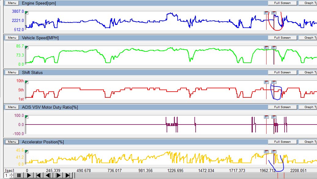

    Sometimes it will shift to 5th within a few seconds unless it’s a pretty steep hill then it will stay in 4th until it’s over the hill. Also if it stays in 4th all the way over the hill I’ll have to let off like you said for a sec then it will shift. It’s weird how inconsistent it is.

    Make the acceleration shifting tables match your regular tables. I believe the acceleration tables are used along with the inclinometer in the truck and in high load uphill situations it locks out overdrive almost completely. The same way the acceleration maps are set up. I haven't tested this since I'd have to go out of my way to test in that condition but thats my educated guess at this point.

    So by raising the half lock value for 5th the truck now unlocks and goes into half lock instead of skipping all the way to 4th. Sounds like it would be much smoother and help eliminate so much hunting, but is there any noticeable increase in trans temps?
