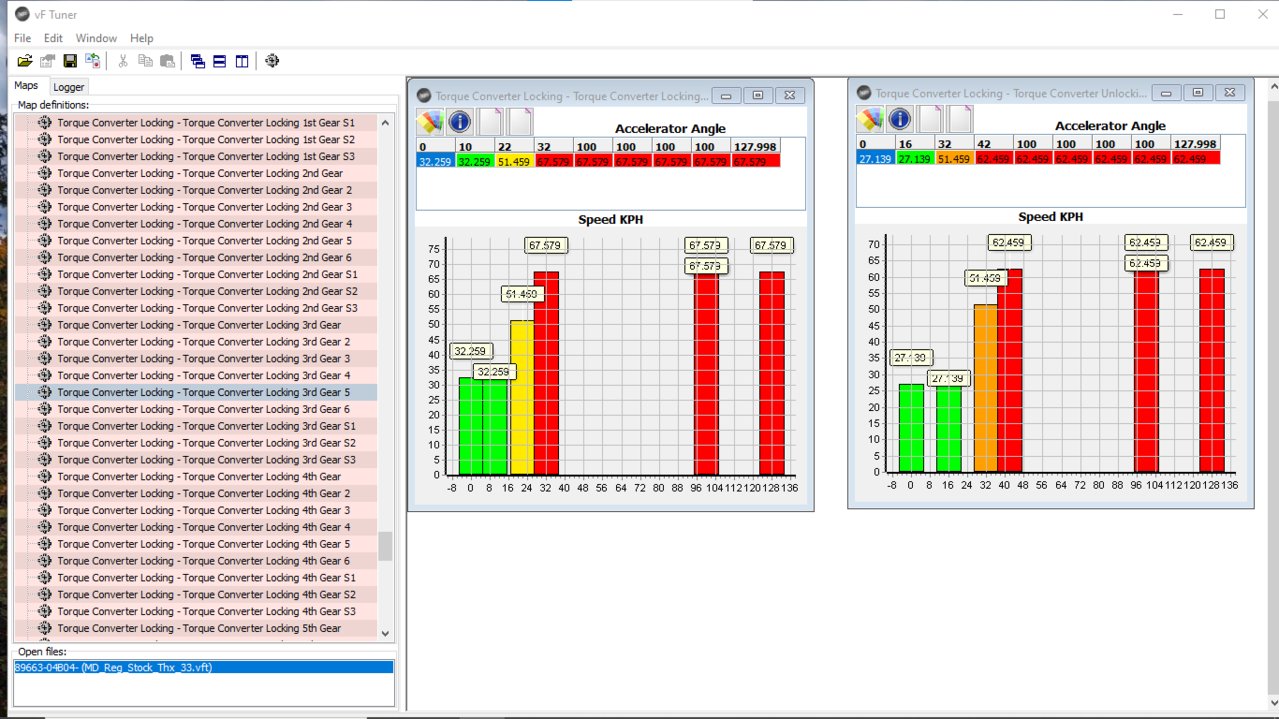

    For anyone that liked how the new 2.0 tunes shifted, but want more out of your throttle, give this a go. It's 04B04_Reg_Stock_Thx_33 but with all the power and throttle add ons that can be found on the MD.87 Mild and Wild 3.1. Tip in is sporty, but manageable. All shift points and TC values are the same as OV intended, but I eliminated 6th gear in ETC Pwr. Who tows in "double overdrive" anyways?
    I'm guessing this will get better mileage than 3.1 as there's less revving between shifts?? (Theory)
    I have NOT run this file so let me know if it's awesome, or if it was a waste of time. Thanks.

    Has anyone tried, or willing to try, plugging 3rd gear tc lock / unlock 5-6 map values, into maps 1-4 and see how that feels? Put half lock at 255.999 and plug the 5-6 values into 1-4. Looks like it might have potential? Today is a sh*tty day for testing in the Northwoods...TC 3rd gear.jpg

    Will try today AJ!
