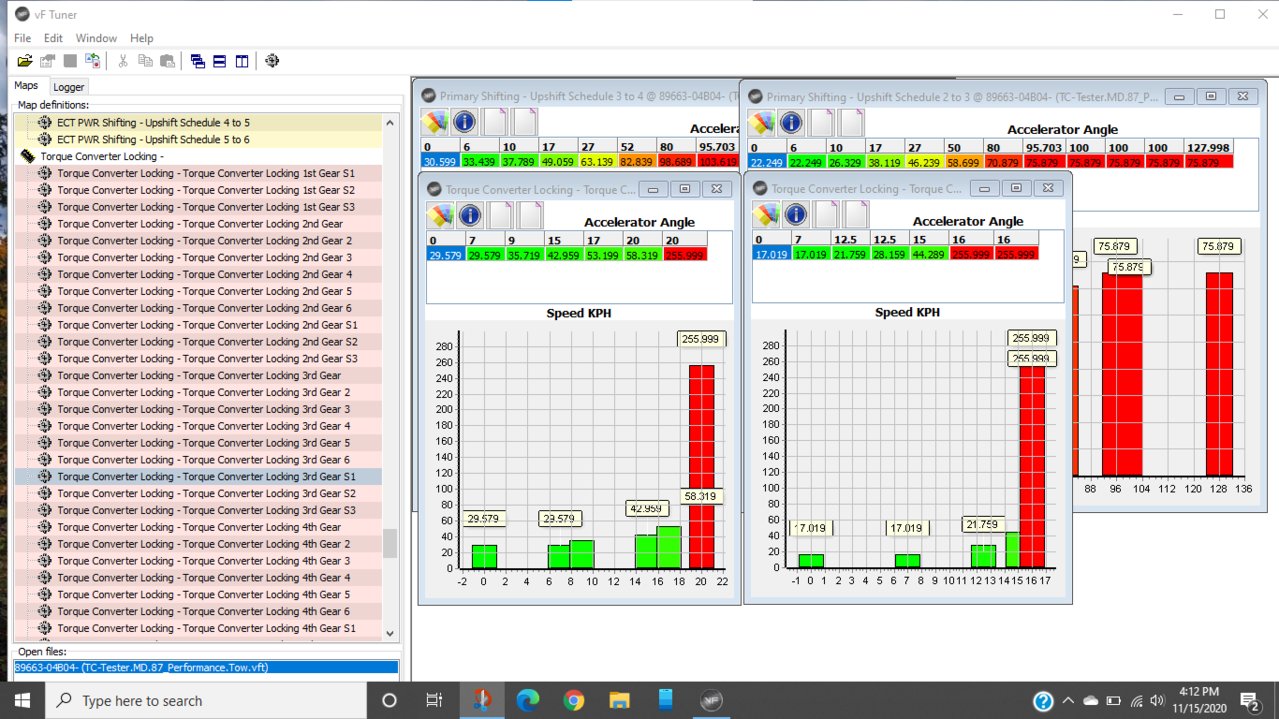

    Looking for input on Torque Converters. I like the way I have 4th gear slip lock engaging and disengaging. I can't stand 3rd gear. Looking at the axis values just blows my mind and I get real frustrated, REAL FAST. Seeing as we can change those values now, would it make sense to:
    Change 3rd gear slip lock axis values to match 4th gear slip lock. Then take the difference from my minimum shift points to the minimum lock up on the 4th gear slip lock and transpose that to the 3rd gear slip lock. Then whatever number value I raised the minimum I'd do the same for all the other values, IE: add 5...
    Then do the same with the unlock values. Copy the axis and subtract the difference from my lock to unlock for 4th and to that for 3rd.

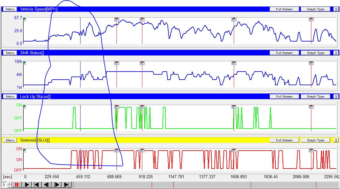

    Is there a way while logging, with either TechStream or vFTuner to mark a specific situation? Lets say I'm driving along and I see the TC lock is still on but I'd really like it to unlock for it maintain momentum without a downshift. Can I mark that point so I can go back and change things?

    Here's my thought to simplify this situation... In this example lets say I shift into third at 22 mph and into 4th at 33 mph. I'd want my truck to "lock up" shortly after shifting into third. So we'll say 25 mph. I then raised the remaining values to correspond how 4th gear was set up. To make the unlock make more sense, I changed the axis values to match lock. So I'm driving along... the truck shifts into 3rd gear at 23 mph at 6% throttle. At 7% throttle the truck locks up at 25 mph. I press the pedal further to 10% and the truck begins to accelerate to 36ish mph. While accelerating to 36ish mph I encounter a hill. While maintaining 10% throttle the truck begins to lose momentum... Once the speed gets down to 21 mph the TC unlocks and I begin to regain momentum. This is correct, no? Or should I start writing short stories? :confused:

    Yes, you can do it with techstream. Not so much with vF.
    In techstream, use dual data and select engine and tranny. Some of those solenoids that control slip lock are under tranny CU.
