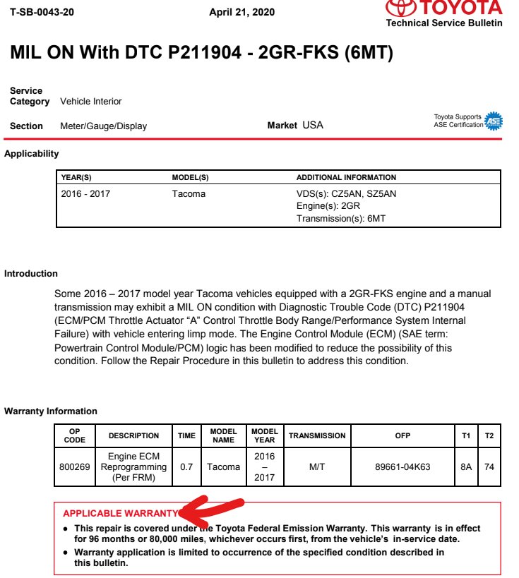

    Trying to get dealer to upgrade the ECU. Seems like they have no idea. I have requested to have it upgraded to 04B14 and they have come over with a couple print offs of one upgrade for surging at idle and another for throttle performance and have asked me a few times what I’m looking for. I do not have any faith this is getting done properly...should’ve waited till I got the tatrix cable and saved myself $150 I know they are likely going to charge.
  14. Nov 23, 2020 at 6:50 AM
    #8294
    tonered
    tonered bartheloni
    Sep 25, 2017
    #231055
    31,247
    tony
    Lynnwood, WA
    TSBs are free and these are applicable to the longer powertrain warranty.
    It doesn't matter what symptom they qualify it under. As for confidence, it is literally hitting one button and following the prompts which are basically, turn the key on, turn the key off.
    Also, you have vF then you have a Tactrix already, right?
    ihatemytruck and DakoTaco like this.

    Yeah... good luck. I had the dealer do one on my AT, after that struggle didn’t bother trying to get them to do it in my MT. Way less time and headache to just do it yourself.

    So I don’t need to pay the “diagnostic fee” for 1 hour of service?
  20. Nov 23, 2020 at 7:19 AM
    #8300
    tonered
    tonered bartheloni
    Sep 25, 2017
    #231055
    31,247
    tony
    Lynnwood, WA
    I'd walk away and wait on the kit.
    It is warranty work. So, you shouldn't be paying anything. If the fix is free, so is the diagnostics, unless you told them otherwise.
