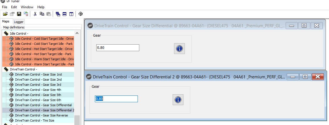

    Sorry if this was recently answered... I saw this on the OV Tune site under the VF Tuner packages. Does this mean that there are 2.0 VFT files available now somehow?
    Second question on making the changes for the gear size. I know that it's just as easy as putting in my new gear size into the Gear Size Differential fields. The weird thing is that for all the 04A61 files I have, they all show 0.80 for the gear sizes. What am I missing here?

    Update to latest version, this was fixed a while ago

    Thanks - I was literally installing the new version when you posted this. That cleared that up. Are 2.0 tune packs available for all ECU's now? We just need to send in a request?
