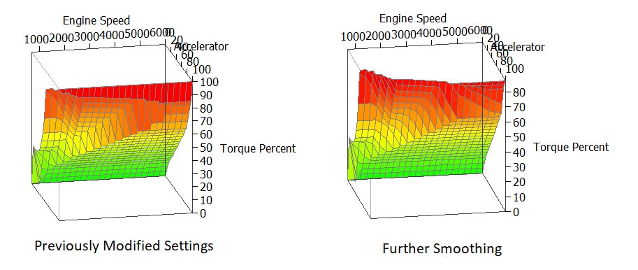

    Okay... so at least I got verification from Matt that the "04B14+2.0+Rev+Hang+Clutch+Hang.vft" test tune is a modified 2.0 04B14 SuperFOB tune with some "behind the scenes" changes to try and address at least a piece of Rev Hang.
    None of the tables involving the Rev Hang mods are available in vF Tuner (yet :wink:). From what I remember, the real change was only addressing Rev Hang with the clutch pedal depressed. I tried to modify my driving style to utilize this better, but was not all that successful - old dog/new tricks and all. Not sure why, but I've become partial to this tune and have been using it as a starting point for vF Tuner customization.
    I've mentioned before that I am interested in smoothing out the 2K-3K rpm transition, specifically in 4th gear. Now that I don't feel like I convinced my self that Stock was Awesome; I thought I'd give one more idea a go. Last night I looked to take some of the sharp edges off of the "Acceleration - Primary Throttle Torque Target" table. It was the only place where I could see big changes in the rpm range and at the accelerator angle I was concerned with. I only increased values to smooth things out. I'm not positive about the change yet, but results seem promising from my drive to work. Of course I washed the truck and vacuumed the carpet, so it automatically drives better.
    After a bit more driving, I'll let folks know if I can tell if it really made a difference. It's tough with lots of parameters changing (temperature, traffic, seating position - I think I'm a click back after vacuuming), but we will see what the old butt dyno says after a few days. Maybe after it settles in; I'll even roll back to before the change just before reporting. I'm not real patient like that though. Unfortunately, I'm more of a hacker than a scientific method guy.

  12. Oct 6, 2020 at 8:37 AM
    #92
    tonered
    tonered [OP] bartheloni
    Sep 25, 2017
    #231055
    31,330
    tony
    Lynnwood, WA
    Good luck!
    Those are some subtle changes. The crease still cramps my brain.
    Once I get the Air Load Control maps sorted, I am going to try editing this one again.

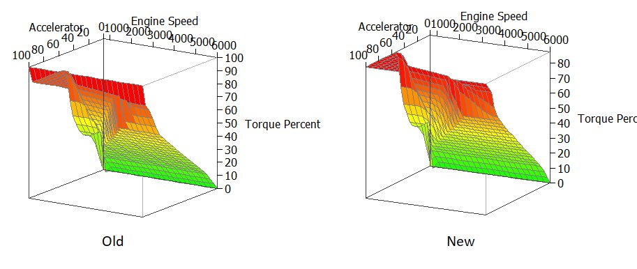

    The main change was to move the bottom of the steep slope up the rpm range so I didn't "fall off the cliff" in the middle of the range I was worried about. It's actually less subtle than the chart shows but its hard to find an angle that shows it well.

  14. Oct 6, 2020 at 8:50 AM
    #94
    tonered
    Sep 25, 2017
    #231055
    31,330
    tony
    Lynnwood, WA
    It is funny that Excel flips it, but:
    Karminski[QUOTED] likes this.

    #95
    Karminski
    Karminski Well-Known Member
    Sep 28, 2018
    #267676
    427
    Virginia
    2016 Tacoma D/C M/T TRD Off-Road
    That slope is crazy. Maybe after Matt's webinar we will know a little more about how it is being applied and it will make more sense. Then again, it's Toyota.
    vvv Here's my table if you care vvv
    tonered[QUOTED][OP] likes this.

    #96
    tonered
    Sep 25, 2017
    #231055
    31,330
    tony
    Lynnwood, WA
    Thanks for the map! I appreciate it. :cheers:
    Yes. It is wild. Discontinuities like that have to affect our driveability.
