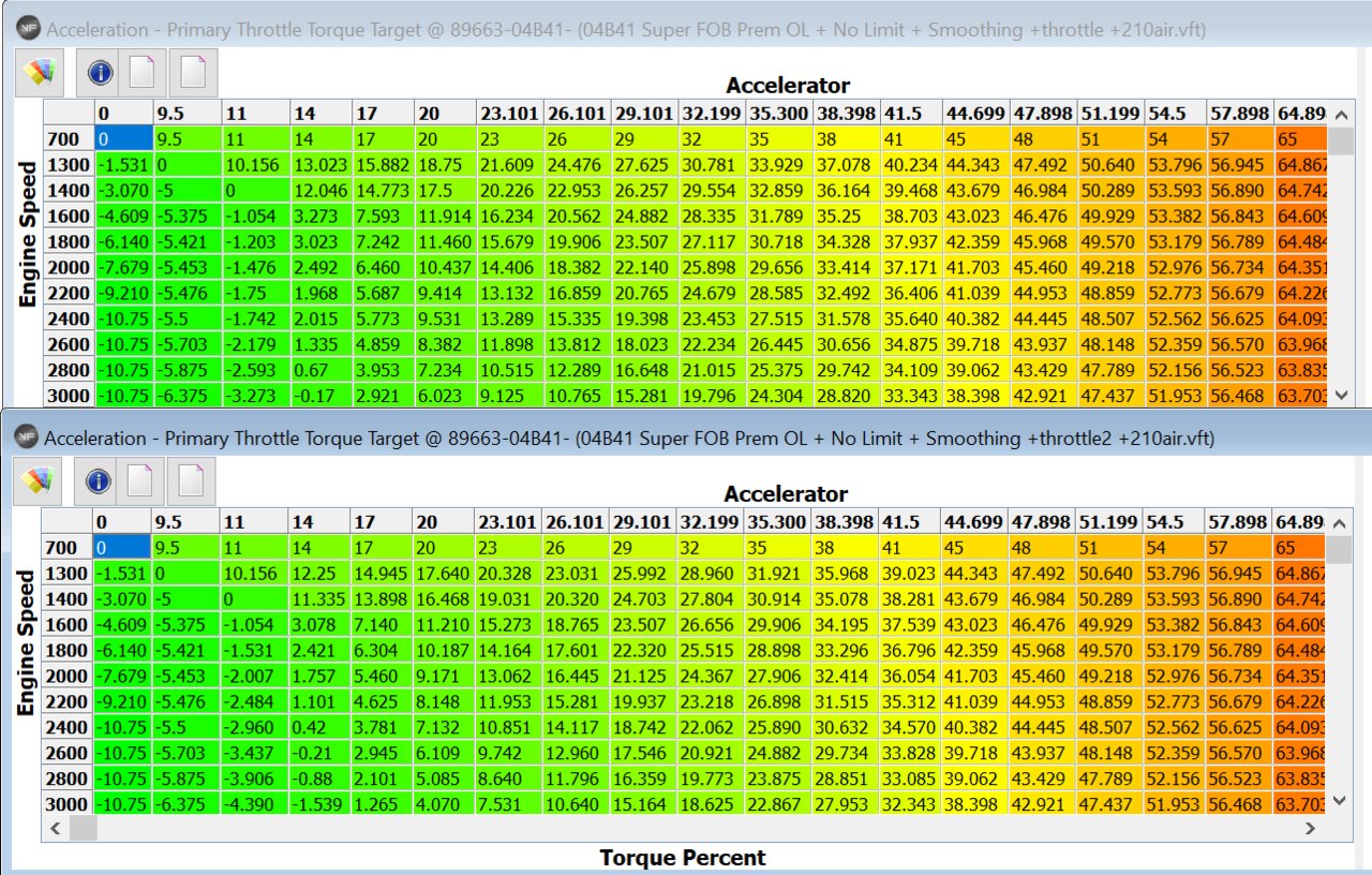

    Guys i wanted to show how a tiny edit makes a huge difference with the primary table.
    I have the file i have been running and i love it, its smooth, except first gear. First gear is downright touchy on the throttle.
    I tried many changes to tone it down and i realized that maybe im pushing the pedal down further than i think.
    Well, i was. I made a small edit to my primary and it made a huge difference, added a little numbing to the throttle, and a small step somewhere in the pedal range around 2500 rpm or so.
    Any way, here is an example picture of one map (the top) which is very touchy, and the other map (bottom) which is spongy.
    Im gonna split the difference and try to find a happy medium.
    Let me know how it feels. I went back to my other one as yours had a bit of a thud on and off throttle. Thought it was in my head, but verified when moving back to my other one and it went away.

    That was a small change. Just a couple percent in that area?
    I am looking forward to adding this in. But, I learned my lesson about one change at a time.
    That is really interesting about the On / Off issue. It was certainly the problem with the first edit for me. The second edit has been great. I hate to step away from it, but the @OVTune maps look so good, esp being the same.
    Once I get a couple drives in, I will see what the numerical differences are between them.

    it was a 7% change with some interpolation.
    i fixed the on/off issue with the factory values strategically placed within the first gear table and some interpolation to smooth it out. There is a HUGE difference between Matts first gear table and the Toyota first gear table. Once I found what I liked I started smoothing with the primary table, just to get rid of some aggressiveness it had too early in the throttle range.

    I am not seeing 7% deltas between your map sections above?

    you are right, its not 7%, its 7% as a base of the selection area, then interpolated. The interpolation was done in small sections to smooth it out. so the end result, random numbers
    EDIT: actually it was a multiplication on 93% to start (so not exactly a drop of 7%)
    then the above was true
