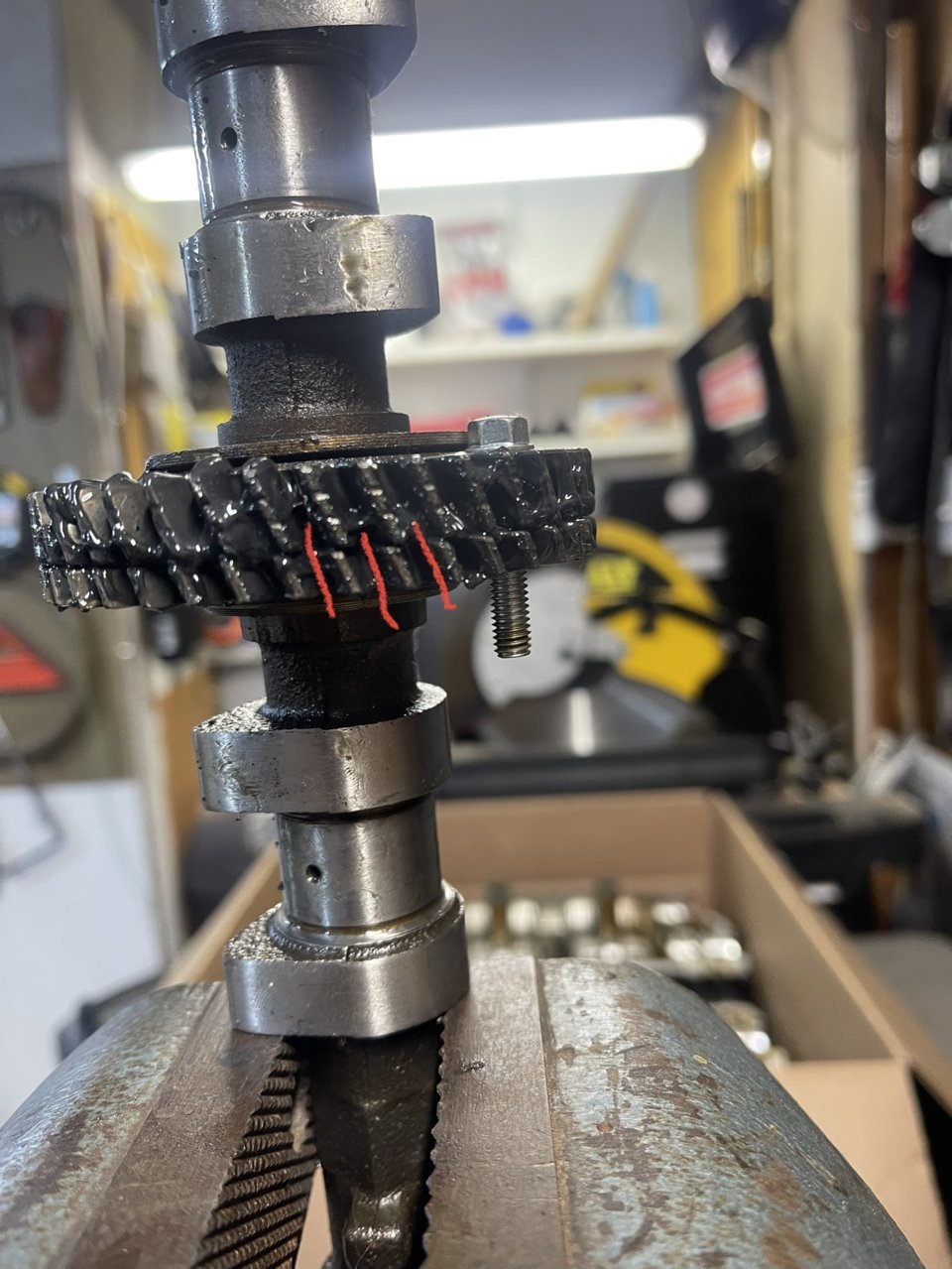

    Ok so by the grace of God I somehow lucked out and found a bolt that threads through both wheels perfectly.
    Now tell me if I’m saying this right…
    the intake cam wheel should thread in where the red lines are? The teeth don’t look lined up perfectly. Is that ok? Is that what’s suppose to happen once I remove the bolt? It’ll just spring back then creating constant tension both ways?

    Yeah so on the bolt-
    One trick is to use one of your valve cover bolts on each cam- that way if you forget to remove the bolt, you’ll figure it out when you are short a bolt at valve cover install.
    you need to take the other cam back out, tension spring, install bolt, reinstall cam.
    don’t overthink the gear teeth lining up when installing bolt- the bolt will only thread in when you have the tension set right. So pull gear back against spring, thread bolt in several turns, release tension against bolt/spring. Install cams, bolt down bearing blocks, remove service bolt. Same procedure for both sides of engine.

    Ya I think it’s all starting to click for me now. I just removed the driver exhaust cam. Vised it down. Turned the gear, threaded in the bolt, put back into the head, bolted the cam down and removed the bolt. Dots are lined up too. So I believe the driver side is all ready to go. Now just the passenger.

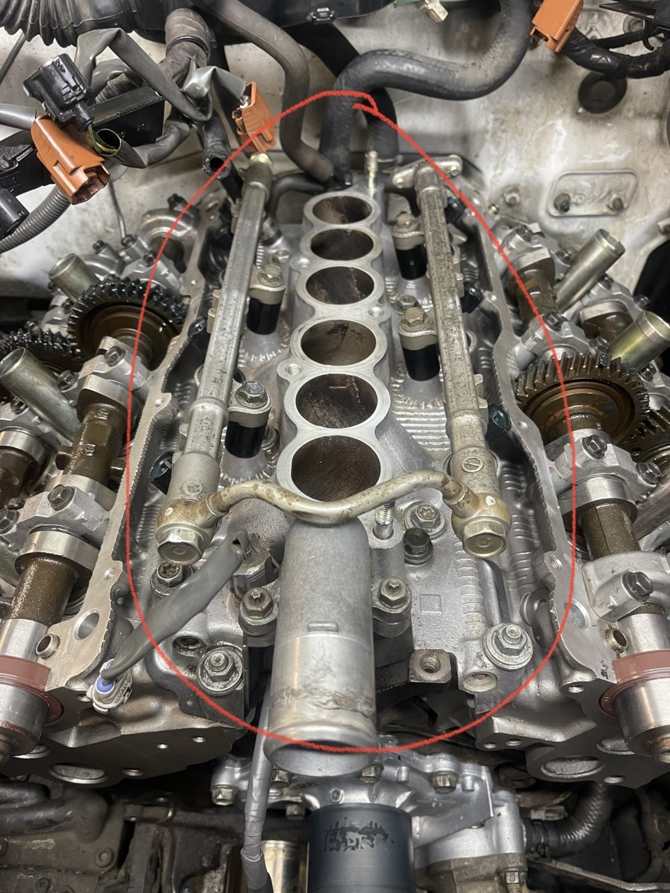

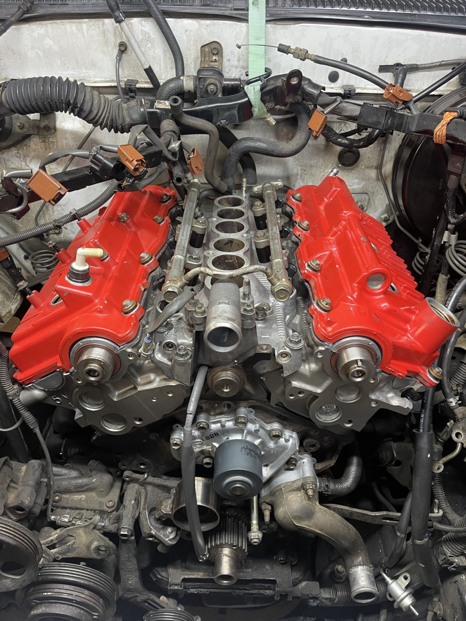

    Is this referred to as the intake manifold or the air intake chamber? I have a torque spec pdf chart and one is 22ft lbs and another says 15ft lbs.
  17. Dec 30, 2022 at 6:10 PM
    #37
    Logans2001
    Logans2001 [OP] What’s crackin’
    Jan 23, 2016
    #175792
    1,981
    San Diego, CA
    2001 v6 4WD auto

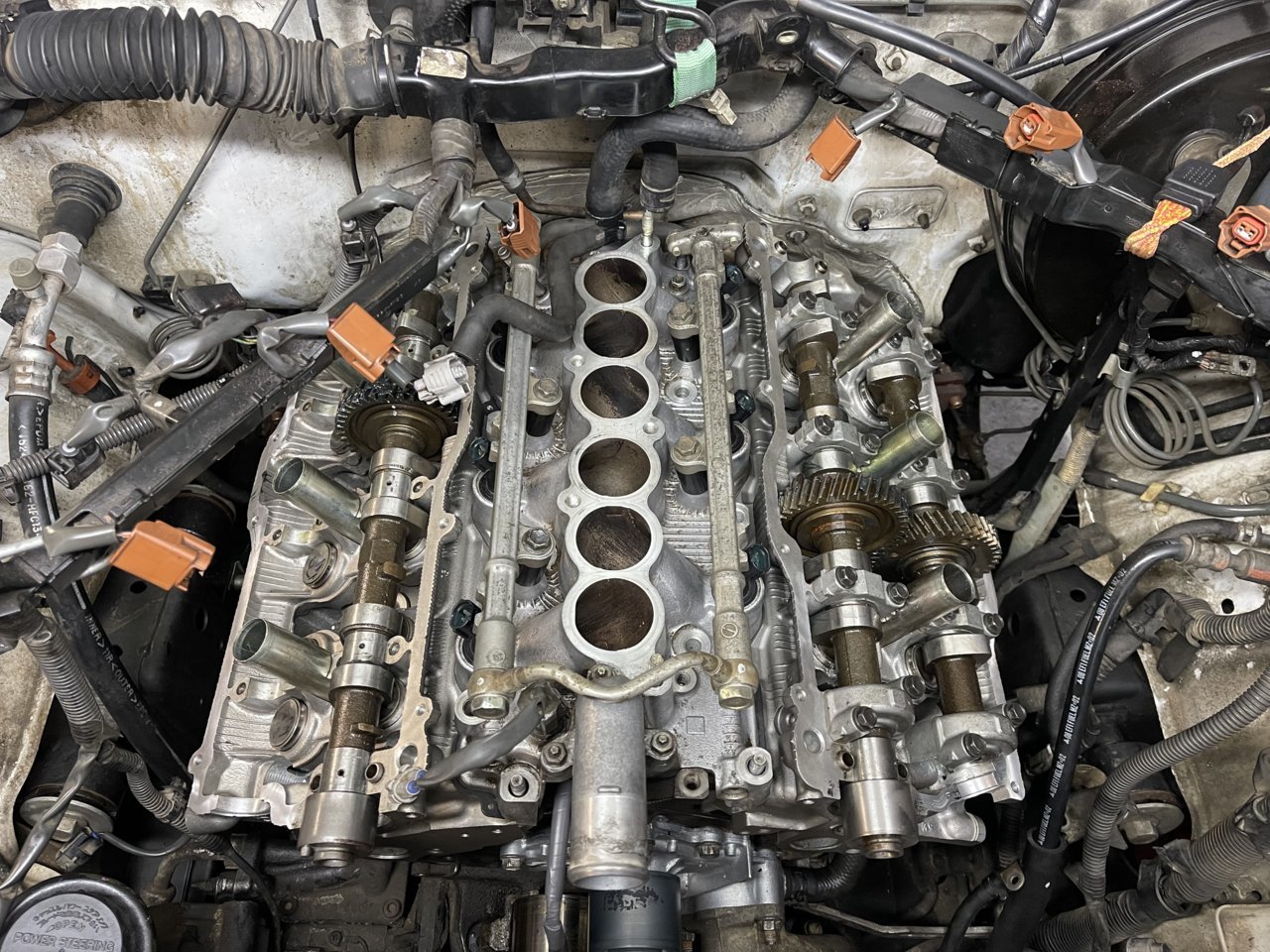

    Finally got the cams correct so now I can move on to the more simple reassembly. Thanks to everyone who chipped in with advice.
    She’s starting to look pretty good now :thumbsup:

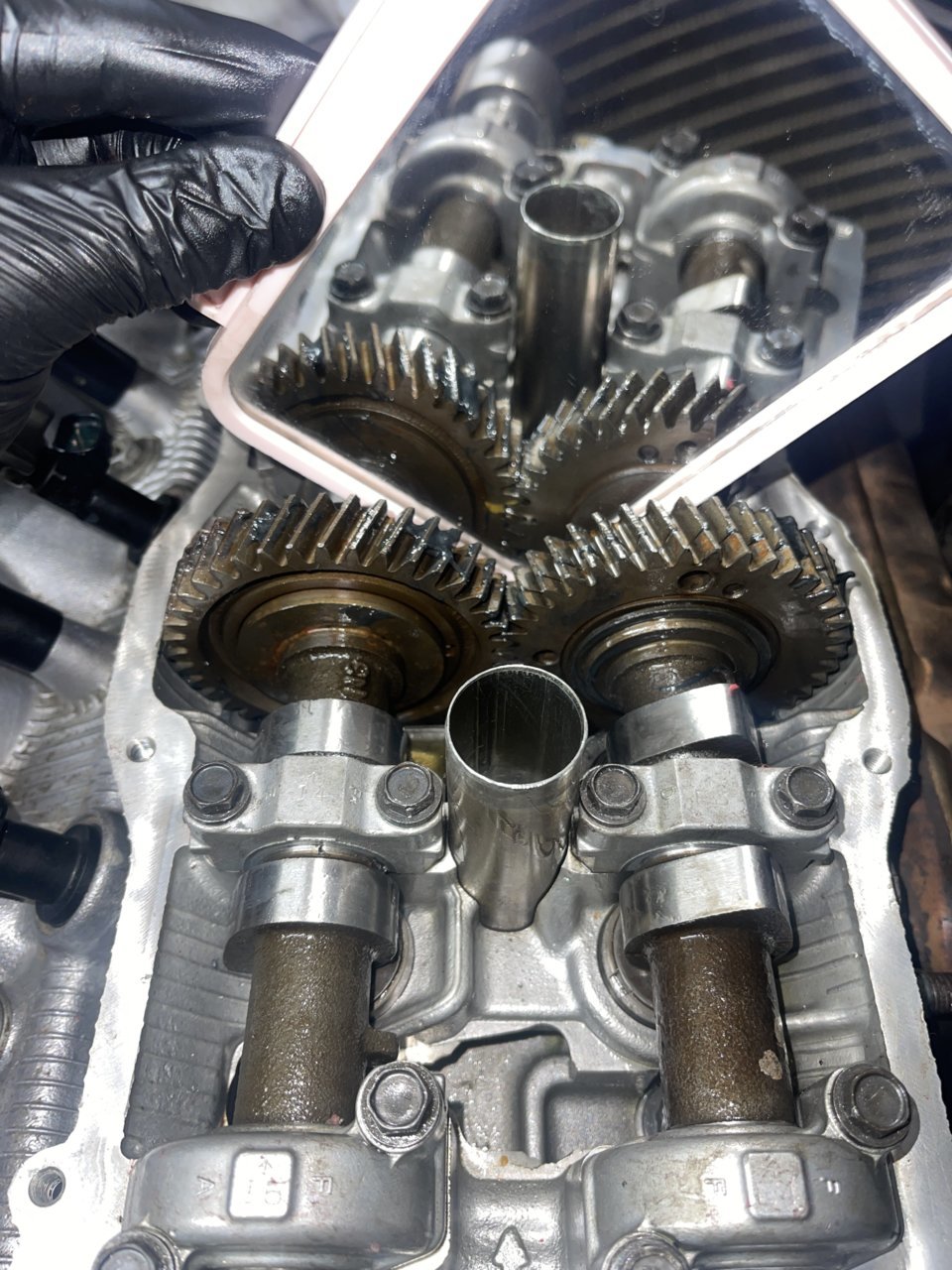

    Before valve covers
    Area51Runner likes this.
