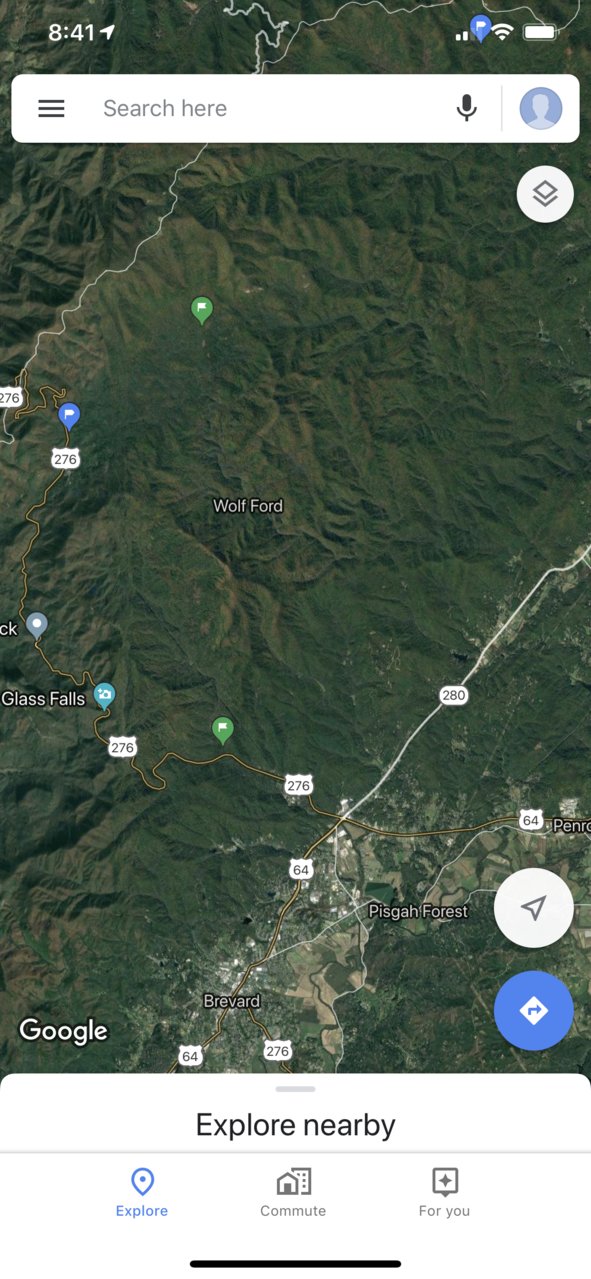

    Some dirt roads around Looking Glass Falls. Free camping, 1st come. Be careful with belongings if you leave at your campsite.
    Nothing technical..
    Dry falls and Bridal vail falls are near you also..
