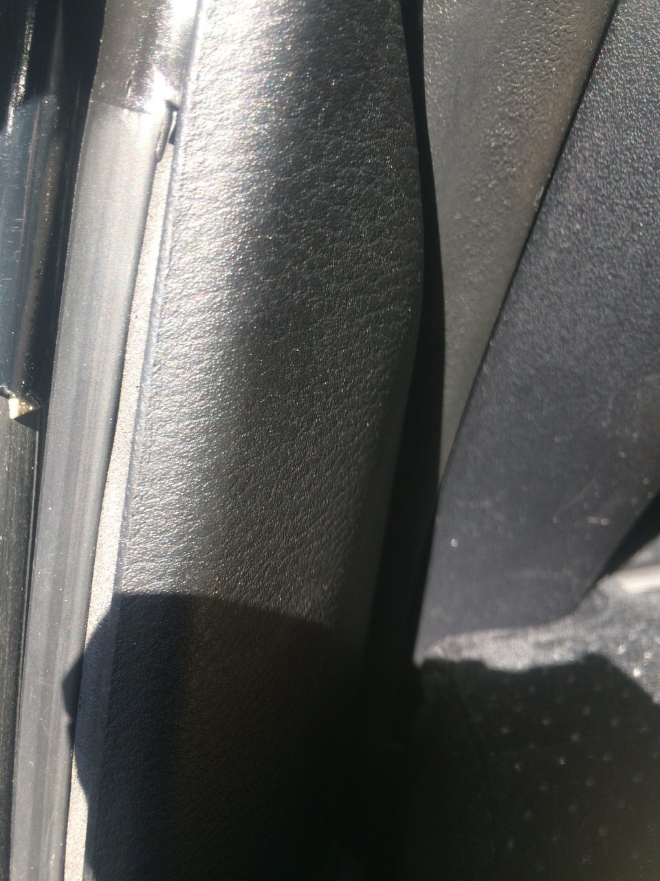

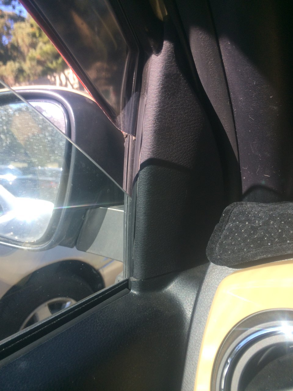

    First remove inside black cover to mirror. Roll down window. Peel back door rubber seal next to inside mirror cover. Place a couple of layers (I used two layers)of product below. Reattach rubber seal and inside mirror cover and your done. Five minutes.
    Pres-On P8225RL00.50XOH Neoprene Foam Tape with 3" Core, 1/16" x 1/2"...
    Sold by: Amazon.com
    $13.27

    So if I'm understanding you correctly, you're basically putting this stuff to press the door seal tighter onto the window so it doesn't rattle?

    Yes! You are correct.

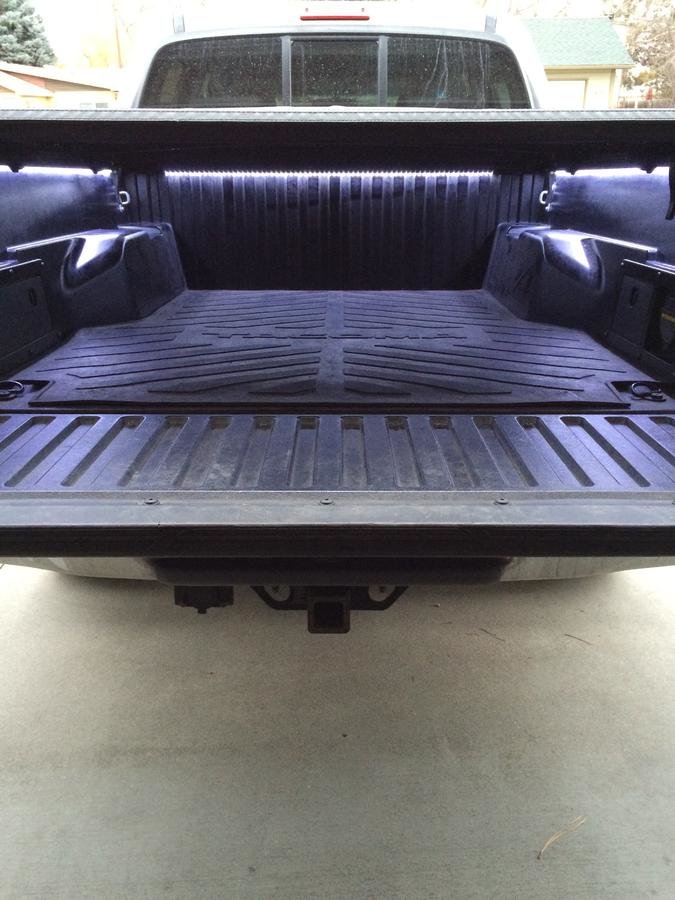

    Under rail bed lighting from @mattgecko
    Excellent, especially when working under a closed tonneau.

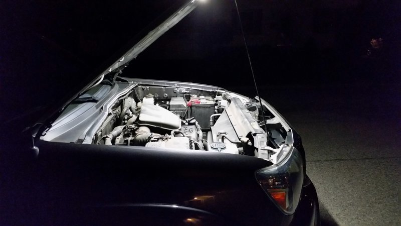

    The bed rail light kit was one of the first things I put on and I could not handle having my tonneau without it. The underhood lighting kit, however, is my most commented upon item. It really illuminates well.
