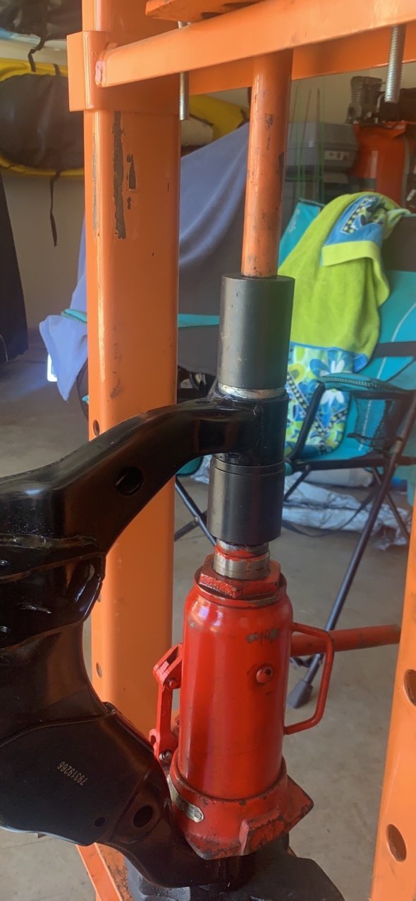

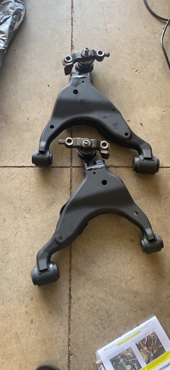

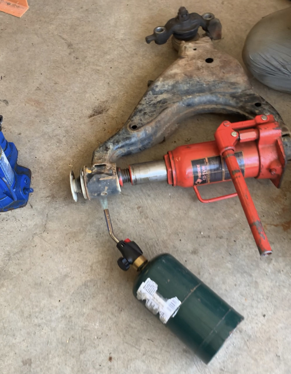

    Ok, so what are you looking at?
    Complete rebuild of upper and lower control arms with Energy Suspension Poly bushings and Proforged ball joints. When completed I will be all in with Proforged inner and outer tie rods, sway-bar drop links, sway-bar bushings and the BJ's.
    As to the Energy Suspension bushings: Big thanks to this post: https://www.tacomaworld.com/threads...r-control-arm-bushing-install-8-3128r.409268/
    The Energy Suspension change-out is not for the feint of heart. It is a true messy PITA with the burning out of the old, cleaning the hardware for re-use and install. I was looking for something longer lasting than stock and didn't need any of the 4-wheel/off road upgrades. Time will tell.

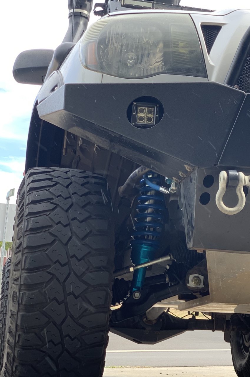

    Welds and Cuts and stuff

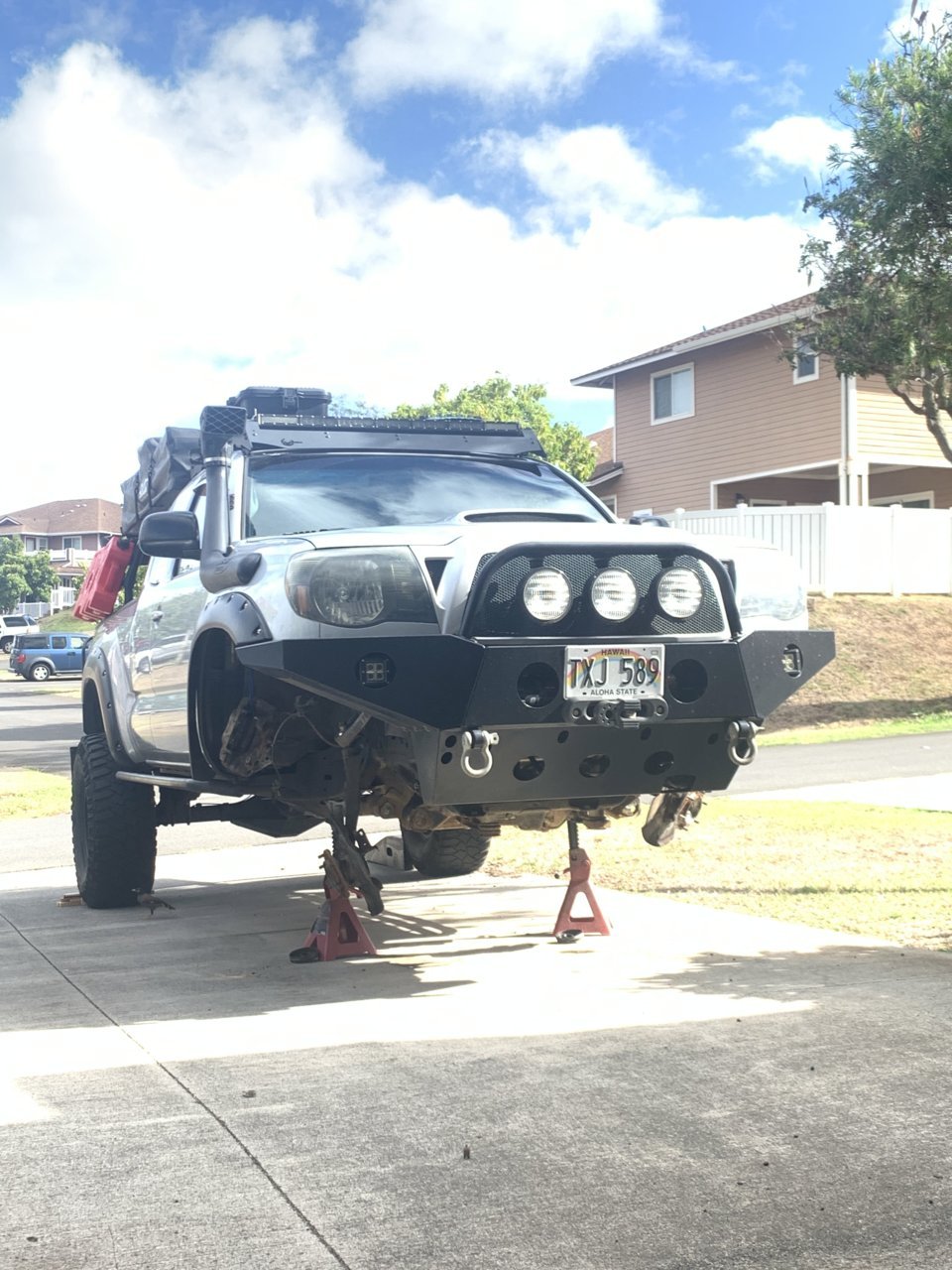

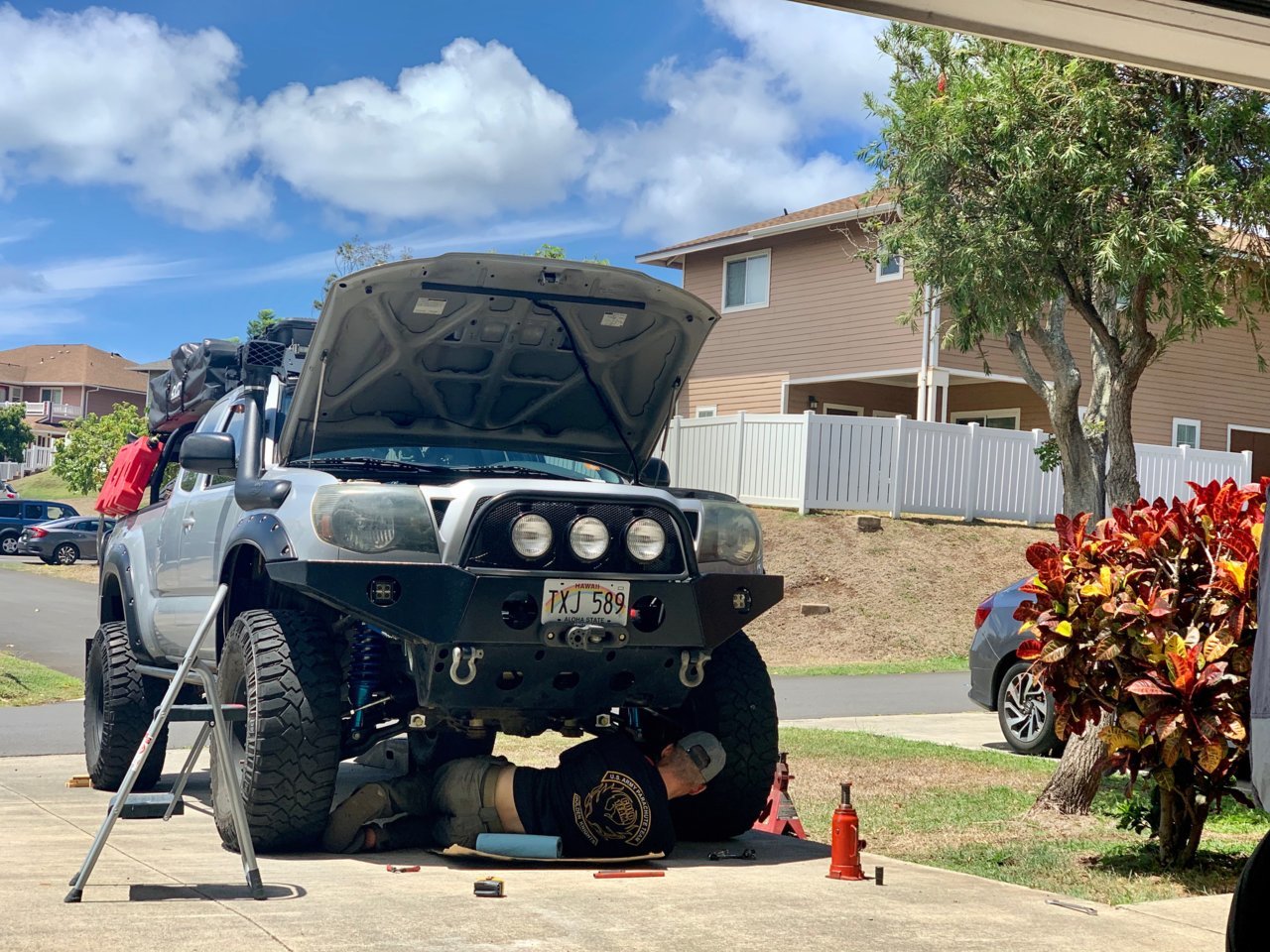

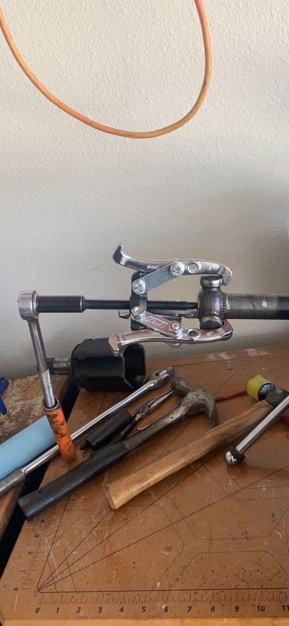

    Front end rebuild.
    LCAs: new ball joints, Whiteline bushings, Taco Tab cam delete. Used the Max caster and neutral camber tabs. Set toe with string method.
    CVs: New boots
    Steering rack: New Poly performance bushings, new inner and outer tie rods.
    New wheel bearings.
    King 2.5 ext travel coilovers with 600lb 14” springs from Accutune.
    various new hardware and seals.
    New Rotors.
    Was a busy, sometimes frustrating 4 days.
